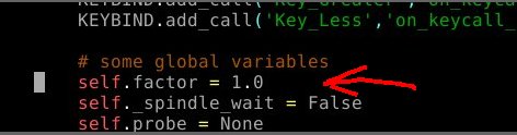

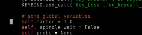

This is quite an old version of the file. Update linuxcnc , or try adding "self.factor = 1.0" as in the screenshot.

Not like that. Don't change anything in this line "rapid = (float(value) / 100) * self.factor"
If you have updated linuxcnc it is possible that it will work.
You should have checked if there is a line "self.factor = 1.0" in the global variables section, as in the screenshot
