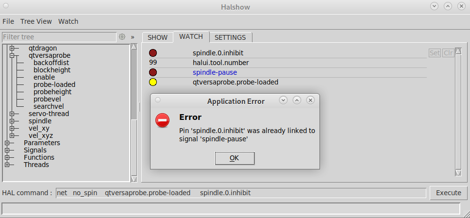

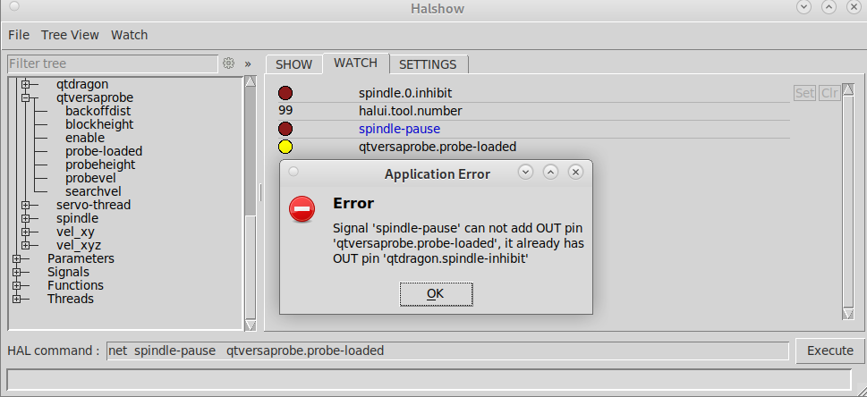

still not working.......fixing typos is good, but what about the logic ????
see both images.
also, If i add qtversaprobe.probe-loaded to a .hal file loaded through the .ini, qtdragon fails to start with './spin.hal:2: Pin 'qtversaprobe.probe-loaded' does not exist' error.
so, how, exactly, should this be coded in .hal ??? and how loaded ???

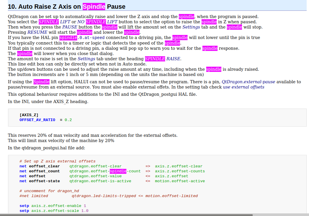

I know how to use hal. Been doing it for a long time. and I definitely RTFM. I do realize documentation is not much fun, but it's needed........and so is updating it.
ok, checking the current docs. found 'Auto Raise Z Axis on Spindle Pause'
it says there are buttons. not so.....OK just found it. not in setting like it ought to be. it's on the start/stop/etc.... page.

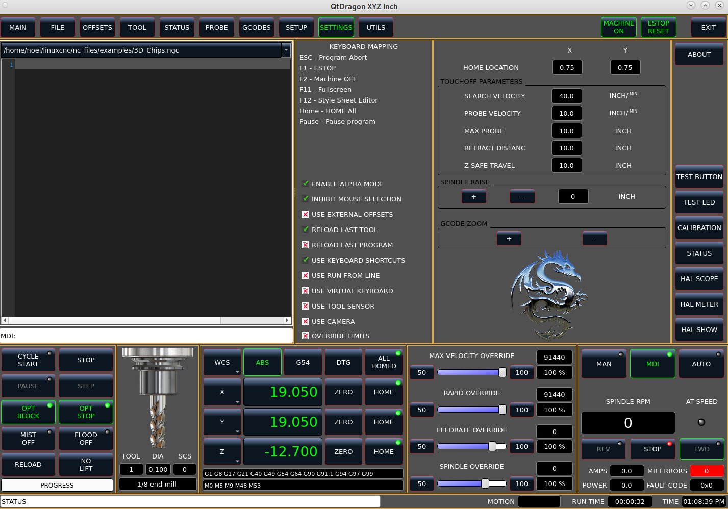

Show me a pic of your qtdragon screen.
- Roguish
- Posts: 297
- Thank you received: 31
21 Jul 2024 20:09 - 21 Jul 2024 21:02 #305812
by Roguish
Replied by Roguish on topic Spindle Inhibit while Probing.....
once again. thanks for the quick reply.
see attached image.

You can see in the picture there is a button that says 'no lift' eg spindle lift is turned off.
You can see in the pic the setting 'spindle raise' is set to 0 inches eg no spindle raise amount.
If you set these to 'spindle raise' and 1 inch respectably, run a program and then pause the program, you should see the program pause and the spindle stop and the spindle raise 1 inch.
This absolutely works in the sim configs.
This new feature - inhibit spindle when probe is loaded- is new so the sim has not integrated it.
Both features require controlling the spindle.0.inhibit pin. you can't normally have two driver pins connected to an input. If you use an OR2/logic component (or classicladder/custom component) you can.
You would need to connect qtdragon.spindle-inhibit to one OR input and qtversaprobe.probe-loaded to the other OR input and connect the OR output to spindle.0.inhibit
Now either event will inhibit the spindle.
