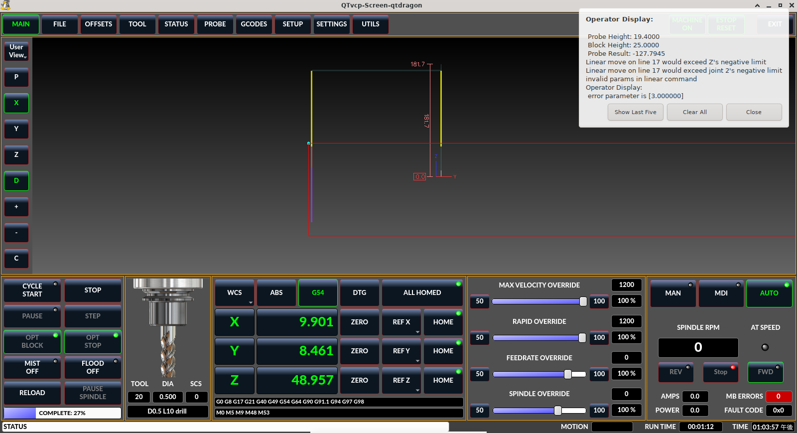

I am having trouble setting up manual tool changes and remaps in QTDragon.
I'm trying to migrate from Gmoccapy, but I just can't get it to work.
I am setting it up from scratch, but currently the replacement instruction window is displayed and the tool probe and workpiece are moved.
In this state, the Z-axis height above the pre-beam appears to be about twice the maximum height.
The message reads:
invalid params in linear command error parameter is [3.000000]
Linear move on line 17 would exceed Z's negative limit
I've been doing this all day today. It seemed to work once, but I can't reproduce it. I've set it up from scratch many times, but it's stuck in the same place.

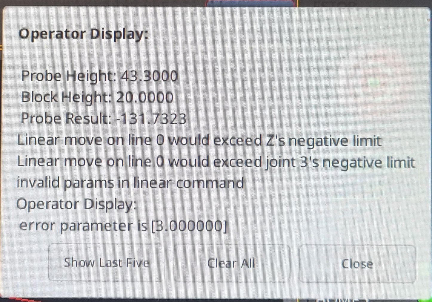

I notice this error after having changed a tool with M6 Tx. I attach my INI file and that of qtdragon_hd.pref. The entire change process makes it correct. The problem is that once it has measured the new height of the tool, the Z axis goes up and stops with that error.

23 Jul 2024 23:05 - 23 Jul 2024 23:06 #305942
by SanzuiWorks
Replied by SanzuiWorks on topic How to set manual tool change remapping in QTDRAGON. Z limit error
The error occurs after a tool change.
Cycle Start
Move to [Tool_change_position]
Replacement instructions
Go to [VERSA_TOOLSETTER] and measure the tool
Go to WORK
Z limit error
Linear move on line 17 would exceed joint 2's negative limit
Cannot switch pages while in AUTO mode
It looks like the z-axis is now jumping out of the machine area.

25 Jul 2024 05:50 - 25 Jul 2024 06:53 #306003
by SanzuiWorks
I still don't know the cause, but I think I'm getting a little closer to the answer.
What value does <zworkoffset> represent?
qt_auto_probe_tool.ngc
When calculating using <touch_result>, the results will be more accurate if you omit <zworkoffset>.
In other words, when G92/G52 = 0 and G54, the value of <zworkoffset> is "0", right?
<zeorkoffset> value is around "110", so I think that's the cause.
I don't know if the "ini" settings are wrong or what the cause is. Do you know anything?

25 Jul 2024 06:14 #306005
Typing this command in MDI should show the current value of parameter 5063:
linuxcnc.org/docs/html/gcode/overview.ht...:numbered-parameters
Replied by Aciera on topic How to set manual tool change remapping in QTDRAGON. Z limit error
That is correct.In other words, when G92/G52 = 0 and G54, the value of <zworkoffset> is "0", right?
this would indicate that #5063 (which should hold the Z coordinate value at the time the probe tripped) has the value 'around 110'.The value is around "110", so I think that's the cause.
(DEBUG, value = #5063)linuxcnc.org/docs/html/gcode/overview.ht...:numbered-parameters

25 Jul 2024 06:34 - 25 Jul 2024 06:45 #306008
by SanzuiWorks
I wrote it poorly.
The value of “110” is indicated by <zworkoffset>.
This value is -120.
When I changed it to this it worked fine.
I don't know what the results would be if there was an offset.
(DEBUG, value = #5063)#<touch_result> = #5063When I changed it to this it worked fine.

25 Jul 2024 08:19 - 25 Jul 2024 08:22 #306012
by SanzuiWorks
Resets the Z value of the active coordinate system.
Before getting #<zworkoffset>, you must reset the Z value of the active coordinate system.
;Resets the Z value of the active coordinate system
G10 L2 P#5220 Z0
#<zworkoffset> = [#[5203 + #5220 * 20] + #5213 * #5210]
