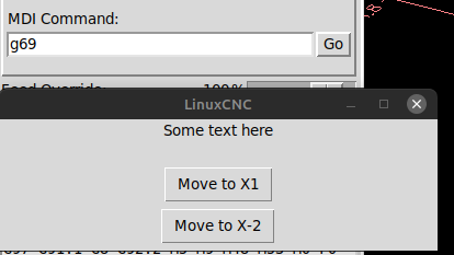

So here is an example using a python remap.
To setup python remap in your config you will need to:
1. In your config folder create a folder named 'python'
2. save this to the 'python' folder as 'toplevel.py':3. save this to the 'python' folder as 'remap.py'
4. save this as 'g69remap.ngc' to a folder listed in your ini file under [RS274NGC] SUBROUTINE_PATH
5. Add this to your ini file (if not already included)
6. Add this to the [RS274NGC] section of your ini file
This should give you a new GCode 'G69' which should then open a popup window and give you two options to move:
Upon pressing a button the machine will move to the selected position and the program will continue.

REMAP = M469 modalgroup=10 python3=g69_coreThis should give you a new GCode 'G69' which should then open a popup window and give you two options to move:

19 Aug 2024 16:25 #308168
by chernogorsky
Replied by chernogorsky on topic [QTDragon] blocking in hal_manualtoolchange dialog
Thank you
Have done initial setup with Qt (still need more work on bells and whistels)
and it looks like working
File attached +
one change in qt_auto_probe_tool.ngc (right before M6)
And it works close to how I want it for now
Current TODO - check if I can do the window it modal and top of all for all the time, but its minor
