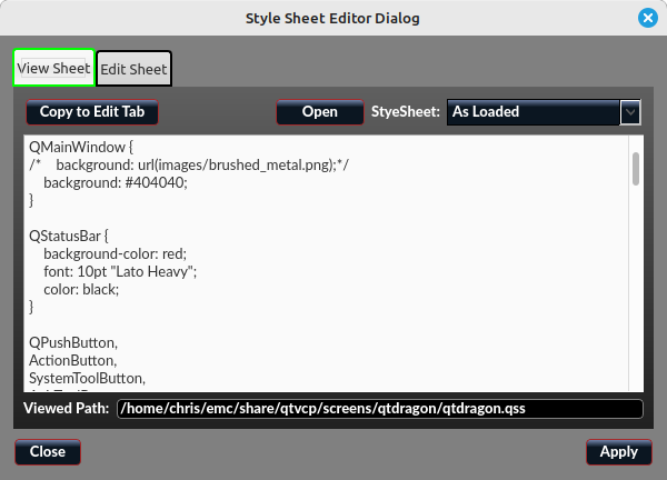

Replied by cmorley on topic QTDragon HD spindle incrementally increase/decrease speed
from the docs:
linuxcnc.org/docs/devel/html/gui/qtdragon.html#_stylesheets
press F12 an editor will show for the style sheet:
press the 'copy to edit tab' and then edit as you please.
apply to test.
Then save for next time. The view tab should show the path/filename of the stylesheet that qtdragon will use.
apply to test.
