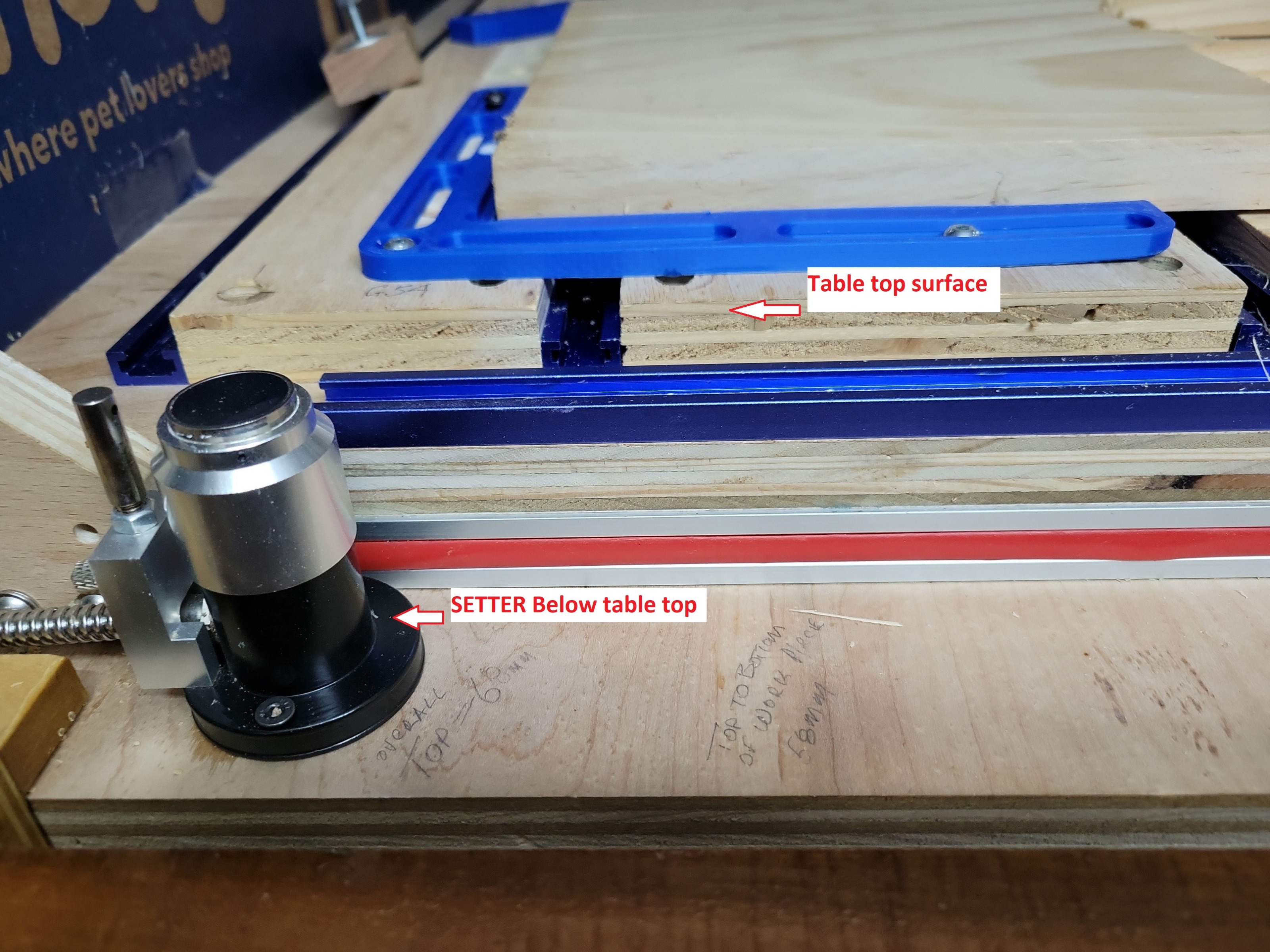

I need to look at my GS20 VFD docs. I believe there was a parameter that I may have set to prevent to only allow the Spindle to run between 5k and 24k. So we can probably not waste unnecessary cycles on the spindle not stopping.
What I am concerned about is the tool length measurement. I am attaching an image which shows my rig.
Note that the setter BASE is BELOW the table top but, the setter TOP is ABOVE the table top by some 10mm.
In the QTDragon setup I have entered 10 for the height which I believe is correct?
How do I setup so that tool measurements are consistent?
