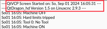

Hi all,
Is the description of QtDragon HD at linuxcnc.org/docs/devel/html/de/gui/qtdragon.html actually up to date? For example, when I compare the settings of the post-GUI-hal file with the same file from github, there are a few different designations and pin names. When starting QtDragon-hd, for example, I get an error message when loading the line “net eoffset-state qtdragon.eoffset-is-active <= motion.eoffset-active”. The message in this case is: “qtdragon_hd_postgui.hal:91: Pin ‘qtdragon.eoffset-is-active’ does not exist”. If I comment out this line, QtDragon starts. However, I don't know if everything is loaded correctly and completely.
Can anyone help me with this?

Replied by cmorley on topic Which settings are currently valid?
Are you comparing master to 2.9?
The docs you quoted are for master.

Replied by CADdy on topic Which settings are currently valid?
Hi Chris,
I don't know. It is an installation with the ISO from linuxcnc.org. LinuxCNC was version 2.9.2 and was upgraded to 2.9.3 during an update. I'll have to look up QtDragon-HD. Is there any indication of which version of QtDragon-HD is installed?
Peter

Replied by Aciera on topic Which settings are currently valid?
for 2.9.x you want these docs:
linuxcnc.org/docs/stable/html/de/gui/qtdragon.html
Hi David,
Thanks for the info. I'll take a look right away and compare it with my configuration.
