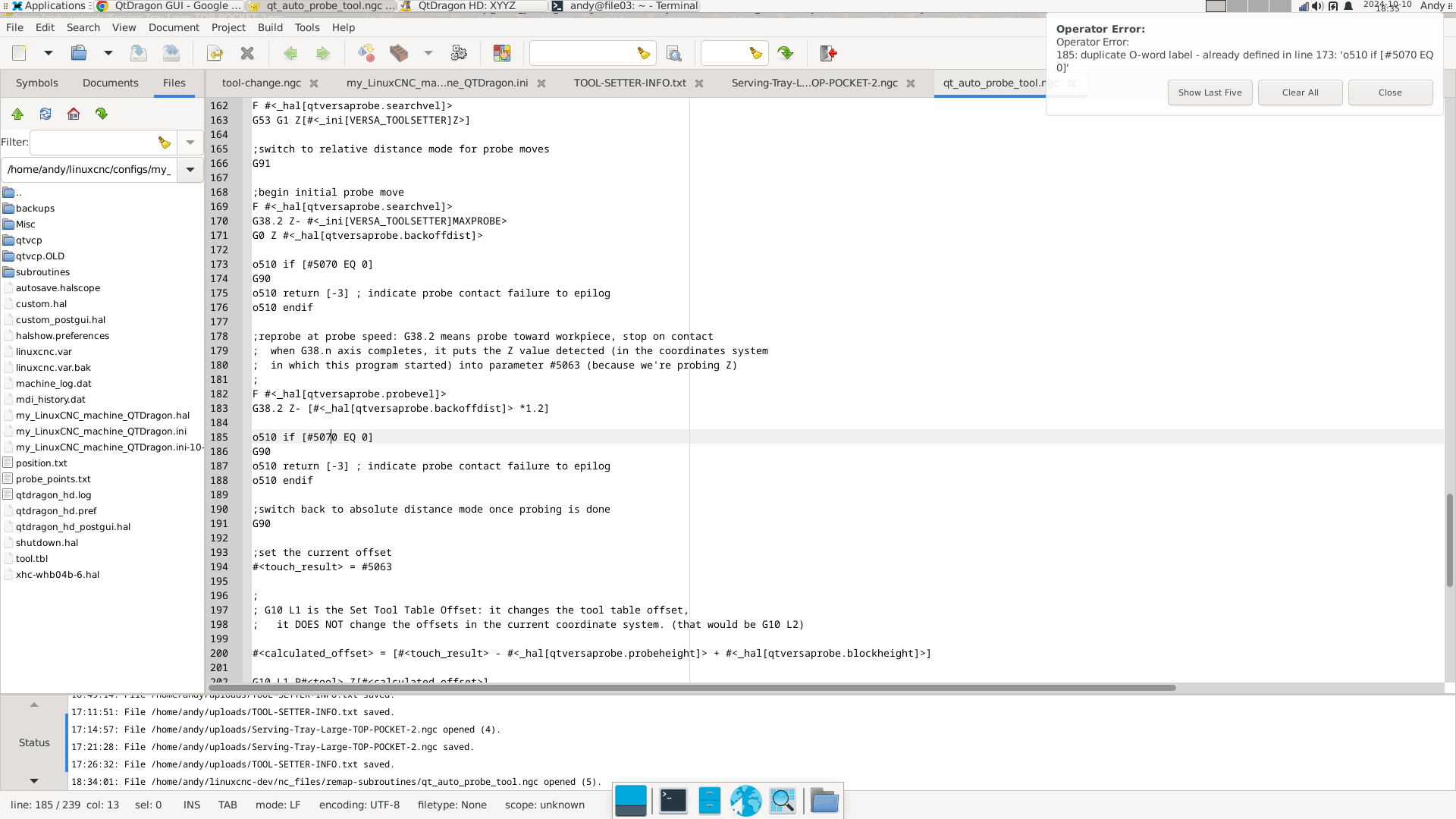

Probe Duplicate oWord?
- gardenweazel
- Posts: 197
- Thank you received: 10
10 Oct 2024 18:39 #311787
by gardenweazel
Probe Duplicate oWord? was created by gardenweazel
- Posts: 7368
- Thank you received: 2181
10 Oct 2024 22:20 #311789
Replied by cmorley on topic Probe Duplicate oWord?
line 173 and 185 both define o510
You need to change one to another number.
