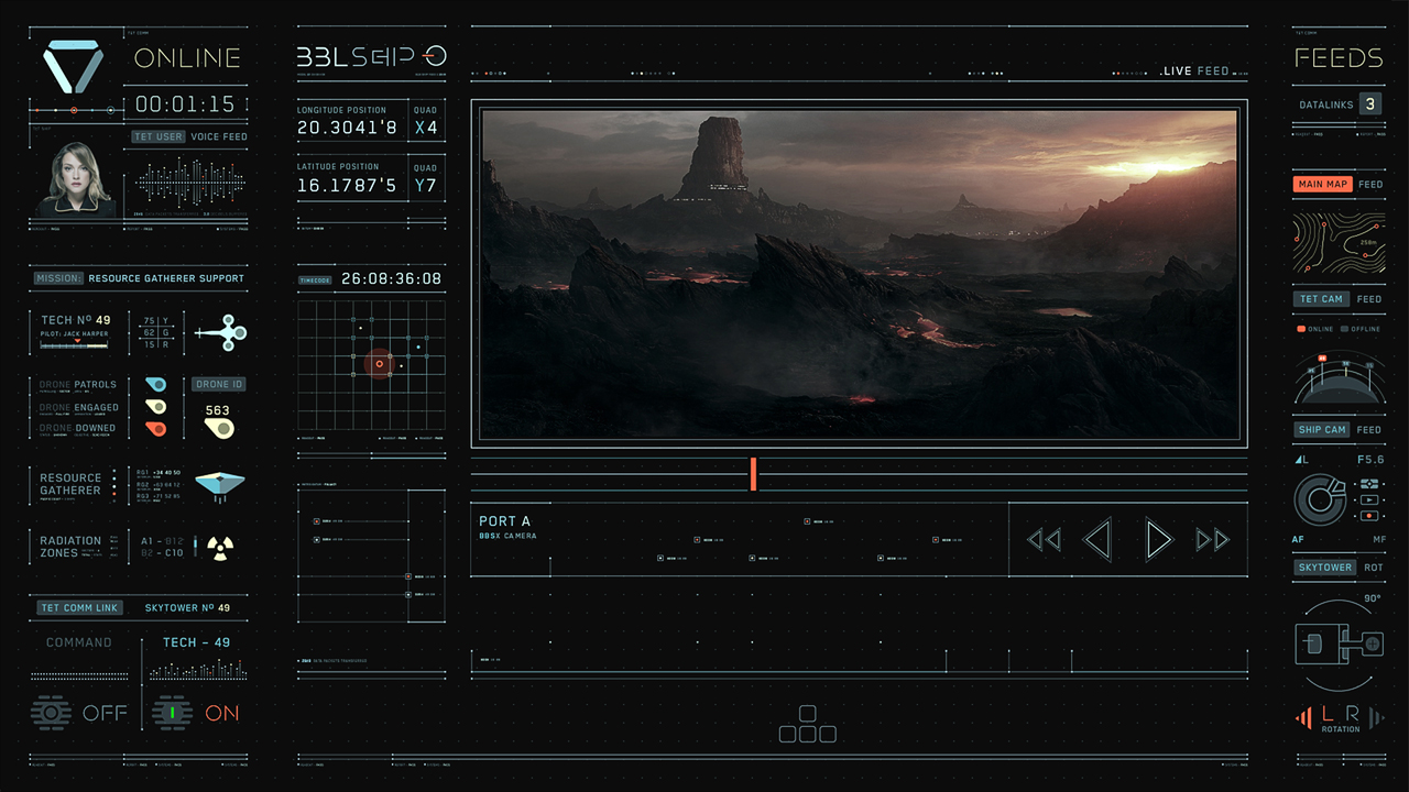

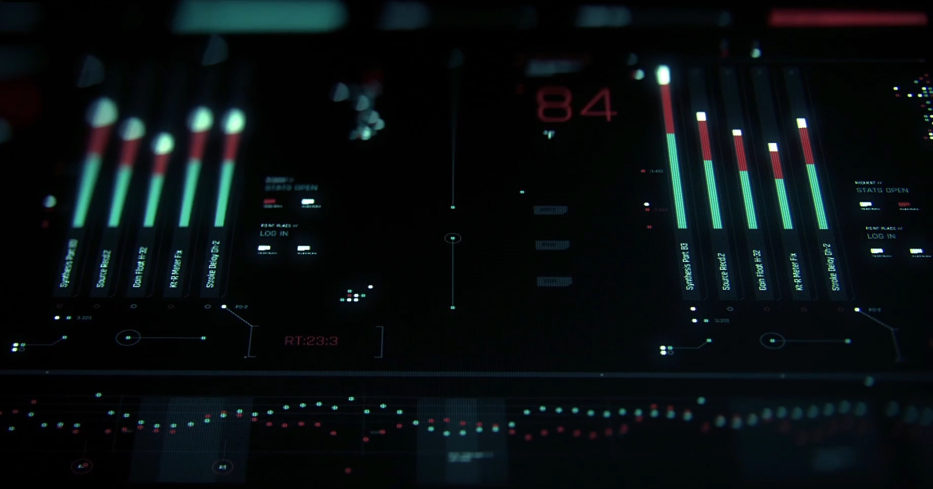

I want to make the design like the attached UIs, graphics can be done in qt directly or .qss is a must?
if so, can u add animations to .qss which can be played one time during launch of the ui for example?
the files u shared should come with qtvcp install and your information should be in the qtvcp documentation, thanks again.
I can dive in to UI designing now, qtvcp is written in a way that u design the general layout in qt and finish the design by styling it with .qss file right?
