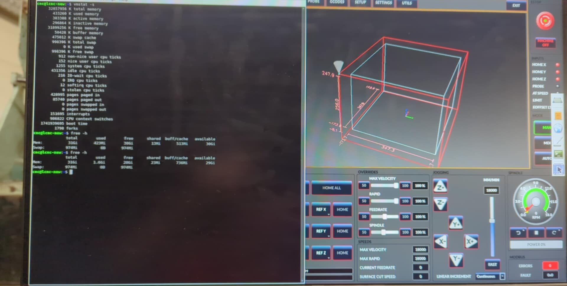

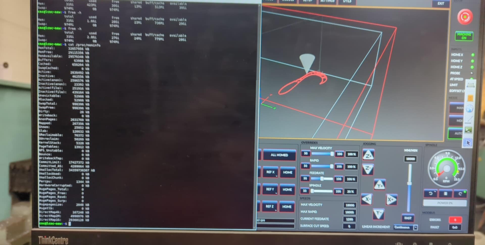

22 Mar 2025 15:24 - 22 Mar 2025 15:55 #324557
by looping
Replied by looping on topic QTDragon_hd won't display a larger file.
I have something similar but my file is not even big : 80k. (attached)
The bottom indicator says "LOADING 100%"
My display freeze, but the mouse cursor still move. VerNum on my keyboard is unresponsive. But I can connect with ssh.
dmesg is full of:
dmesg is full of:
[ 288.508935] nouveau 0000:01:00.0: DRM: skipped size 0000000000000000
[ 288.509728] nouveau 0000:01:00.0: DRM: skipped size 0000000000000000
[ 288.510420] nouveau 0000:01:00.0: DRM: skipped size 0000000000000000
[ 288.515551] nouveau 0000:01:00.0: DRM: skipped size 0000000000000000
[ 288.516120] nouveau 0000:01:00.0: DRM: skipped size 0000000000000000
[ 288.517095] nouveau 0000:01:00.0: DRM: skipped size 0000000000000000
[ 288.517650] nouveau 0000:01:00.0: DRM: skipped size 0000000000000000
[ 288.518745] nouveau 0000:01:00.0: DRM: skipped size 0000000000000000
[ 288.523254] nouveau 0000:01:00.0: DRM: skipped size 0000000000000000
Last edit: 22 Mar 2025 15:55 by looping.

22 Mar 2025 16:07 #324559
by looping
The complete dmesg is more interresting as there a mention about qtvcp
[ 160.876803] nouveau 0000:01:00.0: DRM: skipped size 0000000000000000
[ 160.877509] nouveau 0000:01:00.0: DRM: skipped size 0000000000000000
[ 213.991546] nouveau 0000:01:00.0: gr: intr 00100000 [ERROR] nsource 00010000 [DMA_VTX_PROTECTION] nstatus 04000000 [PROTECTION_FAULT] ch 4 [00109000 qtvcp[1515]] subc 7 class 4097 mthd 1824 data 16002556
[ 213.991571] nouveau 0000:01:00.0: gr: intr 00100000 [ERROR] nsource 00010000 [DMA_VTX_PROTECTION] nstatus 04000000 [PROTECTION_FAULT] ch 4 [00109000 qtvcp[1515]] subc 7 class 4097 mthd 1f08 data 38ff8189

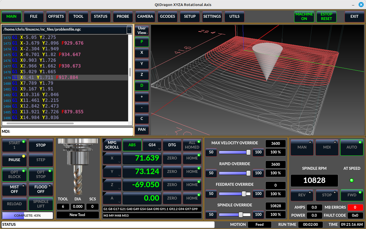

22 Mar 2025 18:07 #324575
by looping
I'm not really surprised that this isn't related to my file, as I created it the same way I always do. I finally got it to load, but I'm not sure how. I tried kernels 6.1.0-28 and 6.1.0-32. I also tried 2.9.4-19-gd3a1da65b7, same result as with 2.10.0-pre0.
Now I have the same issue with the next file.
I will try on another hardware
