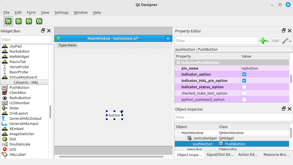

indicatorPushButton led does not seem to have an option to connect the led to a hal pin.
Is it possible to add an option to connect the led to a hal pin. Or even better to modify the regular halPushButton to have built in led that connects to a hal pin similar to indicatorPushButton

Chris thank you very much for the quick response. Indeed hal pushbutton has built in led (I missed that part my appologies)
Now, where do I entre the name of the led to be able to turn on/off the led with a hal pin

The led name will be the button name with '-led' on the end.
in the above example the pin name would be 'SCREENNAME.mybutton-led'

Chris it worked ,thank you for your guidance.
For those learning to use qtvcp with hal, here is "Hello World" example that turns on/off the embedded led in hal PushButton widget.
Start Qt Designer:
For a RIP install:
Open a terminal and source the environment:
$ source /home/YourPath/scripts/rip-environment
$ designer -qt=5
For a package install:
Open a terminal and type:
$ designer -qt=5
Create MainWindow Widget
Select MainWindow
Add the ScreenOptions Widget
Drag and drop the ScreenOptions widget anywhere onto the MainWwindow widget
Add hal PushButton
Drag and drop hal PushButton widget anywhere onto the MainWwindow widget
Save The .ui File
Save the file as test.ui in a folder
Create a .hal file
Open text editor and copy hal netlisting (see below), save the file as test.hal
(make sure you save .hal file .ui file in the same folder)
At command prompt:
$ halrun -I -f test.hal
Copy following into text file and save as test.hal
# load realtime components
# load non-realtime programs
loadusr -Wn test qtvcp test.ui
# add components to thread
# connect pins
net connect test.mybutton test.mybutton-led
