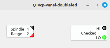

Request for adding second led to existing hal push button

Replied by cmorley on topic Request for adding second led to existing hal push button
Not easily at the moment.
That particular button uses multiple images for each LED state, Qtvcp draws LEDs on top of the standard button drawing, adding another could easily be added to the code.
Qtvcp could use either technique.
What would control the LEDs? HAL pins ? Toggle state?

11 Jun 2025 15:22 - 11 Jun 2025 15:23 #330173
by Benb
Replied by Benb on topic Request for adding second led to existing hal push button
Hi Chris,
I will use hal pins to control LEDS status. no toggle.
This push button will probably be popular with qtvcp users since it will mimic certain pathpilot buttons. It will also reduce the amount of real state on screens. I can see it used for pause/resume, jog inc/cont ...

12 Jun 2025 19:58 #330239
by Benb
Looks good and great addition to qtvcp.
And thank you for all your efforts for creating and maintaining qtvcp.
