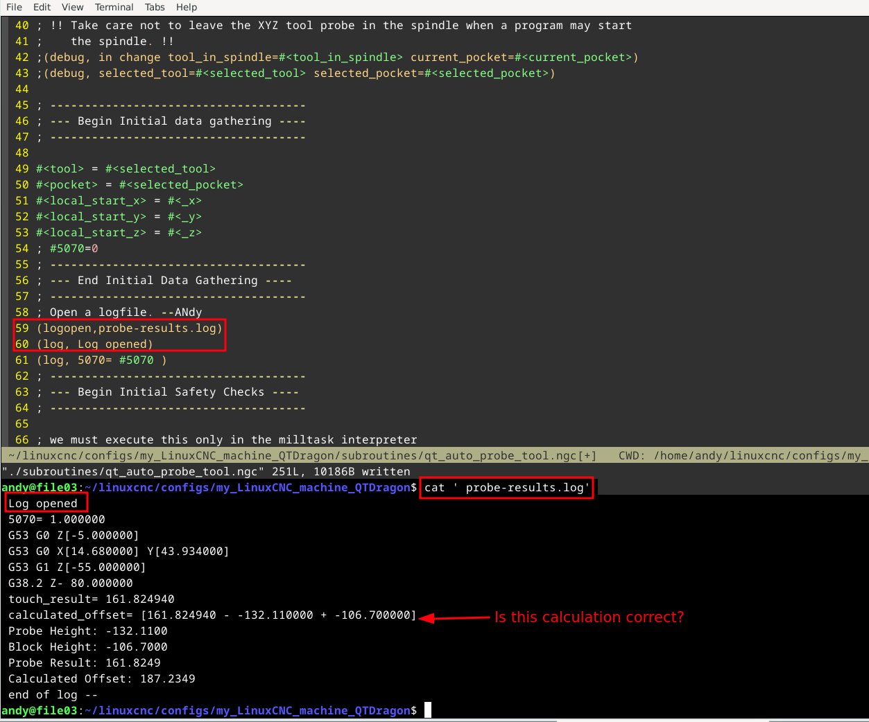

I have after many, many tries still cannot get the versaProbe actions to work properly. So I added some logging.
Please refer to this image inline.
1 issue and another oddity.
1st issue, note the lines that I have added to the qt_auto_probe_tool.ngc file in order to log and hopefully put an end to the first probe try failing.
The question, why is there a space that's being added to the filename when it's written to file?
The second is similar to a thread that I started many moons ago and still exists. In the image I point out what is actually logged in the file. It begins with this code in the aforementioned file:
touch_result= 161.824940
calculated_offset= [161.824940 - -132.110000 + -106.700000]
Probe Height: -132.1100
Block Height: -106.7000
Probe Result: 161.8249
Calculated Offset: 187.2349
I don't understand the calculated_offset line which includes a double negative.
Now then, in this same file I see the following reference prior to code being executed and for some reason it's almost as if these instructions are either out of order or are incorrect. Preceding numbers are actual line numbers.

And last I would like to know (if the above instructions are correct) what are "sane" values that belong in the my_machine.ini file?
Mine are as follows:
Max Z travel for Z-Axis is: -190
[VERSA_PROBE_OPTIONS]
ps_probe_tool = 99
[VERSA_TOOLSETTER]
X = 14.68
Y = 43.934
Z = -55
# Safe Z-Height, in Absolute coordinates.
Z_MAX_CLEAR = -5
# MAXPROBE must be positive!!
MAXPROBE = 80
# tool setter diameter for diameter probing
DIAMETER = 22
[CHANGE_POSITION]
X = 200
Y = 20
Z = -5
Note that MAXPROBE in the LinuxCNC online documents still indicates a negative value of -20.
Thanks in advance for your feedback.

Thanks for your feedback. I'm not so worried about the first issue above as much as the second issue that I describe above.
The second problem has persisted for a long time and many have tried their luck at resolving it. I continue to see problems being discussed
that may be probable causes for this subroutine.
Honestly, I think that the documentation around what I have described is perhaps incorrect or simply doesn't provide enough information
for the operator to make the subroutine work as expected. A good example of this is line number 31, the instructions indicate the following:
31; 4 - Workpiece Measure: Use the button under the Probe Screens for "Probe Z height
32 ; of material:" this will set and display on the Probe Settings screen the
33 ; "Block Ht" = #<_hal[qtversaprobe.blockheight]> value in ABS coordinates.
What is missing is is there should be a "Jog to a coordinate" in order to measure the work piece height which will determine the "Block Ht" .
I am curious if there are any other steps involved that are not documented?
