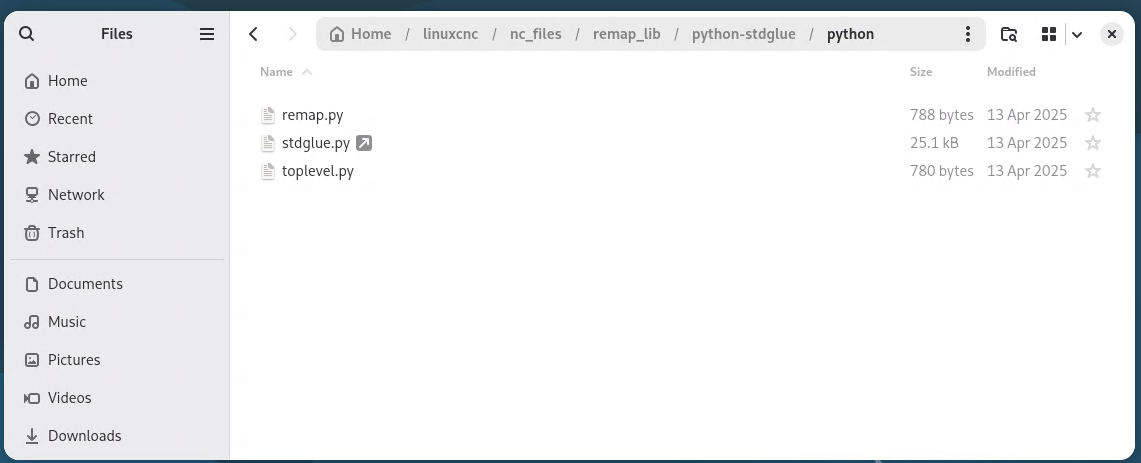

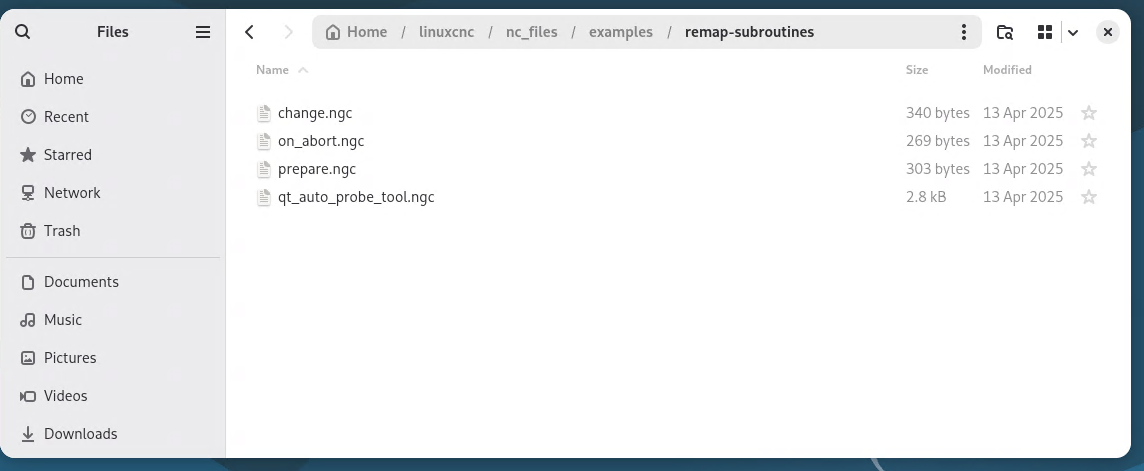

is there this folder?
~/linuxcnc/nc_files/examples/remap_lib/python-stdglue/python
does that folder have these files?
remap.py
toplevel.py
is this link valid in that folder?
stdglue.py
is there this path?
~/linuxcnc/nc_files/examples/remap-subroutines/qt_auto_probe_tool.ngc
remap.py
toplevel.py
stdglue.py
is there this path?

All correct, see attached screenshots

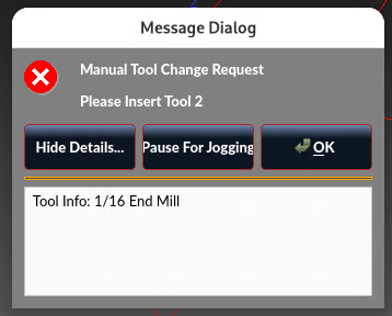

Made a solid jump in progress. The issue was the qt_dragon would appear to "freeze" thus looking at the terminal led me down this rabbit hole. The problem was the Message Dialog was not popping up (or maybe it was because you need to acknowelge it to do anything). Either way I am starting to think the "not callable" is normal?
After checking my .hal file and my postgui.hal file the problem was this wasy in my postgui.hal file, I was missing this in my postgui.hal file and I comment out all the unlinkp lines ande uncommented the toolchange signals.
Attached is what I have as the lastest and I was able to somewhat make progress, it goes to tool senosr and the message dialog appears now! However after I accept I get the next error
net tool-prepare-loopback iocontrol.0.tool-prepare => iocontrol.0.tool-preparedAttached is what I have as the lastest and I was able to somewhat make progress, it goes to tool senosr and the message dialog appears now! However after I accept I get the next error
Sat03 12:35: Auto Tool probe disabledPlease Log in or Create an account to join the conversation.

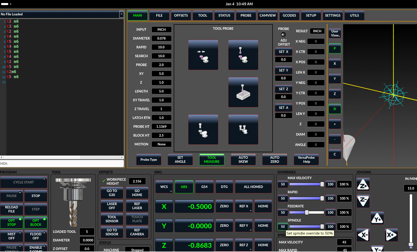

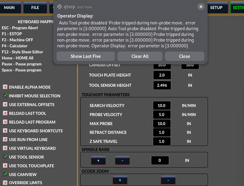

Okay figured that out too, the "Tool Measure" needs to be ON in the probe tab. So now I am able to T# M6, it moves to tool sensor, I get the pop up, I change the tool, it starts to probe down...suspense... touches the tool sensor and I get the error below.
On a side note the tool sensor does work. I would say to exclude out the "probe tripped during non-probe move" because when using the offset commands "Go to Sensor" and "Tool Sensor" it works and I do not get that error, what is the difference?

Can you show the probe parameters on the versa probe page please.

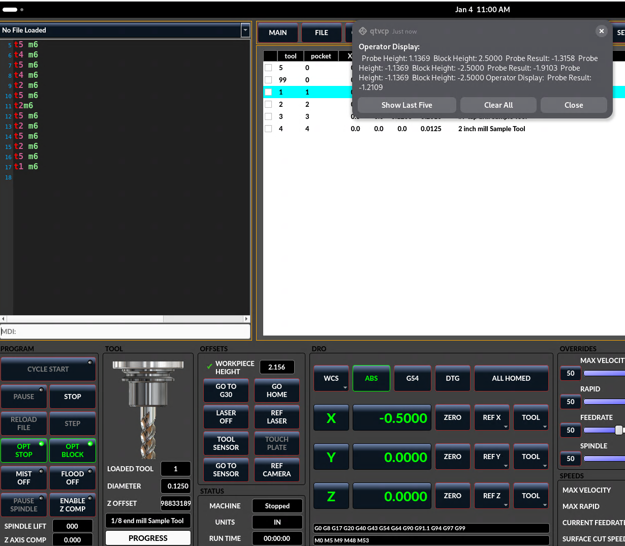

I have attached the probe settings screenshot, however I found the issue. The .ini file had [VERSA_TOOLSETTER] Z=-2.49, changed it to 0 and it works!
Thanks for the help! I have two questions though
1. What is the difference between the tool sensor commands (in the offset section) compared to this auto tool length change? Wouldnt have been the same?
2. The other screenshot "Zoffset" shows a massive Z offset. Not a concern though the tool able takes the correct number
