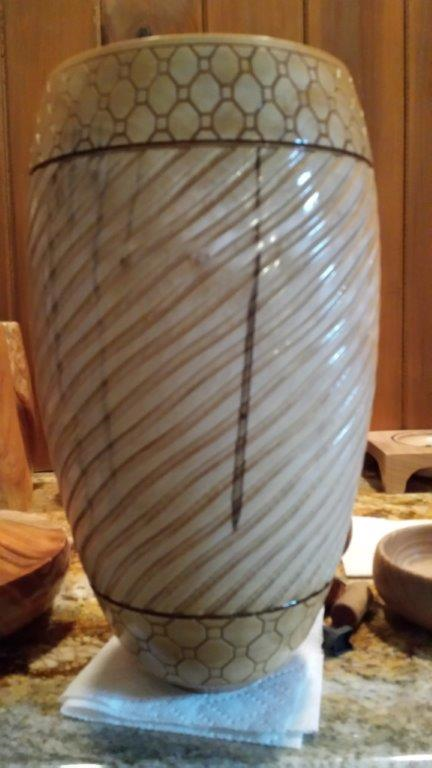

This is a chunk of Maple that I formed manually then used LinuxCNC and home-built mechanics to do the engraving. Most of the code was in Python/NGCGUI feeding AXIS.
The lathe is setup as an XZC lathe with rotation around the Z axis.
Dewey Garrett gave me the idea of "probing" along the surface and using those data-points in the code to provide a consistent depth of engraving. Works great!
I used a 1/8" ball-mill for the octagon engraving and a 1/2" round-nose router bit for the fluting.
Many thanks to the people of this forum for their advise, counsel and ideas....

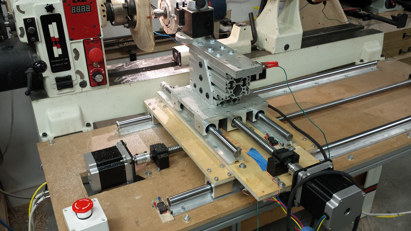

Nice! You might also post a photo of the machine that made it.

Here is a picture of the machine configured to engrave in the XC plane - the router can be adjusted to cut either from the end or from the side or anywhere in between.
Also, as requested, are the configuration files for my "mill" - I call it a mill because it does control 3 axis - although I can drop the C-Axis and run it as a 2-axis lathe with the lathe running under its own power.
