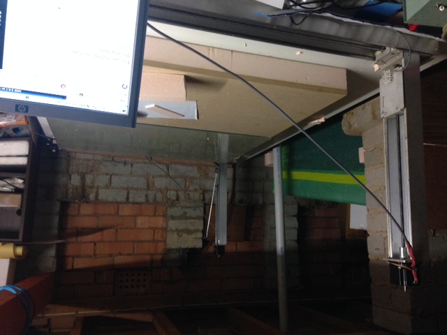

I finally got round to converting my home made foam cutter to LinuxCNC. I don't know why I procrastinated for so long, it wasn't difficult once I tracked down the specs for my hardware - after a false start about 6 months ago, in the end it only took a few evenings from first install to cutting my first piece of foam. Thanks for the great software!
The roadblock was the (obscure) HobbyCNC PRO Rev 1 Driver board, which is similar to the 4 axis chopper except for the following pins:
* 10, timer (not limit)
* 11, heat feedback (not A home)
* 12, auto/manual heat control (not X home)
* 13, NC (not Y home)
* 15, NC (not Z home)
* 16, heat
Once I worked that out (well, emailed HobbyCNC and got a quick reply from Dave) I was away.
I still have a lot of changes that I'd like to make - for example, I'm controlling heat manually at the moment (the board supports DC wire heat but I only have a convenient AC supply of the right voltage). I also don't have limit switches yet - the board doesn't support them, so I've ordered another parallel card and will figure that out when it arrives. I also think I'll convert it to BeagleBoneBlack+cape at some stage, because I only managed to get the jitter down to just under 75,000 and I don't enjoy the fan-whine from my old computer.
My config lives here github.com/monkeypants/foamcutter/, I've got a few questions but I'll try to post them in other more appropriate parts of the forum.

Ah FFS, that picture wasn't upside down when I sent it.
