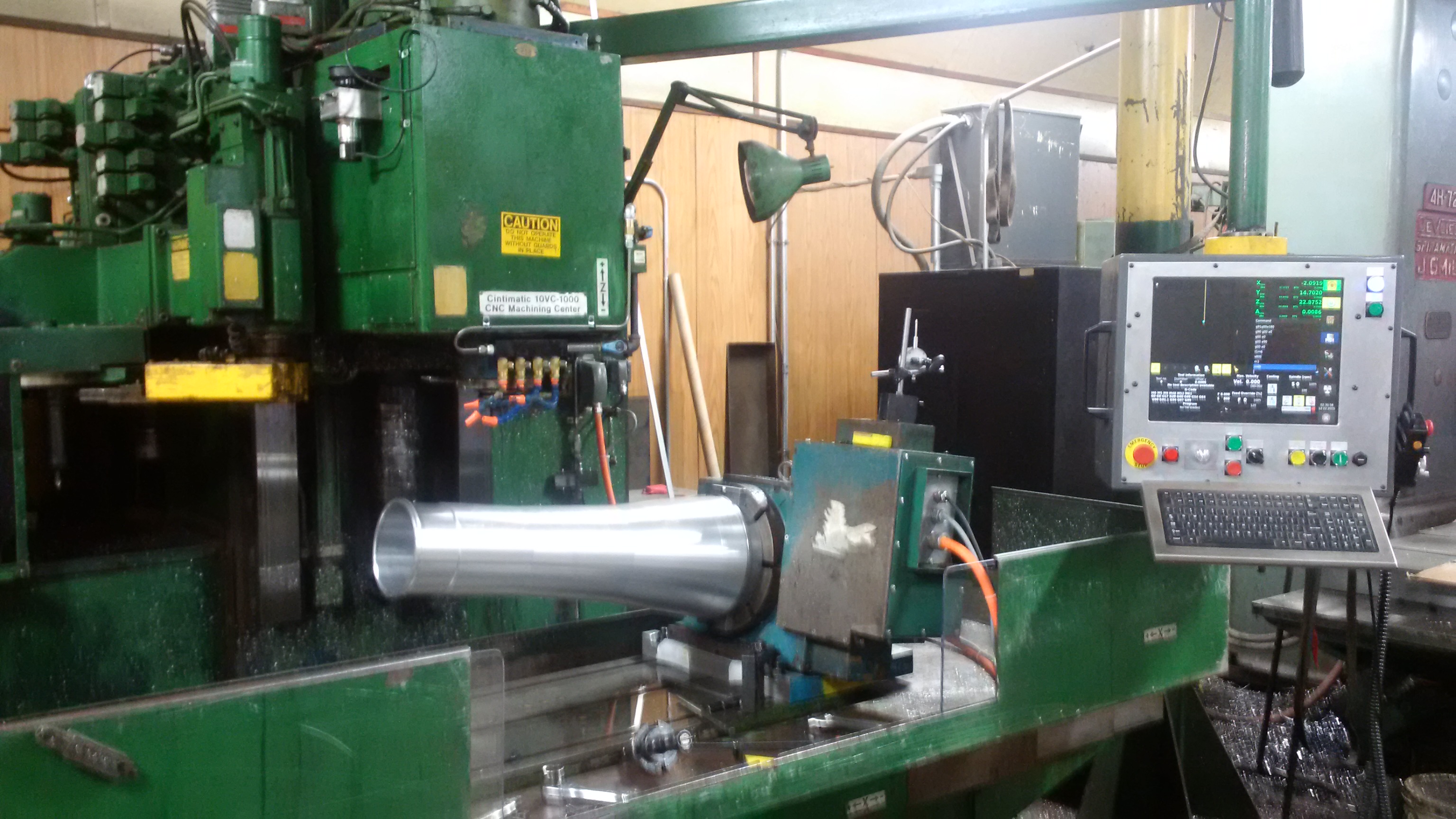

Here is our first VMC that we have done, this is a small clip of the tool changer in action, it utilizes the Carousel Component, and a pretty hefty chunk of ladder logic to run all of this.
More to come !!!!!!!!!!!!

Thanks Guys,
Update,
The machine is now pretty much fully functional,
The tool changer/carousel works using the Carousel component, it has the Moveoff component installed and working (so now we can Jog While Paused Woo-Hoo), and now it has a "A Axis" 300mm DIA Rotary contouring table outfitted with a 3kw servo drive with encoder feedback, with a internal hydraulic disc brake that is automatically commanded based off of the velocity command for the servo, so _NO_ operator involvement on setting or releasing the brake.
As soon as I get all my tools/BS off of the machine, and we get our first test piece running, I will take some more video and post it,
More to Come,
Rick

Here is our first test part, random program the boss made,
Rick

Here is the second job on the machine, Windmill components,
The part has mounting holes around the circumference in the large tapered section, that had to be perpendicular to the taper, so we mounted the A axis at the corresponding angle, getting ready to make some chips now.
Try to post a video when we actually start machining this.

Here is another part for that goes along with the second part we ran.
4000 RPM
189 IPM
5/8" DIA cutter
0.030 Depth of cut
Rick

And This is the finishing operation on the previous part,
Full X-Y-Z movement on each pass!!!!!
Definitely some very powerful software!!!!!
Rick
