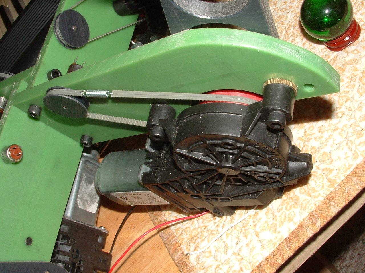

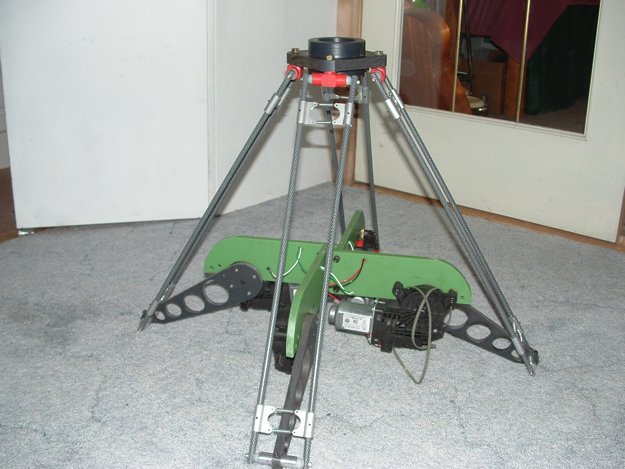

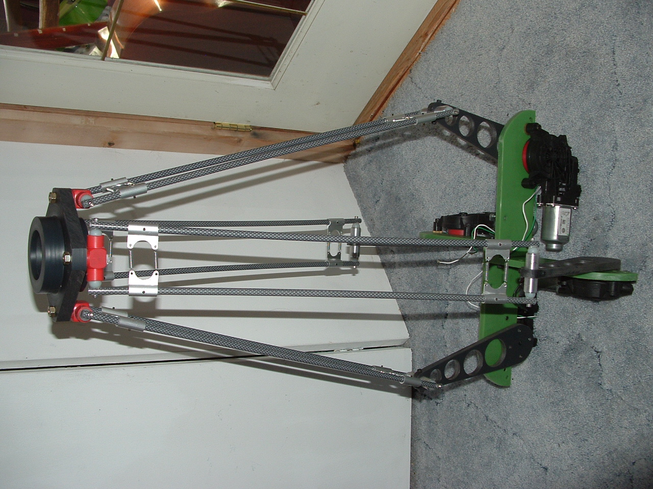

Hello all, I am new here and this is my first post. What I am working on is a pick and place robot arm.
I want to use the Linuxcnc program to run the arm.
The arm will be controlled by four pwm servo drives.
I am looking for information on servo control using Linuxcnc.
I need some help to aim my sites in the general direction to find the information i am looking for.
Thank you, Joseph.

That appears to be a delta robot.
There does not seem to be a suitable kinematics included in LinuxCNC (I thought that there was) but a Google search for "deltakins" will find you some examples.

One observation: I don't see any home switches on your system. You need to be able to find a repeatable home position for each actuator to be able to properly calculate the kinematics.

Yes I will need the end stop and home switches. A work in progress. Thanks.
