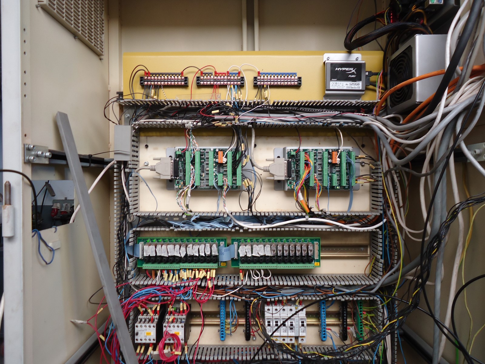

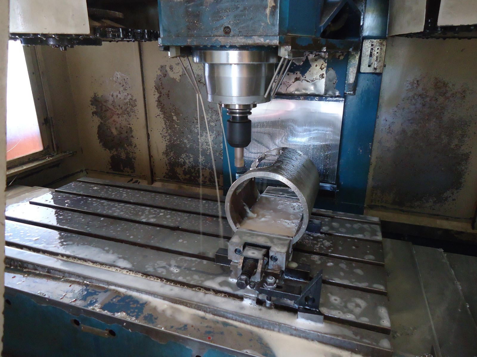

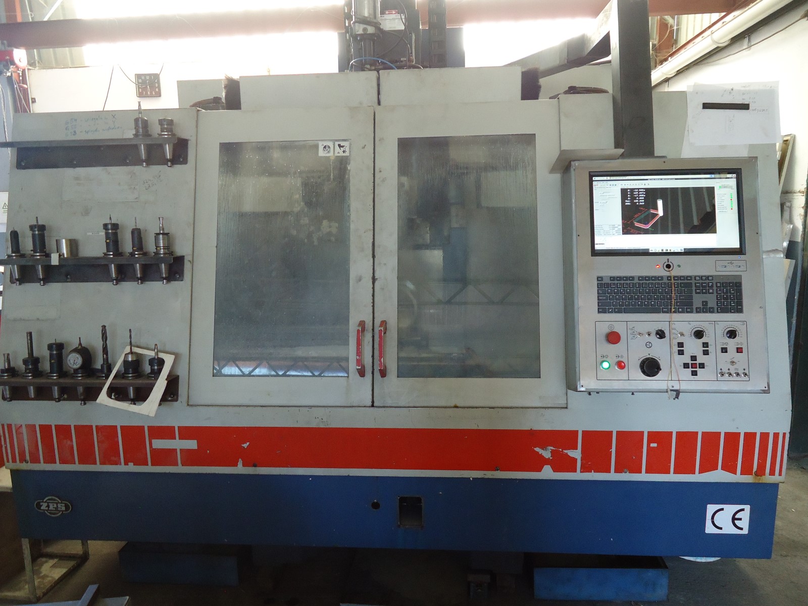

Already working but still unfinished (mostly organize the wiring).
7 000Kg (15 500 pounds) machine. Both used without working controller. Drives in working order so we used almost that we could. Using two 7i77 as we have "X" "Y" "Z" "A" "spindle" "ToolchangeLeft" and "ToolchangeRight" analog controls.
Retrofit made in my workshop with the help of jtc (forum member).
Forgot to say thank you to all contributors to LinuxCNC.
