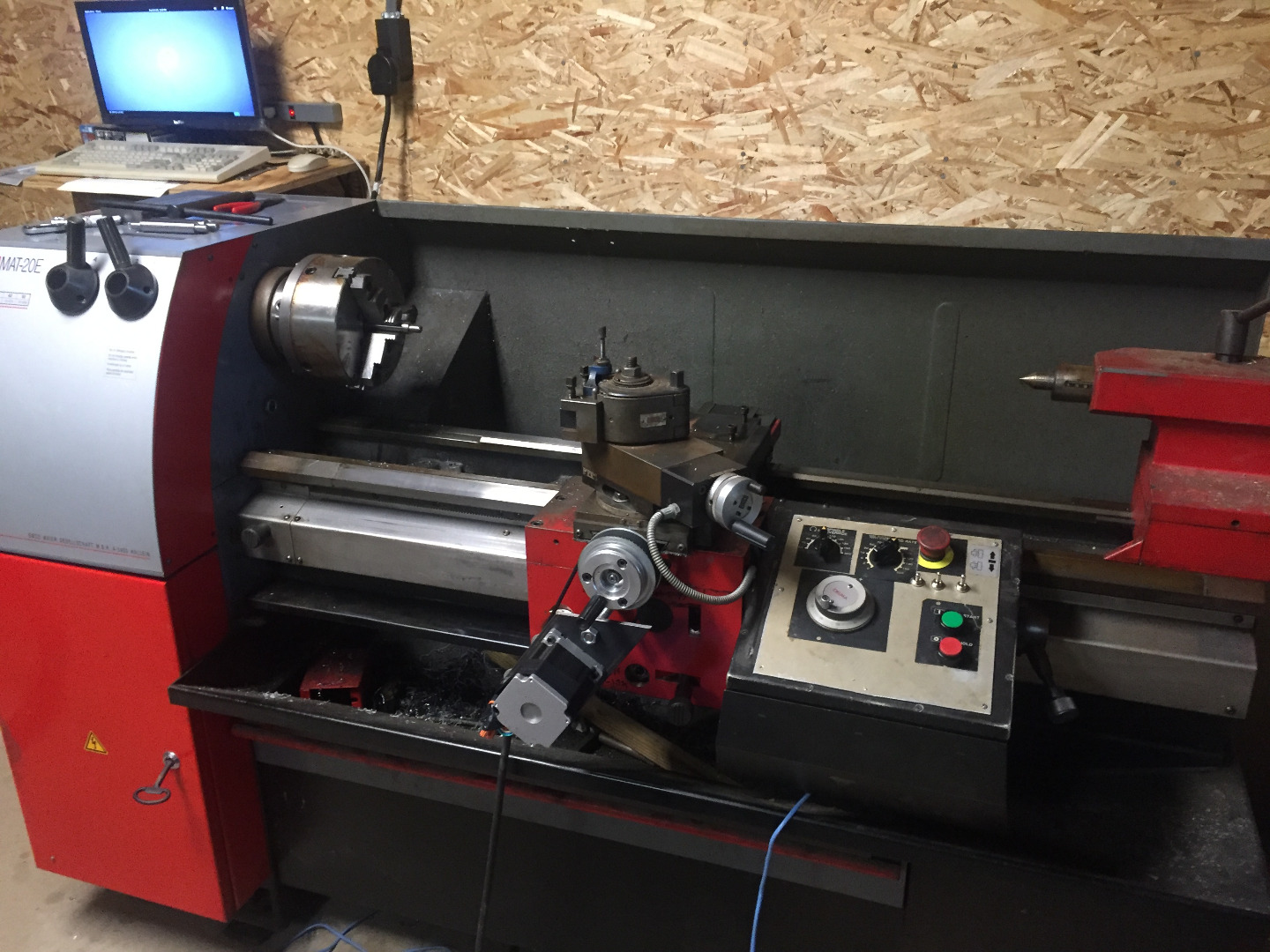

After about two years I've finally finished and made my first parts yesterday. I just wanted to post some pictures and give a BIG Thank you to all those who have helped me and responded to my posts. Also a BIG thank you to all of you who have put in countless hours writing and building Linux CNC. You have truly done the heavy lifting here. I just connected stuff together, and did a whole lot of reading.
Thank you all!
Build List.
EmcoMat 20E
Mesa 7i76e
Huanyang inverter
Wanti steppers and drives
Old Okuma Control Panel
Thank you all!
Build List.
EmcoMat 20E
Mesa 7i76e
Huanyang inverter

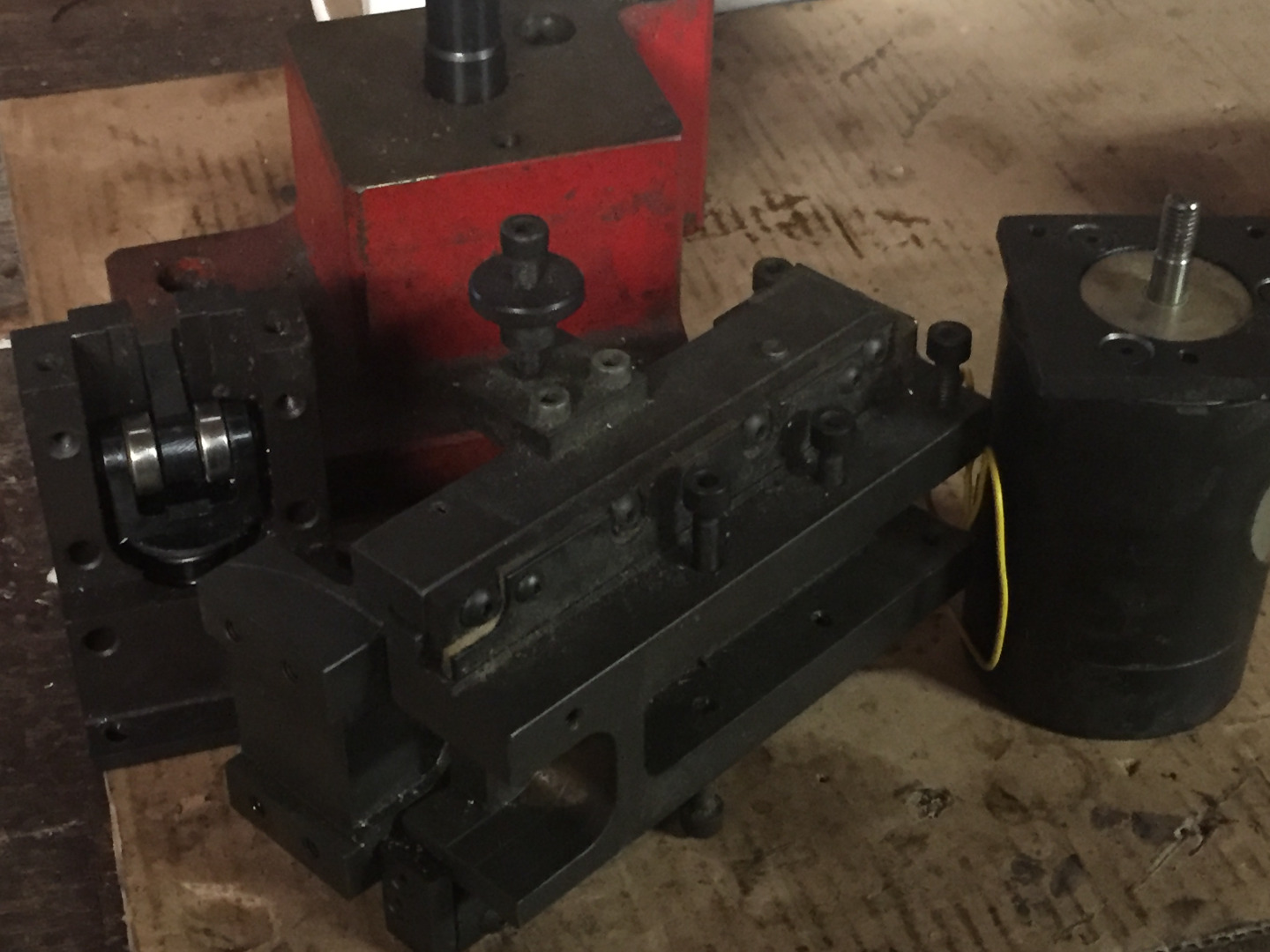

Replied by andypugh on topic Finally Finished! EMCOMAT 20E
Is that a motorised compound slide? I don't think I have seen that done before.
- Mtndrew77
- Posts: 56
24 Oct 2016 18:11 #82001
by Mtndrew77
Replied by Mtndrew77 on topic Finally Finished! EMCOMAT 20E
No, but it has a rotary encoder inside. It's not hooked up, but I left in there in case I every thought of a use for it.
The whole machine is kind of strange. It was only a single axis CNC and you switched between x and z with a gear lever.
Tapers had to be cut old school, and it had a special tool holder that just actuated in and out for threading.

24 Oct 2016 23:15 #82019
by Mtndrew77
Attached a picture it just takes standard stick tooling. The solenoid moved it back and forth about a quarter inch.
I'd be willing to sell it, or barter for some other multifix holders if anyone is interested.
