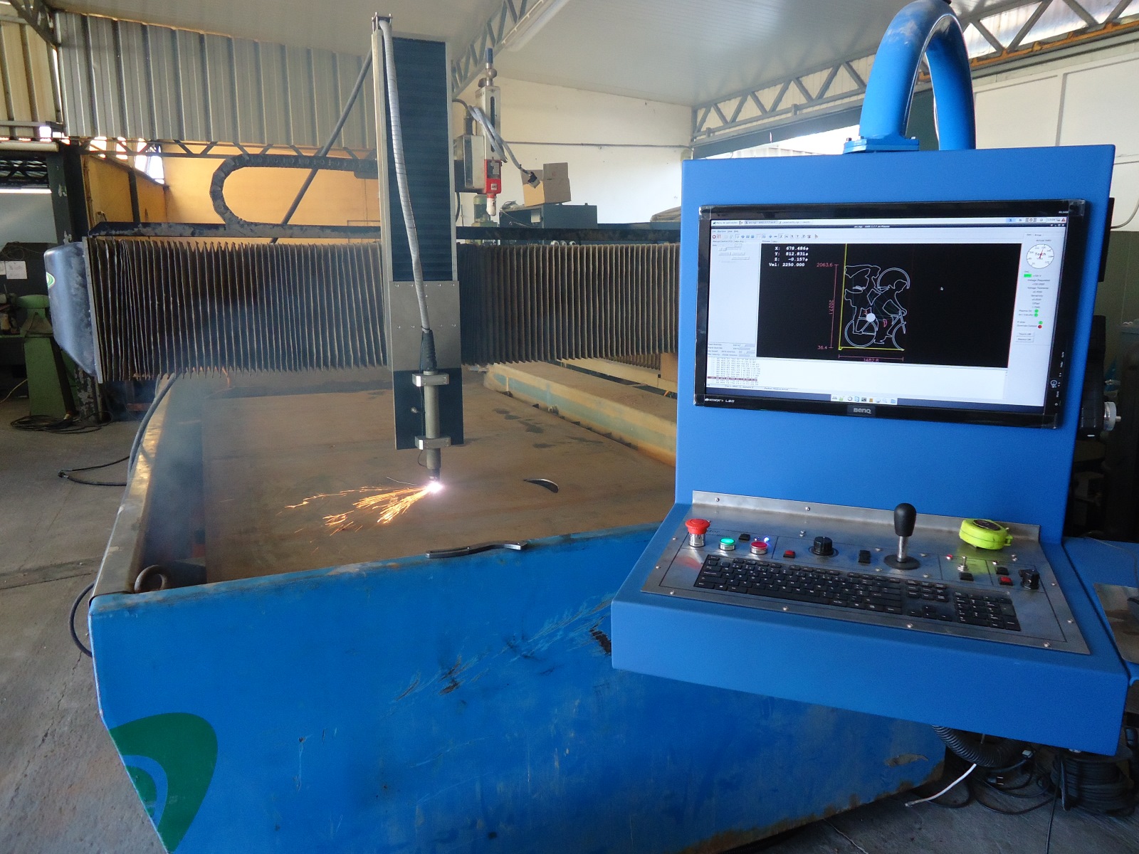

This machine was retrofitted for being used as a dual configuration: WaterJet cutter and plasma cutter.
Full control was rebuild and using mesa 7i77+5i25+7i84. Z axis was fully constructed by us with a travel of 750mm.
Retrofit was done together with jtc.
