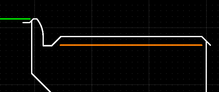

Lathe using C axis mode making a synchronized pulley

Replied by andypugh on topic Lathe using C axis mode making a synchronized pulley
I have the right hob for making T5 timing pulleys, so can do it this way:

And by the way, removing the rod from the lathe, putting it on the mill will always go a bit of center.
Making all in one tight provides the best result.
