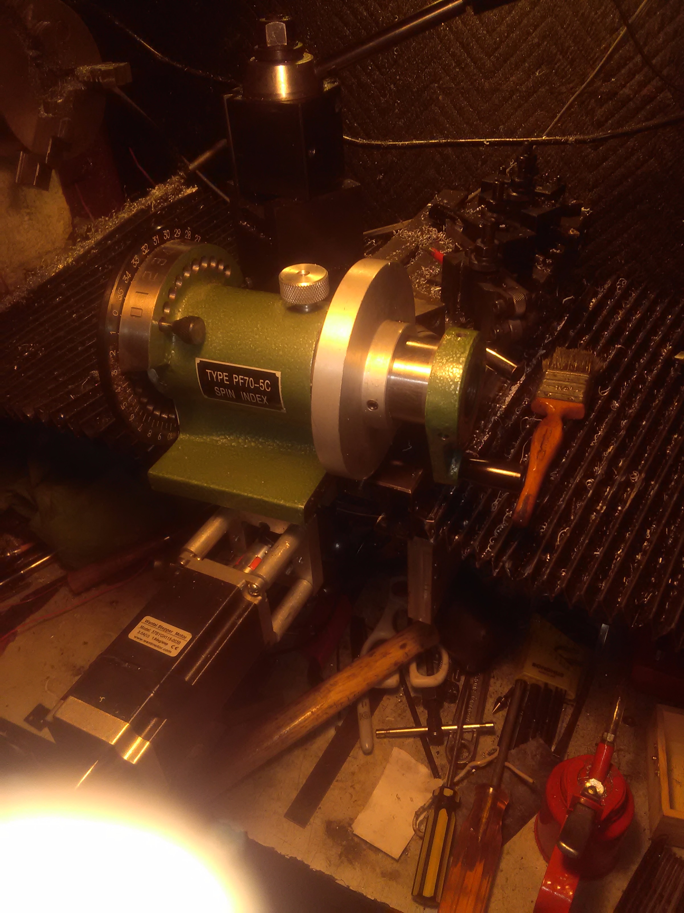

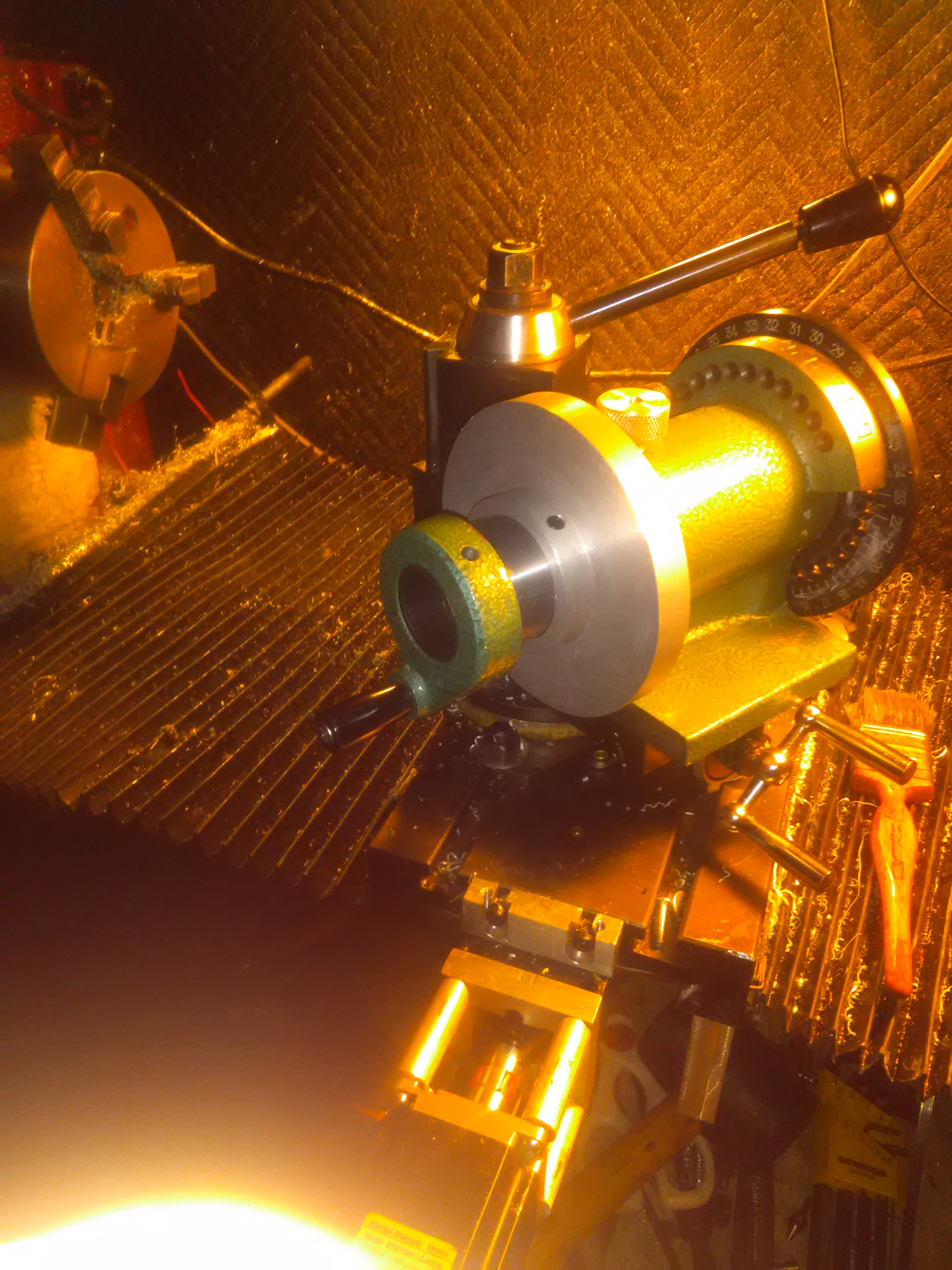

Nema 23', Spindle index with electronic control was created by Sjdc1982

Nice, i need to make a bigger one that can be used as a spindle also, but completly controlled by Linuxcnc.

Truth be told that is my plan lol. A C5 to 5" chuck plate...
Would be more for drilling indexed holes for u-joints of leveling heads and such than a 4th axis though.
Not sure it if would be useful or rigid enough to use for milling complex features, maybe flats...

I plan on using a brake for it so when stationary it would be firm. I have 2 disk brakes from a 1000cc Kawasaki that i dismantled a while back, should do the job nicely.

fyi i'm stealing your idea, didn't think about that. Setup a pneumatic switch on the brake... sweet
I got an extra pair of MTB disc brakes i got for a few dollars way back.
