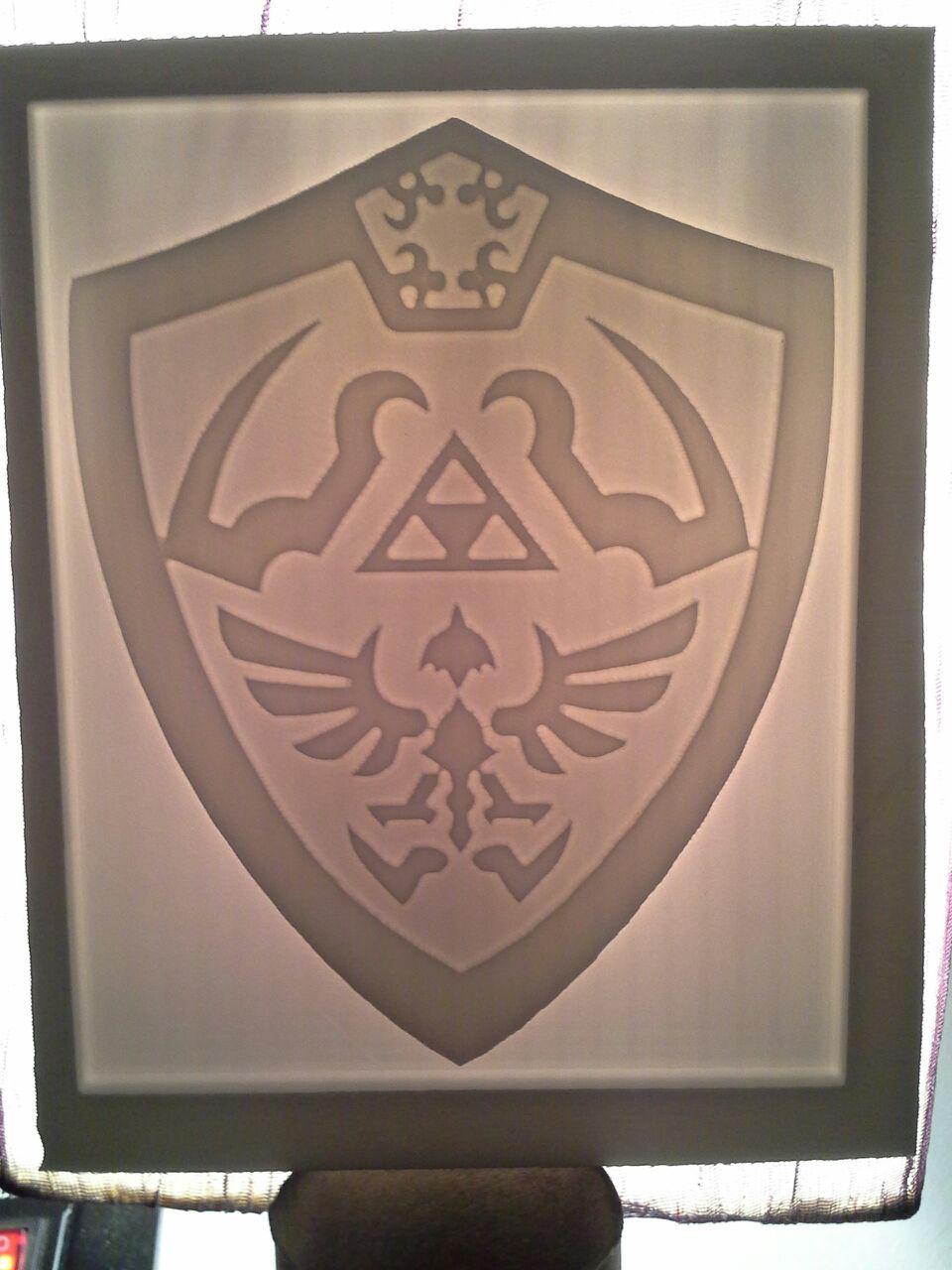

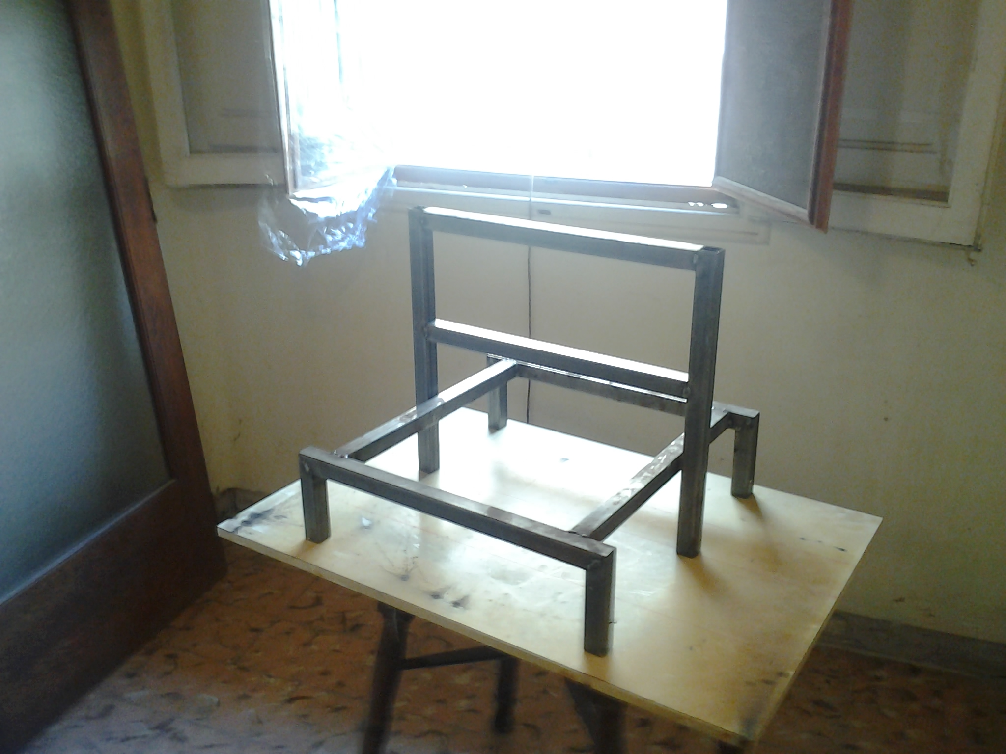

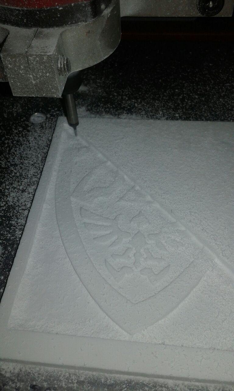

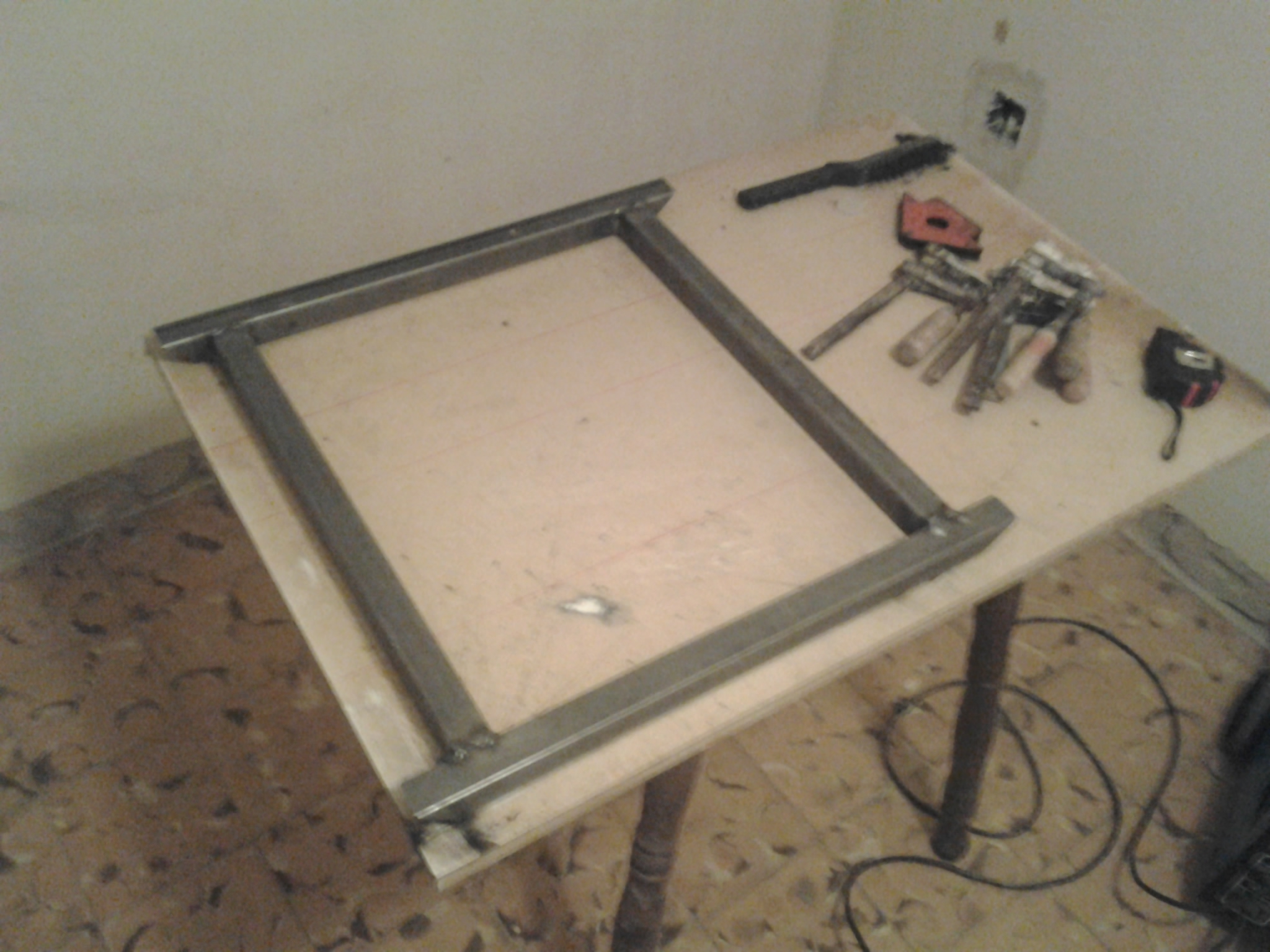

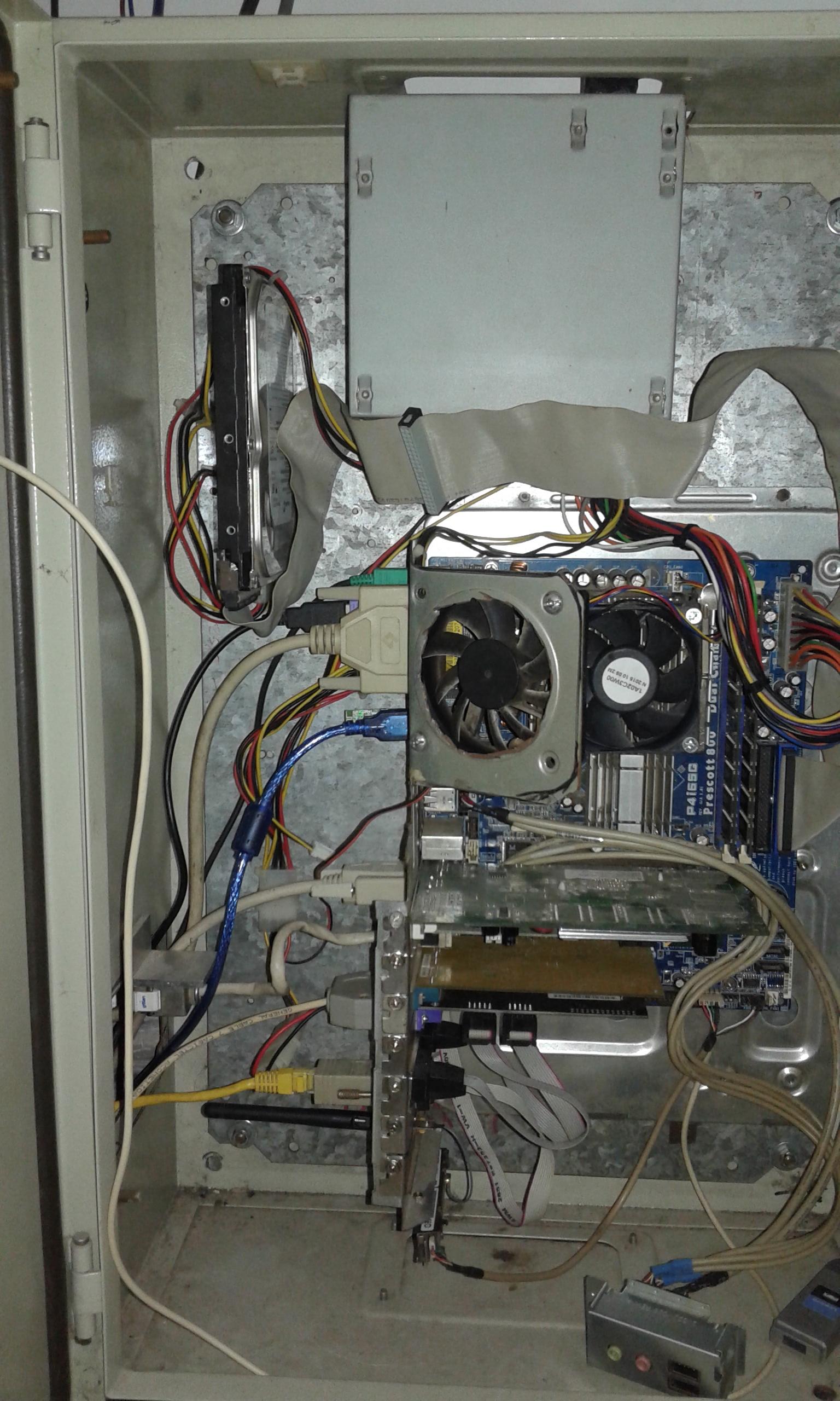

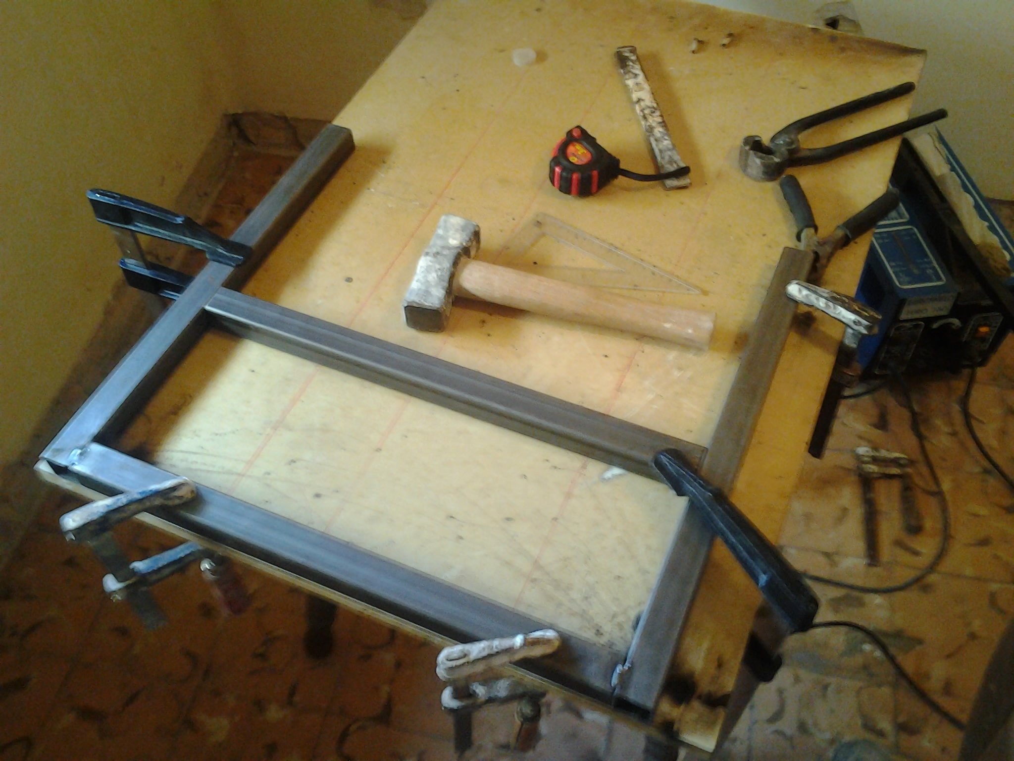

Fixed bridge machine finished
- TurBoss
- Posts: 134
- Thank you received: 81
30 Apr 2017 13:24 - 30 Apr 2017 13:24 #92361
by TurBoss
Fixed bridge machine finished was created by TurBoss
Last edit: 30 Apr 2017 13:24 by TurBoss.

Serial DRO finished too
with velocity and direction

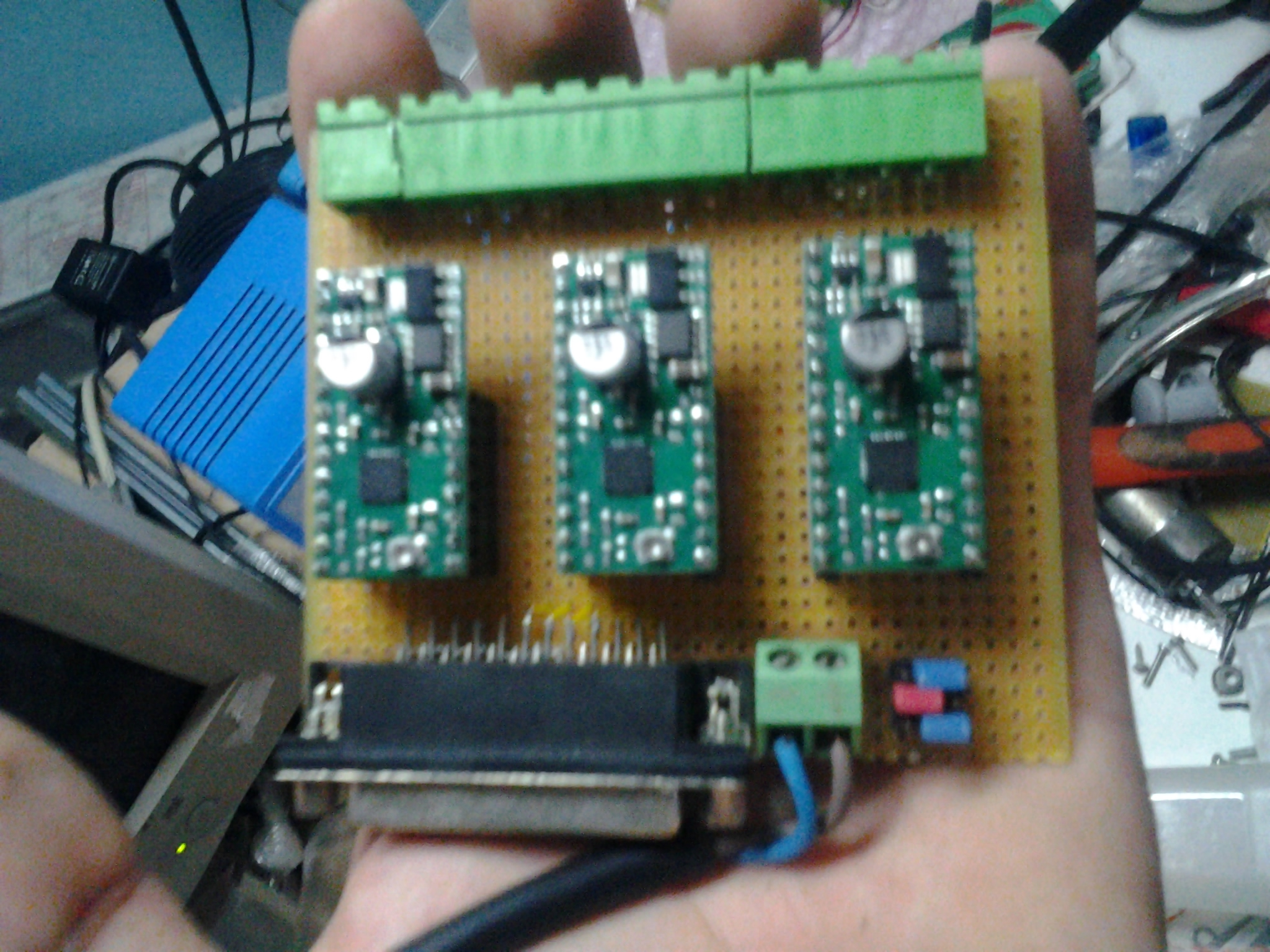

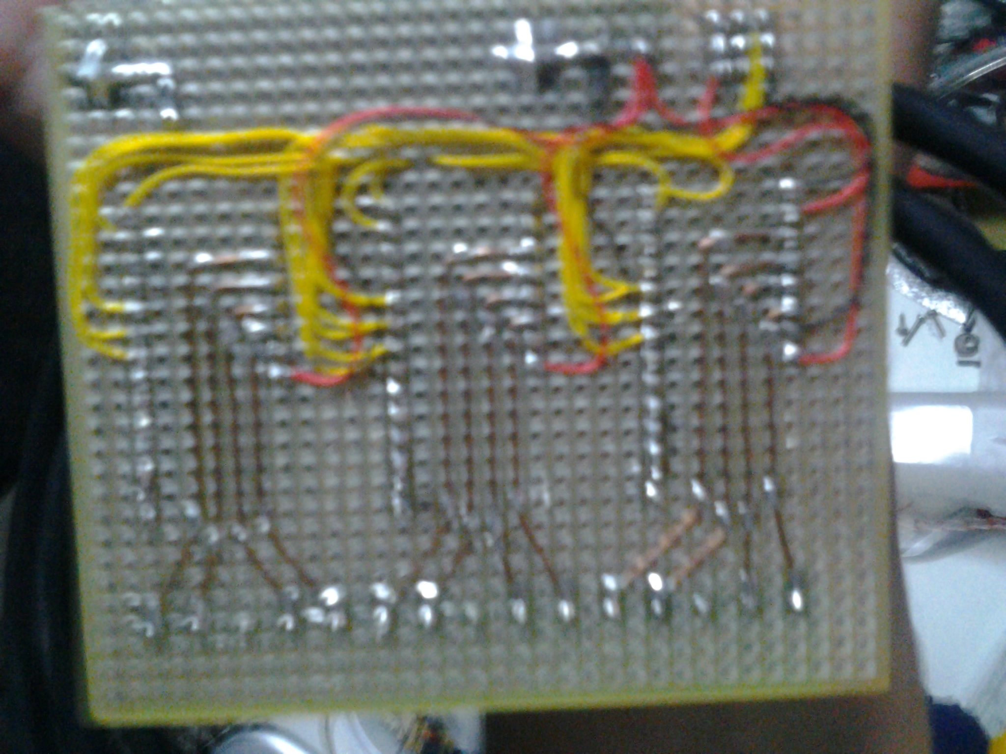

Hi TurBoss,
Was wondering if these drivers (A4988) provide enough power to run your machine? How are they perform? I have few of them laying around so I might find a use for them in a project.
Would you have some measurements made during machine run ( like power usage and speed)? Thank you! Ivan
- TurBoss
- Posts: 134
07 Mar 2018 02:59 - 07 Mar 2018 03:02 #107070
by TurBoss
sorry for the delay
I measured the motor current with the multimeter and adjusted the drivers to only give 1A for each phase
motors where 2A
so they run at the half
Replied by TurBoss on topic Fixed bridge machine finished
Hi TurBoss,
sorry for the delay
motors where 2A
