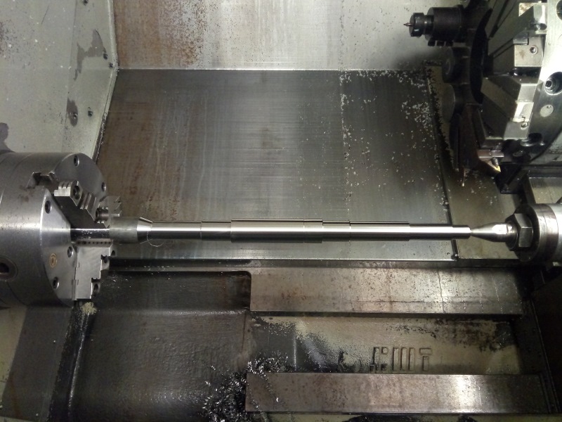

Some pictures of works done with the help of linuxcnc.
The lathe work is particularly hard as the tolerance is about 0.01 on two positions of the shafts as they were sits for rollers. The shafts were machined with just one fixing, making the shaft as concentric as possible in both sides.
The longer one (about 500mm long, in stainless steel) was even harder due to the need to avoid vibration (ratio between length and vibration).

This would be very easy to do with LinuxCNC:
