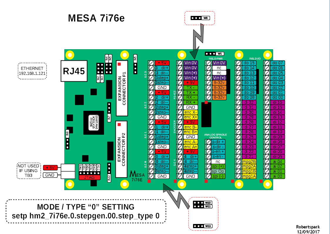

7i76e pinout here:
(I'll add it to a seperate thread post for the 7i76e along with the model link once complete)
[note this is meant for my file, hence it's setup for step & direction configuration as per the pinout I require and the jumper settings accordingly, mainly for my quick reference.... colour works better for me to see things]
