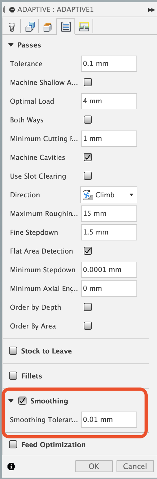

i dont know how i can do that. i´m using Fusion360 for this code.Can you persuade the CAM to make the Z steps 10x larger?

Replied by andypugh on topic Harmonic drive 4th axis build

ah ok but smoothing i always have 0.01mm
edit: changed from 0.01 to 0.2mm now works faster. thank you so much!!!
Try 0.1mm and then try cutting air, just to see what happens.
