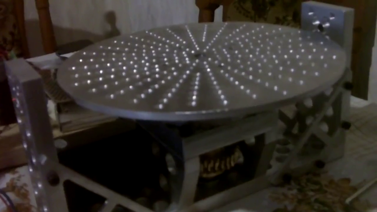

hi
here is the new C-axis at first moving
it is a Nema23 3Nm
at TB6600 the mashine got DM556
Test at 24V Mashine 48V
BOB is mach3 5axis mashine got 7i92
Build with Students on non CNC DRO mashines
Happy to take your Thinkings and Questions
Video

Looks nice for sure. Are the holes tapped ?
