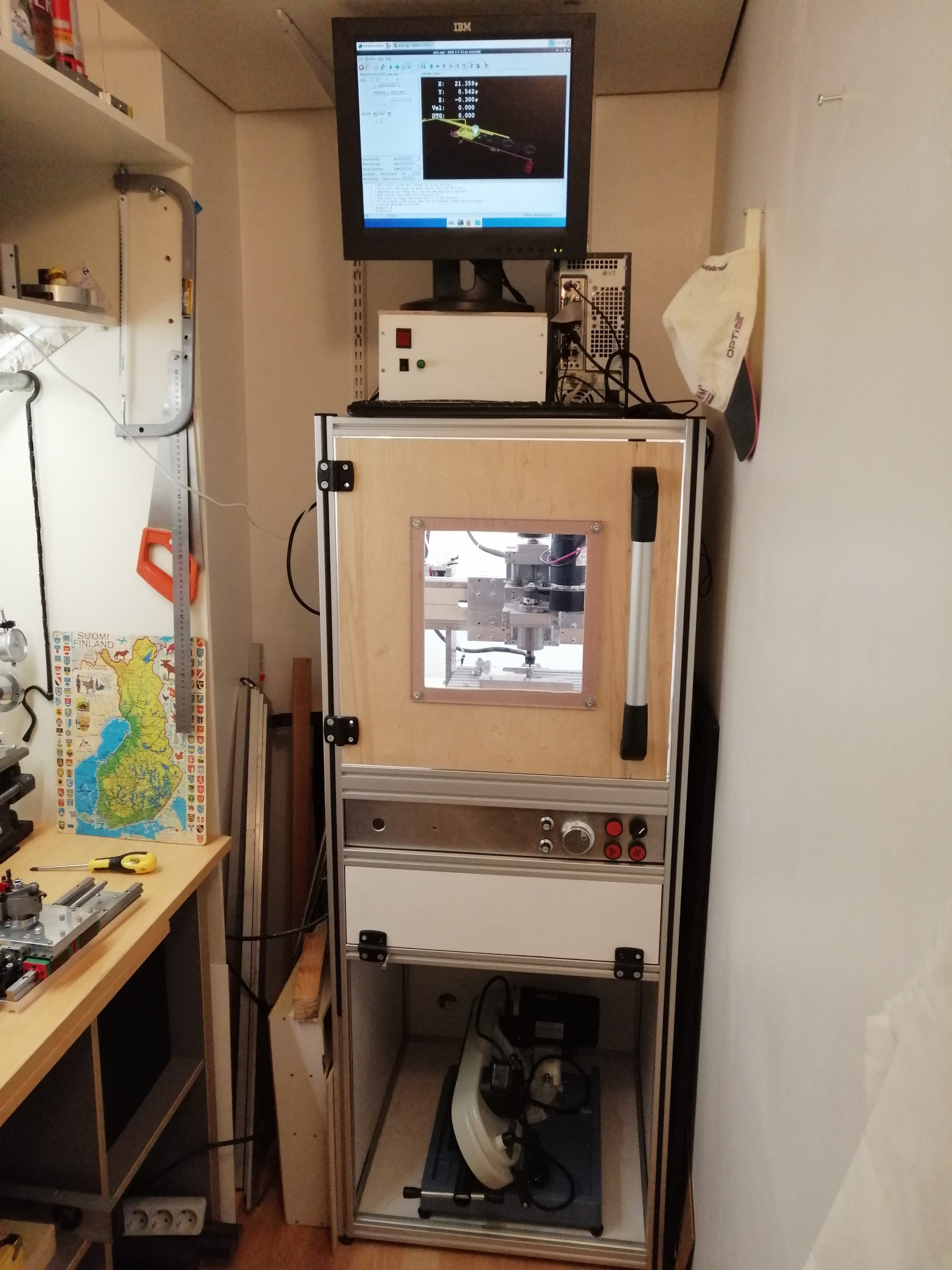

09 Jan 2020 20:53 #154489
by HiioHoi
Replied by HiioHoi on topic Workshop update

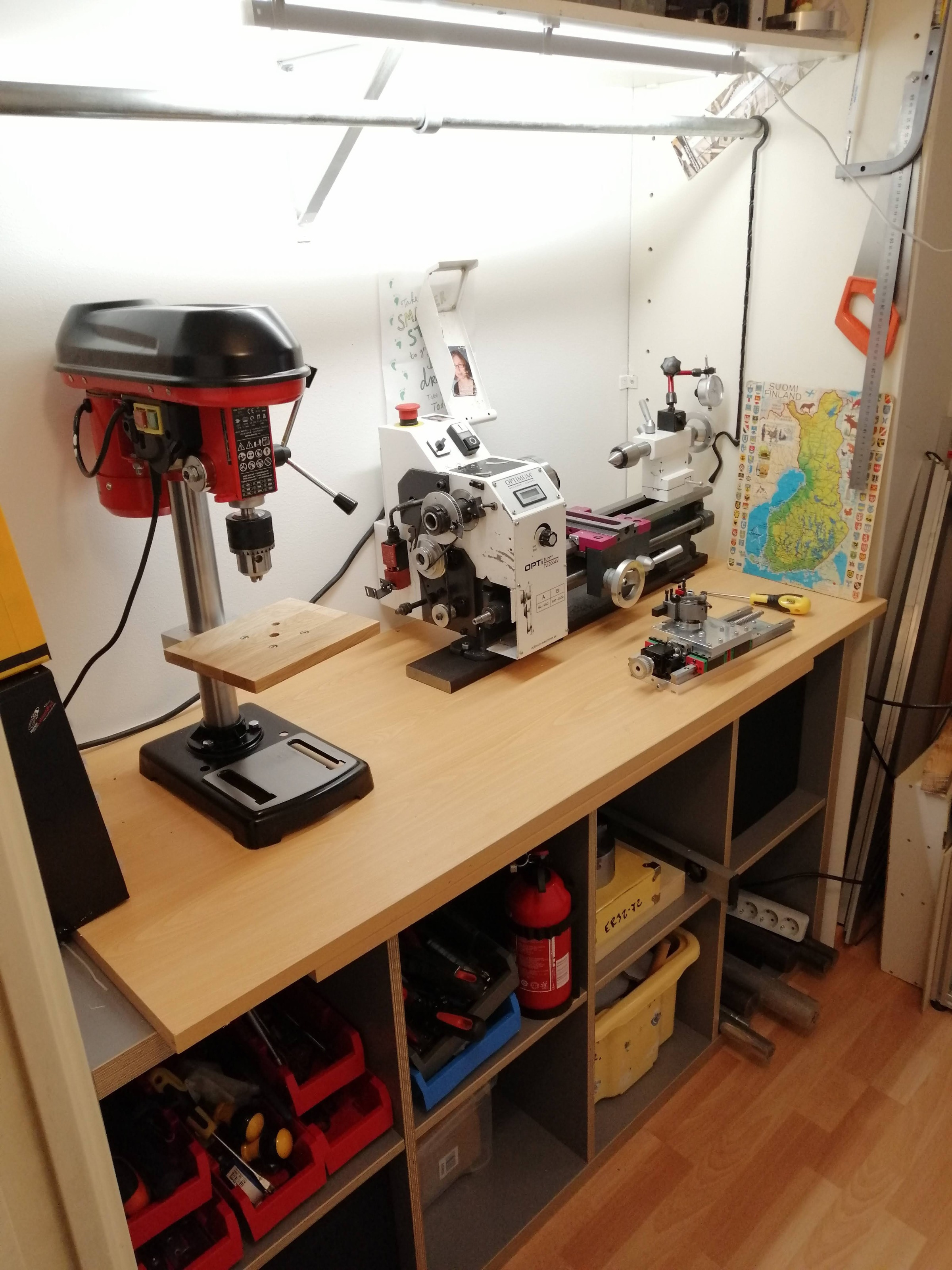

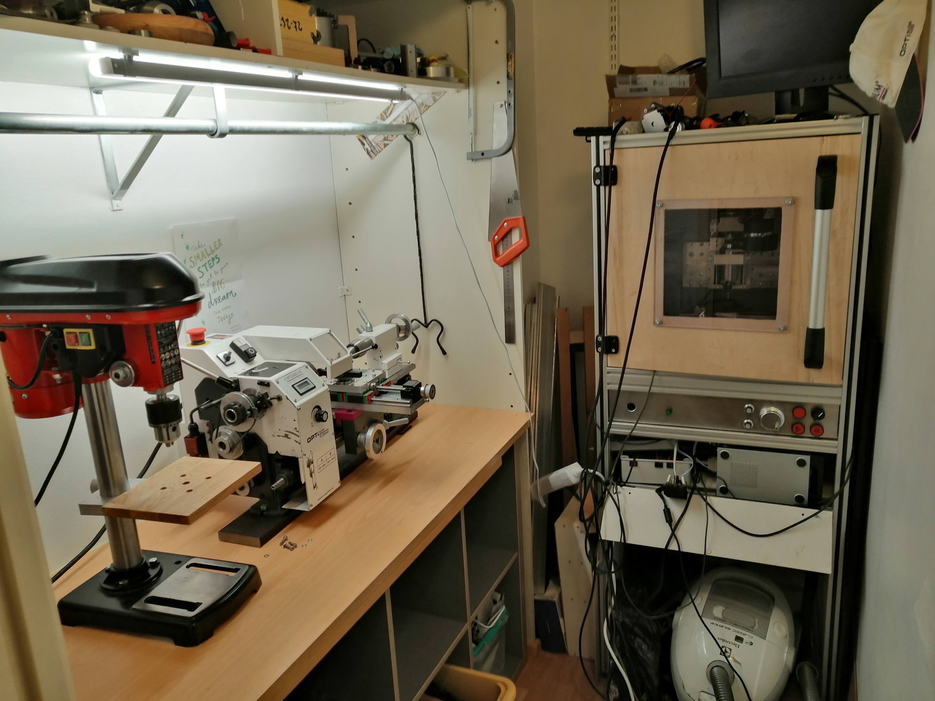

I have to contribute to this topic also. My workshop size is 1,4x2,1m and I have done some progress today. Added Kallax shelf and workdesk which is of course extra supported from back. Next thing to do is clean up milling machine wiring and move computer and controlbox to top of the milling machine enclosure. Currently I am waiting to arrive beefy 24v power supply to remove all laptop power supplies. I will add another photo when all things are done.

Neat little shop, thank you.

27 Jan 2020 08:47 #155880
by bbsr_5a
Replied by bbsr_5a on topic Workshop update
is the BOX Noice or Dust related
the HF Spindel doesent like closed frames on long time part millings

27 Jan 2020 10:00 #155887
Small spaces are fun. My shed was 2.4 x 4.8mm. I'd love to se a few more photos of your optimum Conversion. Very nice with linear rails and all!

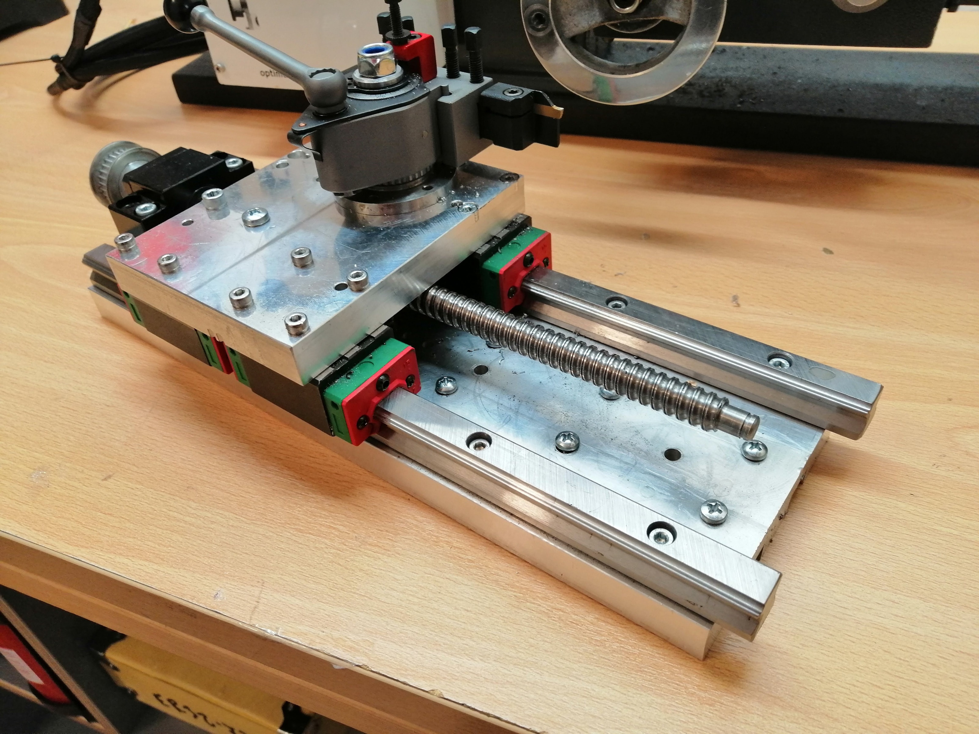

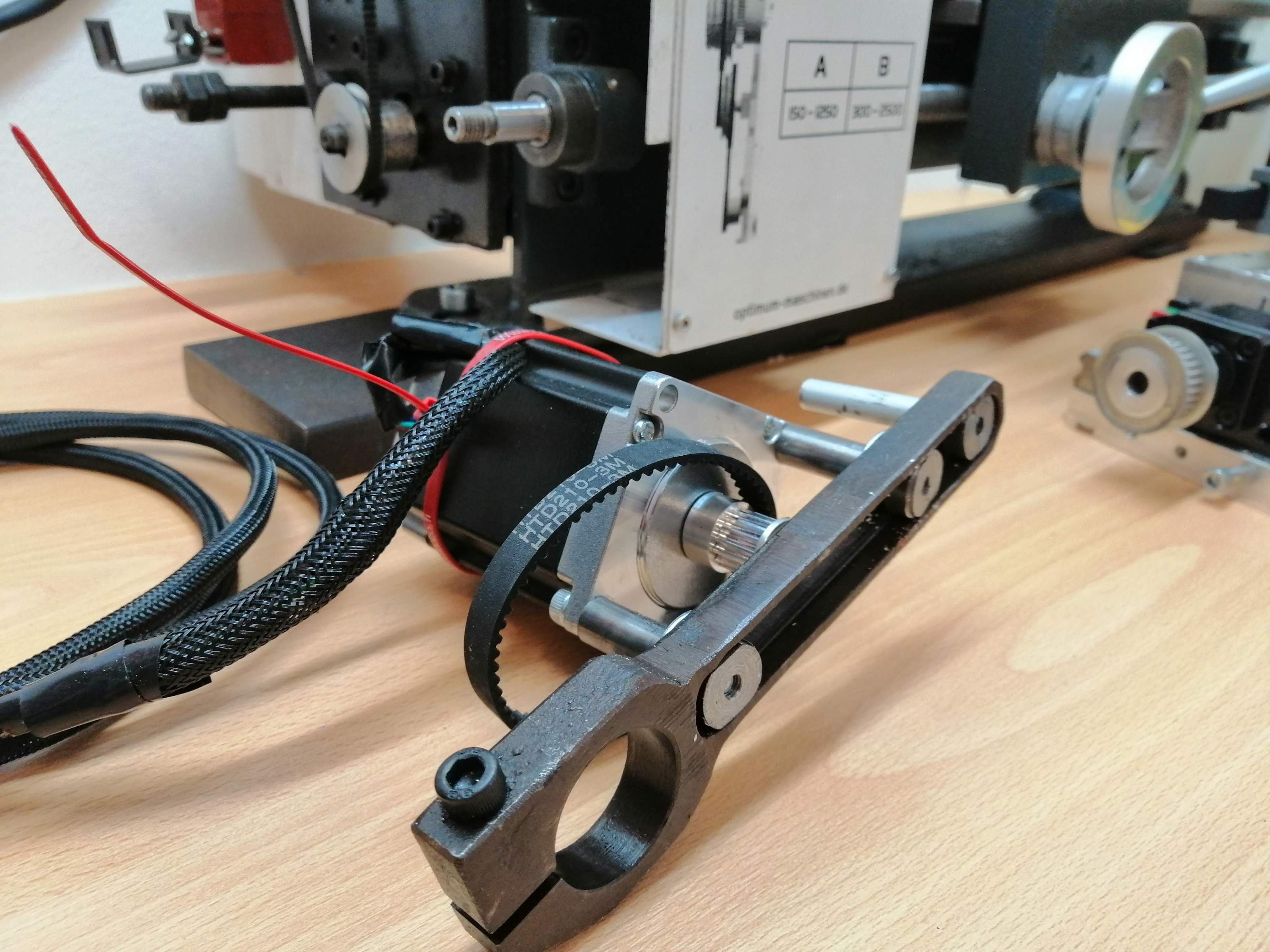

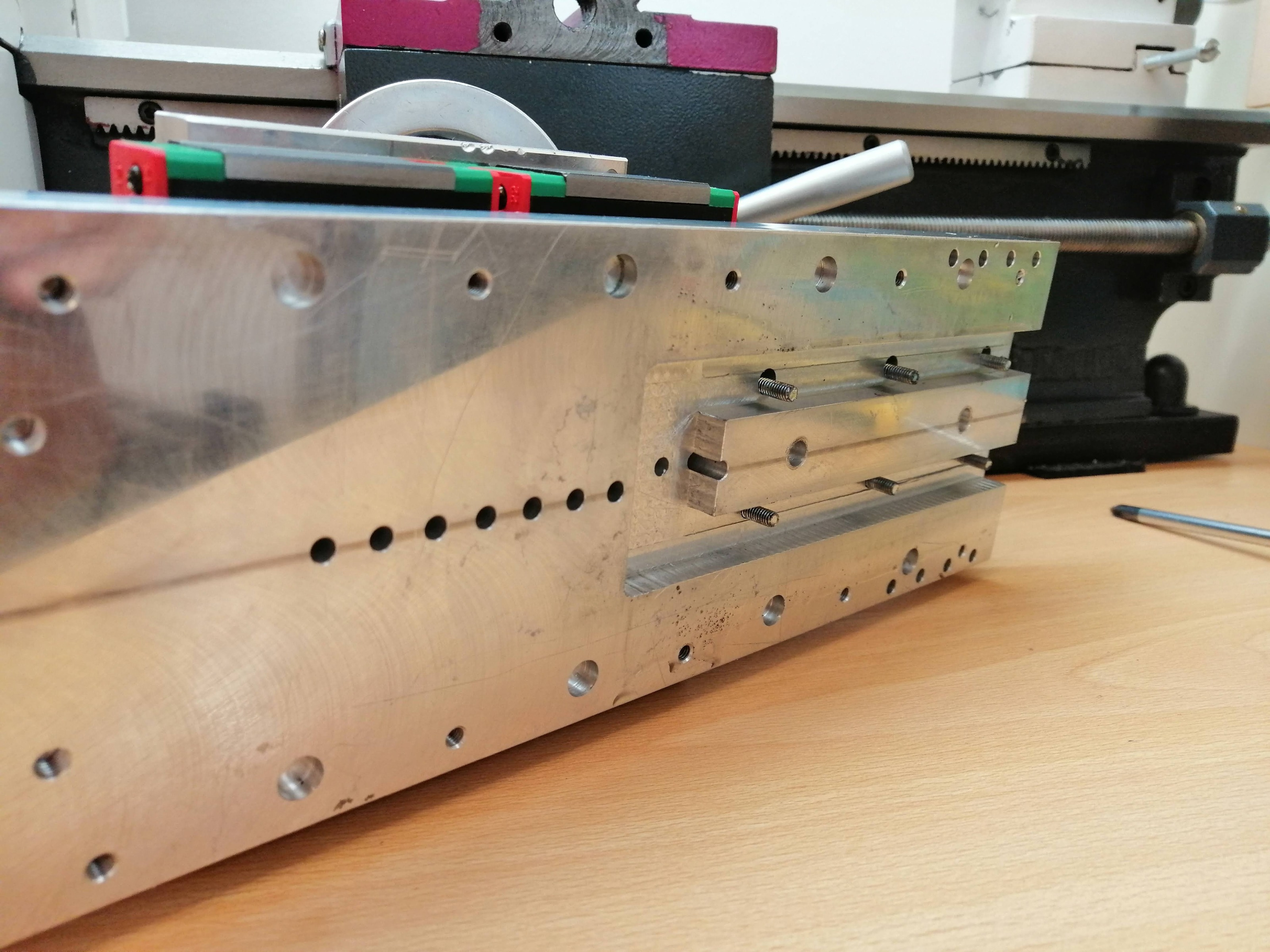

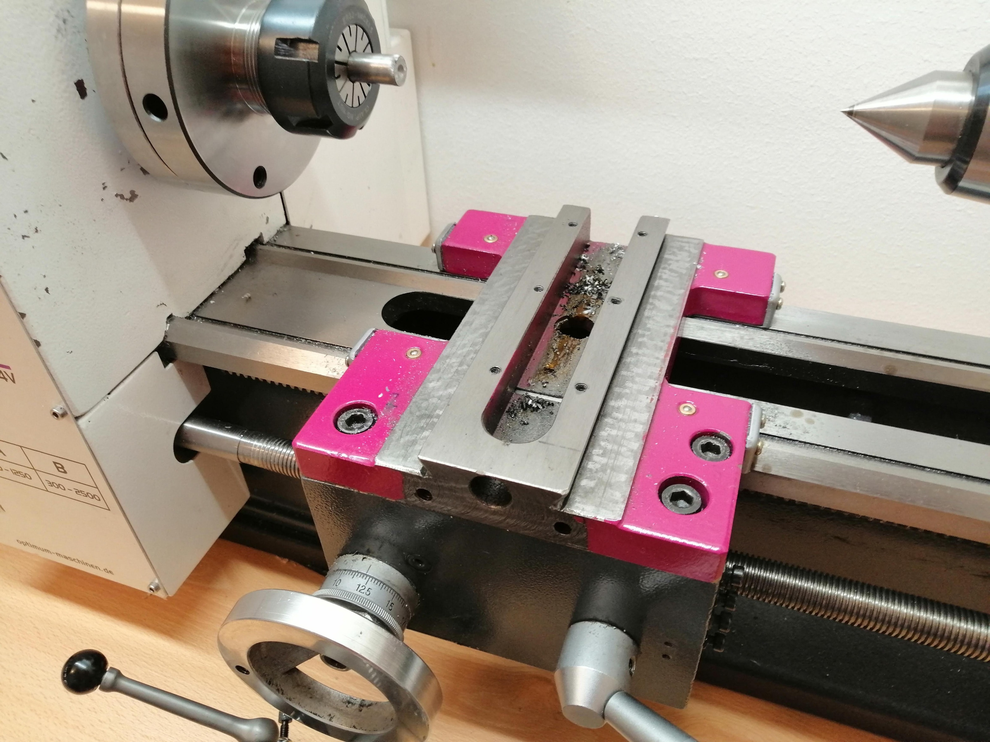

31 Jan 2020 19:41 #156273
by HiioHoi
Here is few photos of my conversion and my new 90% finished workshop.
I used original leadscrew for z-axis and banjo for easy stepper motor mounting. I hope pics will tell full story but if you have questions please ask.

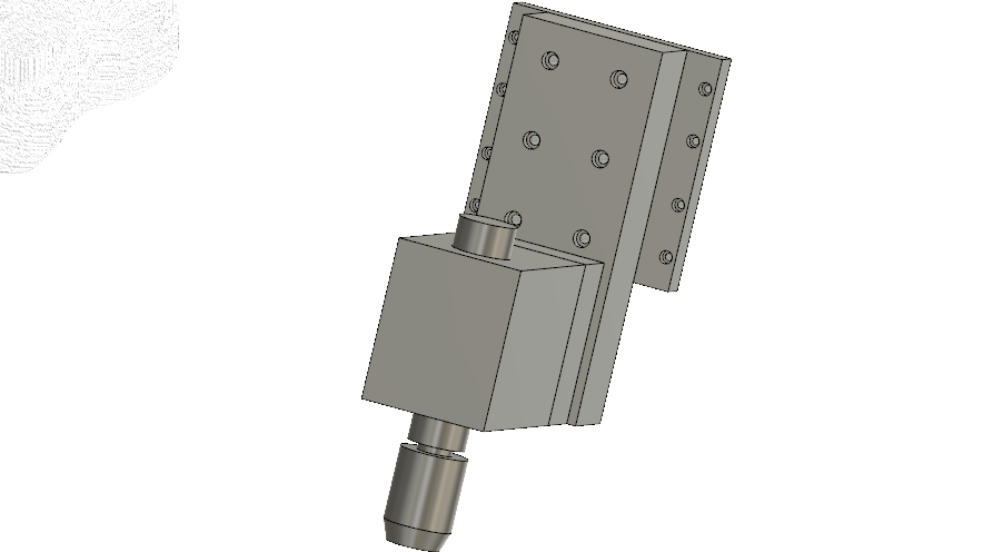

01 Feb 2020 11:34 #156297
by machinedude
Replied by machinedude on topic Workshop update
i bought a lathe of this size a long time ago. the model i bought is actually discontinued now so i guess that makes it old now even though it seem like i just bought it not to long ago.
i converted mine a while back but kept the basic machine untouched other than adding motors and a ball screw on the z azis. i'm actually going to try to mount the milling head on the 4' x 8' gantry table i'm working on to see if i can gain a light duty gantry mill. i know it will work on aluminum the rest is to be determined still. the one i got was a combo machine and had the milling head attachment and it should end up looking something like this when i get done with it.
the lathe is going to get redone soon as well i would like to loose the step pulley v belt drive and switch to a servo motor instead.
