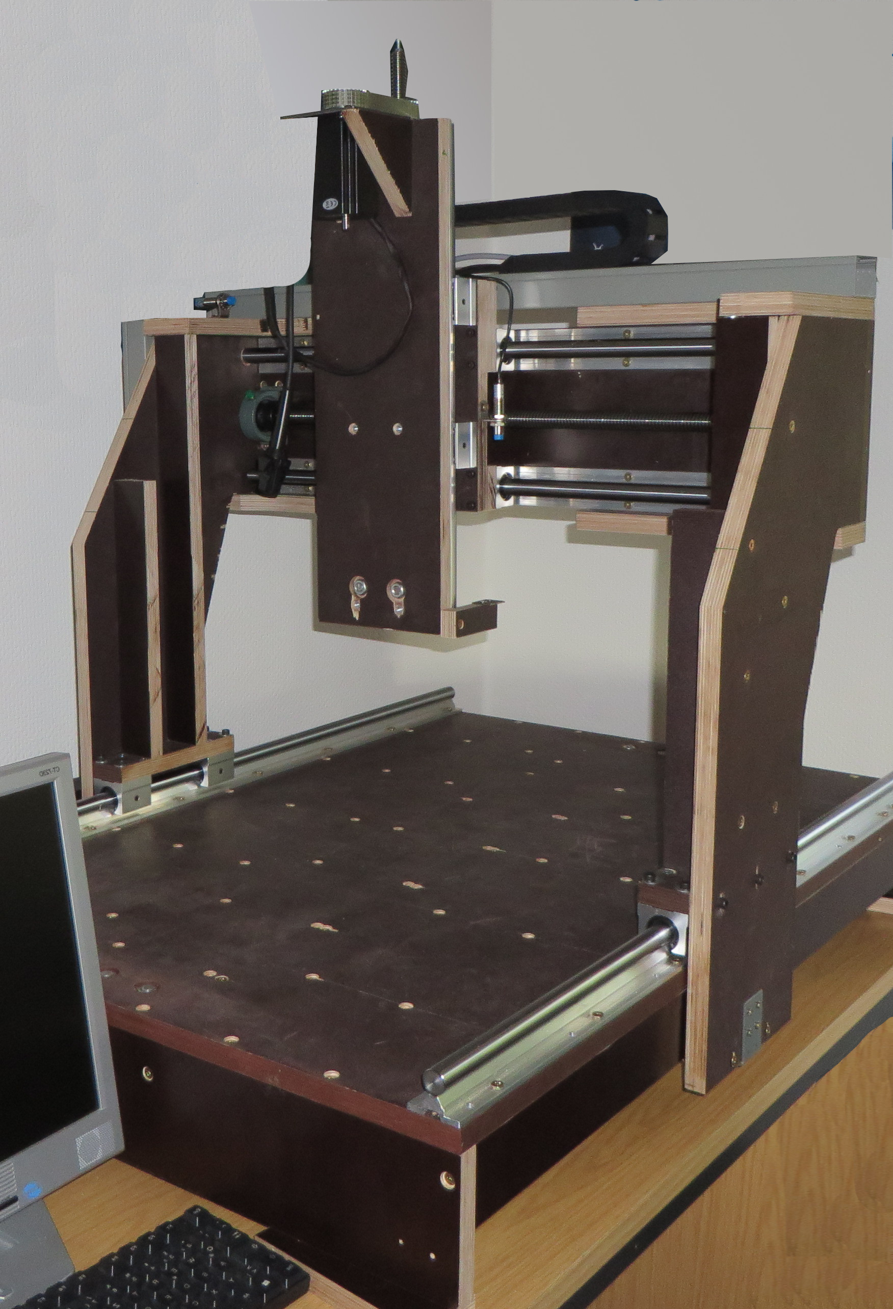

Hi here i gone show you a Build of a CNC friend that realy got nothing as a DRILL
all parts are standard nothing is realy dificult
the TR20x4 fits perfect the UCP bearing AT mjodern times you will fit this 2005 and sqare rails
also a side mount of the HGH as prices are down
outside makes are only the holes in the Timingbelt drives and motor wheel at 2005 its 20teeth on motor and 25 on balscrew
at tr20x4 its one on one lowering cost
at higher budget >1k you will do DM556 electronics and lots more
IT IS A BASE MASHINE BUILD no more no LESS and it fits his need

the moddern Price now woudt be including HGH set 1200x1200x400
and Dm556h 36V 3Nm
at 870.- Euros
and Dm556h 36V 3Nm
at 870.- Euros

Here at least twice that. Anything over 25 Euro has taxes and customs and transport taxes, and the base price for those calculations is literally "search the web and find the highest price possible ", not the invoice price.the moddern Price now woudt be including HGH set 1200x1200x400
and Dm556h 36V 3Nm
at 870.- Euros

as always i got to agree to you
people in oceanic,australia,south america will not get to this
but lots of people in europ and the USA can get this prices and may like to build there own one themself
as well as so many makershops get now to start almost in every town >5k people
as well as it is a goos schoolprojekt #Personal belive#
