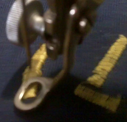

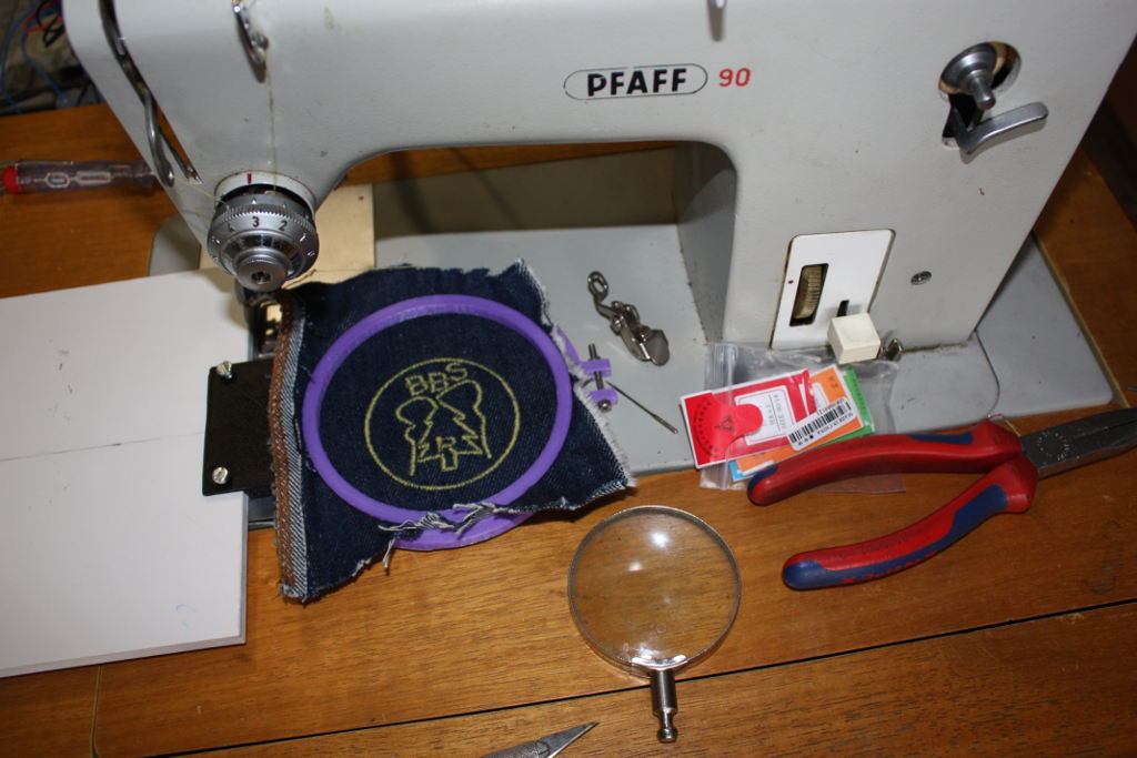

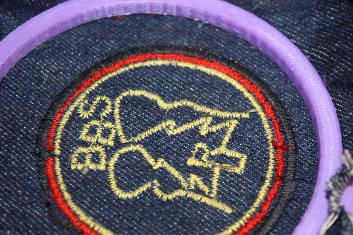

Hi
Corona Basement Cleanup
lots of CNC Stuff around AND a VERY OLD nonfunctional PFAFF sewing Machine
so i always need Batches to sew on Names or Logo this costs 30USD a pice or wait 150+Days from Bangladesh for 5USD
Why not building a Stichmachine myself XY with Digital in to get needle up Sig
lets do it and here is the first test result SMILE
the machine can do only 200stitches per min on a max 15mm steplength in Continues mode
BAD thing it has no Auto Cut off to go from contour to contour but it can do the 90% job i need
AXIS 2.7.11 on ubuntu 12.04 Fujitsu 7111
TB6600 24V China 5Axis BOB
G-code 2D Cad Gcode via Python script Wide and Steplength within MAGIC comment to choose

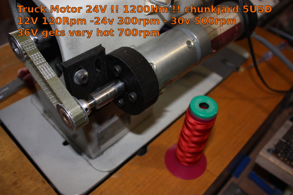

07 Jun 2020 02:24 #170438
by bbsr_5a
Replied by bbsr_5a on topic Grandma's Sewing goes Linuxcnc Embroid

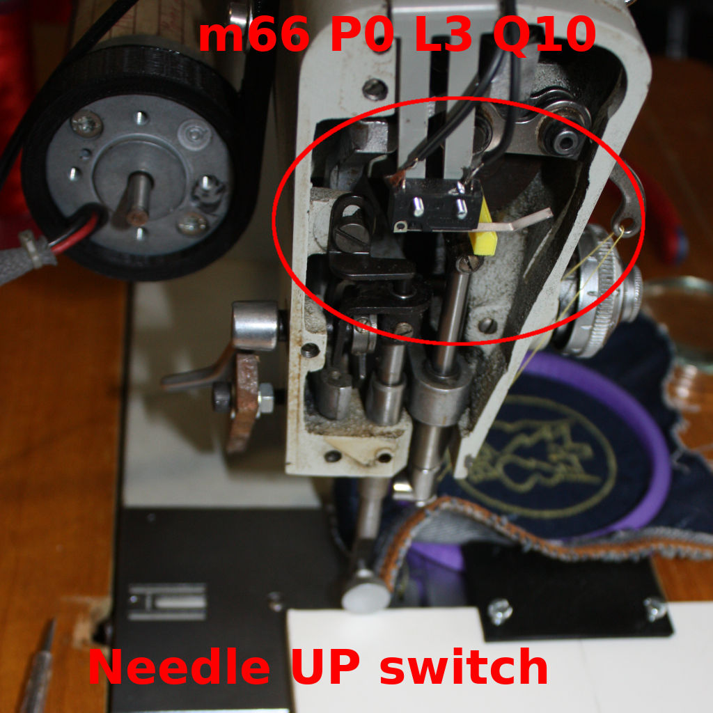

07 Jun 2020 02:51 #170443
by bbsr_5a
and here is the signaling for Needle up to get the next step
some code Example from the Python CAM
(Faden ein)
G00 X-15.5749 Y-27.0921
G04 P1
s100 m3
G04 P1
M66 P0 L3 Q10
m5
m00
G00 Z0.5
( G02 X-15.5749 Y-27.0921 I15.5749 J27.0921 F800.0 )
M66 P0 L3 Q10
G01 X-15.8 Y-25.9 F1000
G04 P1
M66 P0 L3 Q10
G01 X-15.609 Y-25.795 F1000
G04 P1
M66 P0 L3 Q10
G01 X-16.748 Y-27.677
G04 P1
M66 P0 L3 Q10
G01 X-16.184 Y-25.438 F1000
G04 P1
...........Attachments:
