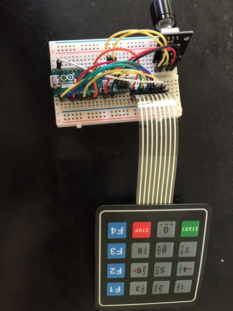

I’ve searched through the forums and could not find any reference to this so I’m passing on the information. Recently I’ve been working with an Arduino Micro on a project. While doing research I came across a Arduino library that can change a Micro to act as joystick.
github.com/MHeironimus/ArduinoJoystickLibrary/tree/version-2.0

I currently use a joystick (joypad) on my CNC mill and was curious if I could get the Arduino Micro working with hal_input on my mill. I loaded one of the example sketches for the joystick library and ran “less /proc/bus/input/devices” and got the following results:
I: Bus=0003 Vendor=2341 Product=8037 Version=0101
N: Name="Arduino LLC Arduino Micro"
P: Phys=usb-0000:00:14.0-8/input2
S: Sysfs=/devices/pci0000:00/0000:00:14.0/usb2/2-8/2-8:1.2/0003:2341:8037.0004/input/input19
U: Uniq=HIDHF
H: Handlers=event15 js1
B: PROP=0
B: EV=1b
B: KEY=ffff 0 0 0 0
B: ABS=7ff
B: MSC=10
I followed with
halrun
loadusr -W hal_input -KRAL Micro
Connected with no errors. Running “show all” revealed several pins. Here’s a partial list.

I then verified with halmeter that I was getting input pins to work, which was successful.
From there I breadboarded a membrane keypad, a cheap rotary encoder and frankensteined some code from various web sites to create an arduino sketch. Again, I verified that buttons and the rotary encoder worked with halmeter. I have not tried to move my mill with the encoder. I’m not sure what settings I would need to get it to work in a hal file but I will continue to work with it.
My hope is the someone will find this useful. Please let me know if you do.
