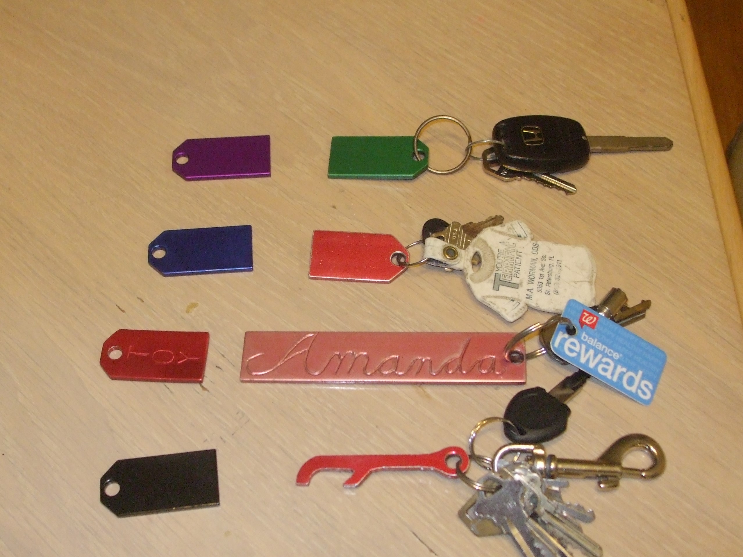

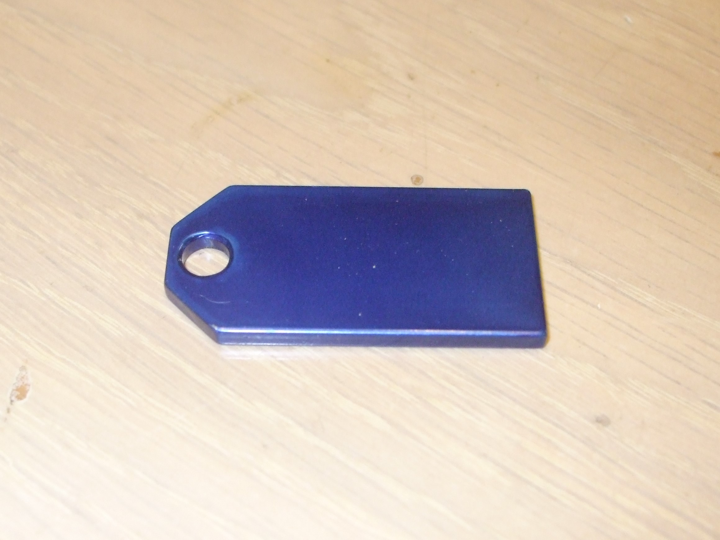

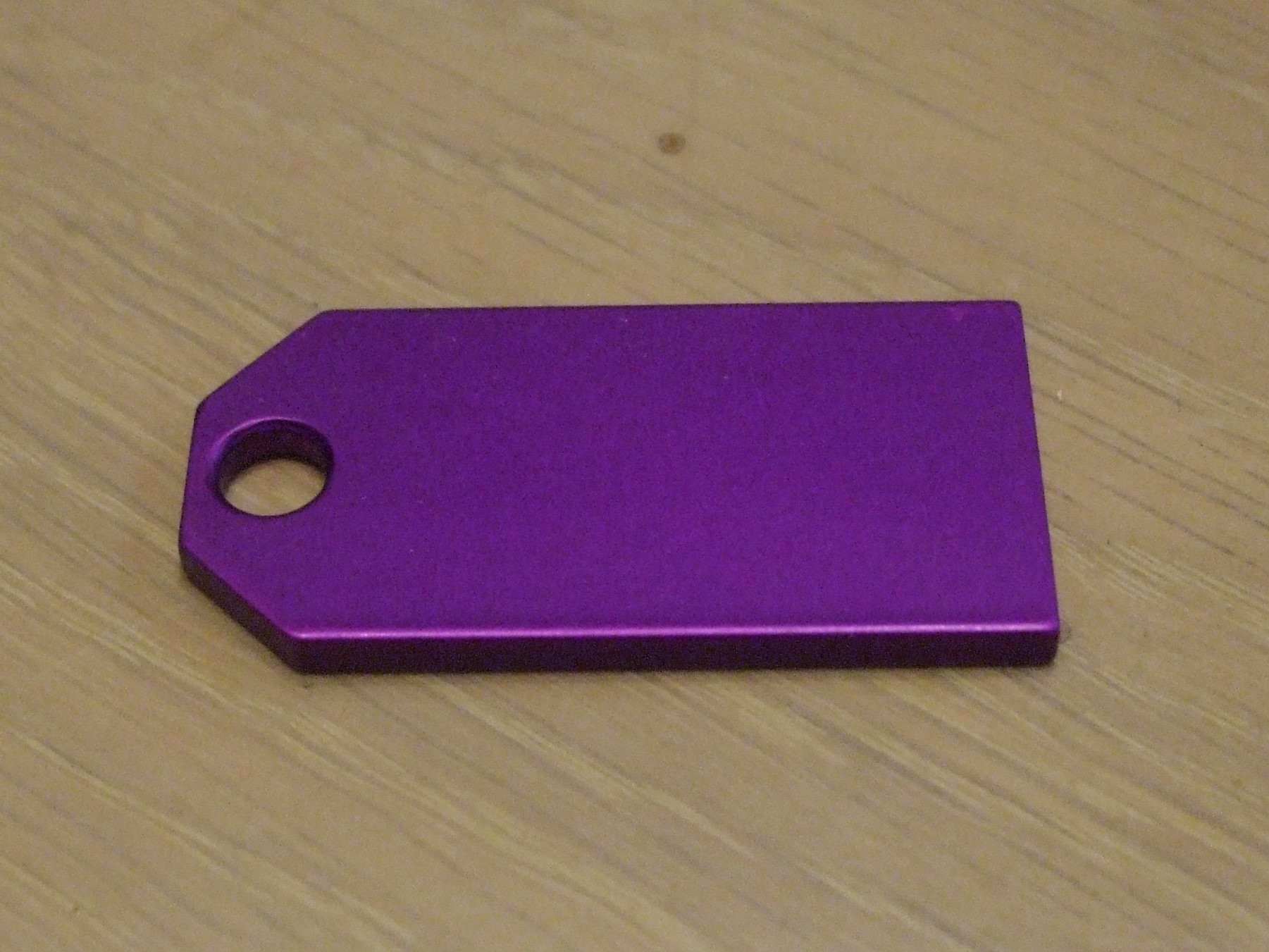

are you looking for pics. of various parts I have anodized or the equipment ?

04 Apr 2021 12:50 - 04 Apr 2021 12:51 #204755
by my1987toyota
Replied by my1987toyota on topic My Grizzly G0602 Lathe

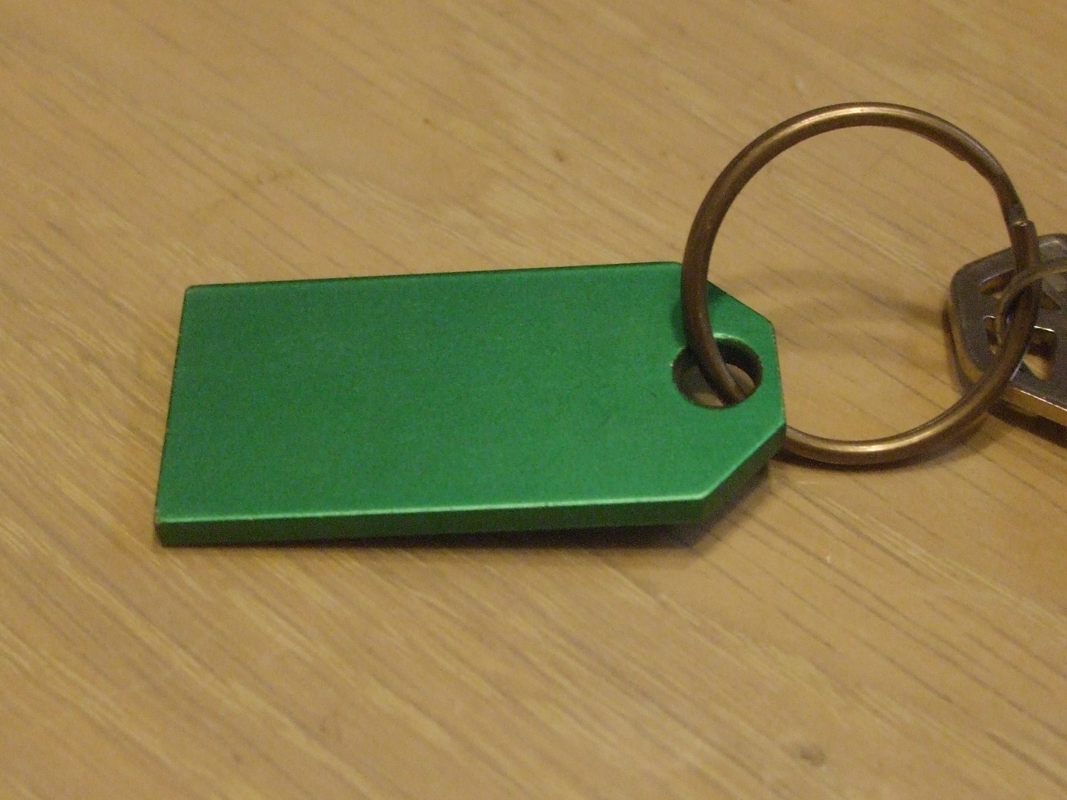

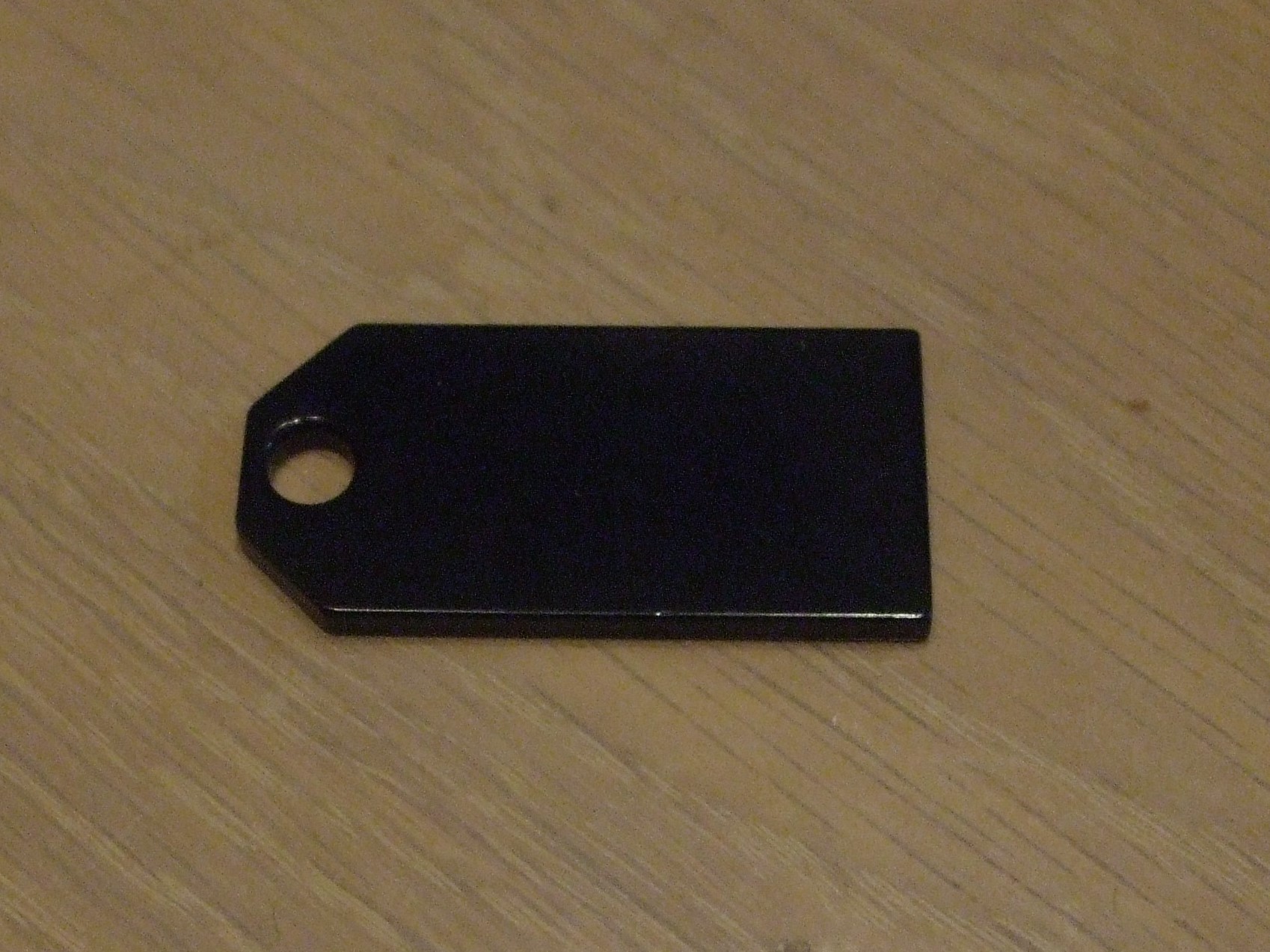

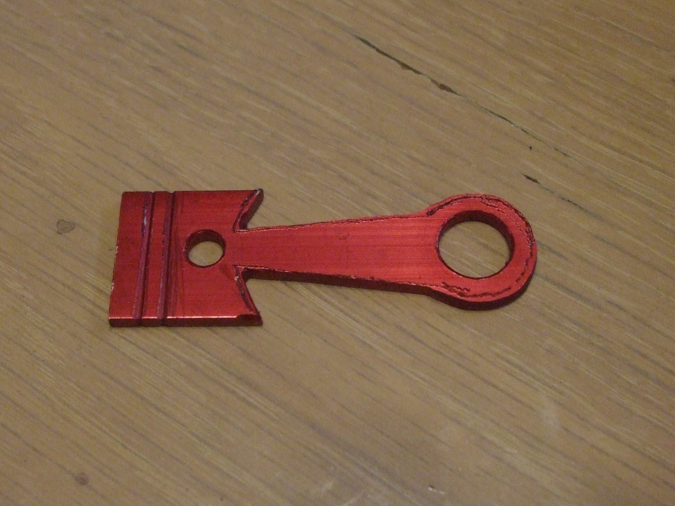

04 Apr 2021 16:31 #204776
Replied by tommylight on topic My Grizzly G0602 Lathe
Those are the kind of pictures i like, failures included.
Green and purple ones are perfect, the others have some minor artefacts most probably due to parts not being cleaned properly. Am i in the ballpark ?
Thank you, much appreciated.
- my1987toyota
- Posts: 1001
- Thank you received: 447
05 Apr 2021 00:41 #204832
by my1987toyota
spot on .
I think one of the blems was because I was using aluminum flashing for the cathode material at the time
( I don't anymore ) and small bits of plastic from the protective coating would break off and stick to the part causing
small areas to not anodize. Hence the reason I use pump circulation combined with filtration to make sure
nothing is floating around in the tank.
