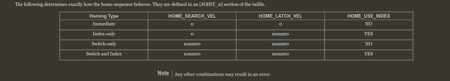

20 Mar 2021 11:53 - 20 Mar 2021 13:18 #202968 by Aciera
The Clearpath motors have a built-in programmable function called 'Accurate Homing' .
I see that will complicate things a bit.
So, just to make sure we are on the same page:
Were your axis homed when you tried to jog?
[edit]
With homed I mean in LinuxCNC (Homed symbol in the DRO)
[edit2]
So considering your homing set up I don't really see all that much of an issue with manual simulation the home switch, my apologies.
There has been a discussion about homing done by the drives. I'll try to find it.
[edit3]
Ok according to this (linuxcnc.org/docs/2.8/html/config/ini-homing.html):
to set up for immediate homing you would need to set
HOME_SEARCH_VEL = 0
HOME_LATCH_VEL = 0
HOME_USE_INDEX = NO
HOME_SEQUENCE = 0
Are your drives sending the position back to LCNC (eg by encoder output)?
[edit4]
The only way I see is to connect the 'homed'-signal from the drive to the index input. But for that to work i think you need to set a latch_velocity:
HOME_SEARCH_VEL = 0
HOME_LATCH_VEL = 0.1
HOME_USE_INDEX = YES
HOME_SEQUENCE = 0
The problem is that the stepgenerator will put out steps which is what you don't want. So I don't have a solution for you at the moment.
Maybe you could try the above with HOME_LATCH_VEL = 0? [doesn't work, just tried it on my machine ]
[edit5]
one way might be to loop the pid.N.output back into the pid.N.input and disconnect the stepgen in HAL using a multiplexer (mux2) and using the joint.N.homed for the select input. Not sure what happens once the stepgen is reconnected though, following error?

20 Mar 2021 13:46 - 20 Mar 2021 13:47 #202979 by Aciera
See link in edit3 above.
HOME_SEARCH_VEL = 0 => don't look for the home switch
HOME_LATCH_VEL = 0.1 => move at 0.1 machine units/s in the positive direction until the index signal appears
HOME_USE_INDEX = YES => look for the index
HOME_SEQUENCE = 0 => first joint to home
In your INI file each [joint] has it's own homing configuration. This would configure your joint to use 'Index only'. The index here would come from an encoder that is going back to LCNC. For example linear glass scales.
Last edit: 20 Mar 2021 13:47 by Aciera.
