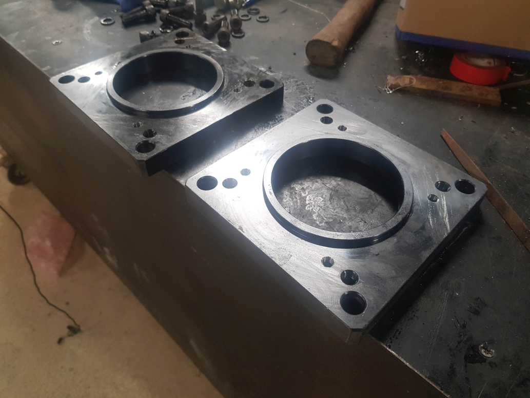

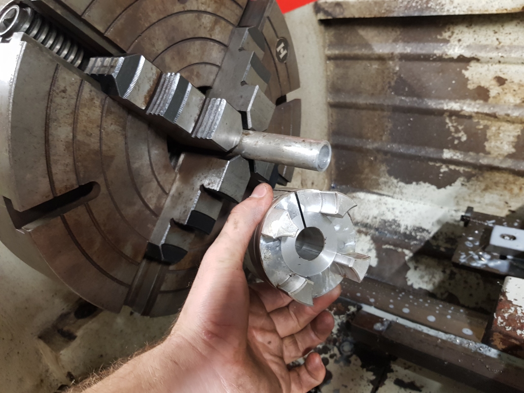

machining adapter plates to mount new motors. One trick I learnt last time was if the bolt holes don't fit then don't make new adapter plates. just rotate motor 5 degrees and redrill hole pcd. easy as. and if the spigot doesn't fit just either machine it out or reduce the size with a reducer spacer ring if needed.

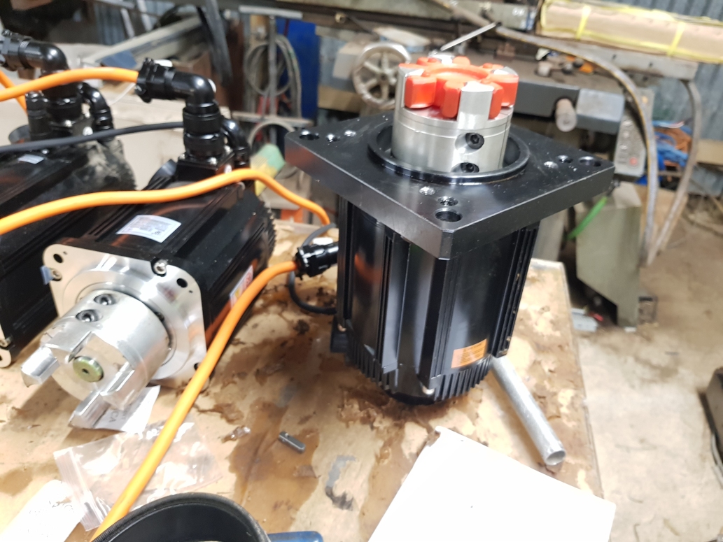

machining aluminium split ring to reduce the coupling dia from 24mm down to 22mm to suit new motor shafts. the size and finish on this spacer has to be pretty good to achieve a good strong fit that won't give me problems in the future. there is no keyway just friction. but it locks up so tight I will have no issues
motors mounted

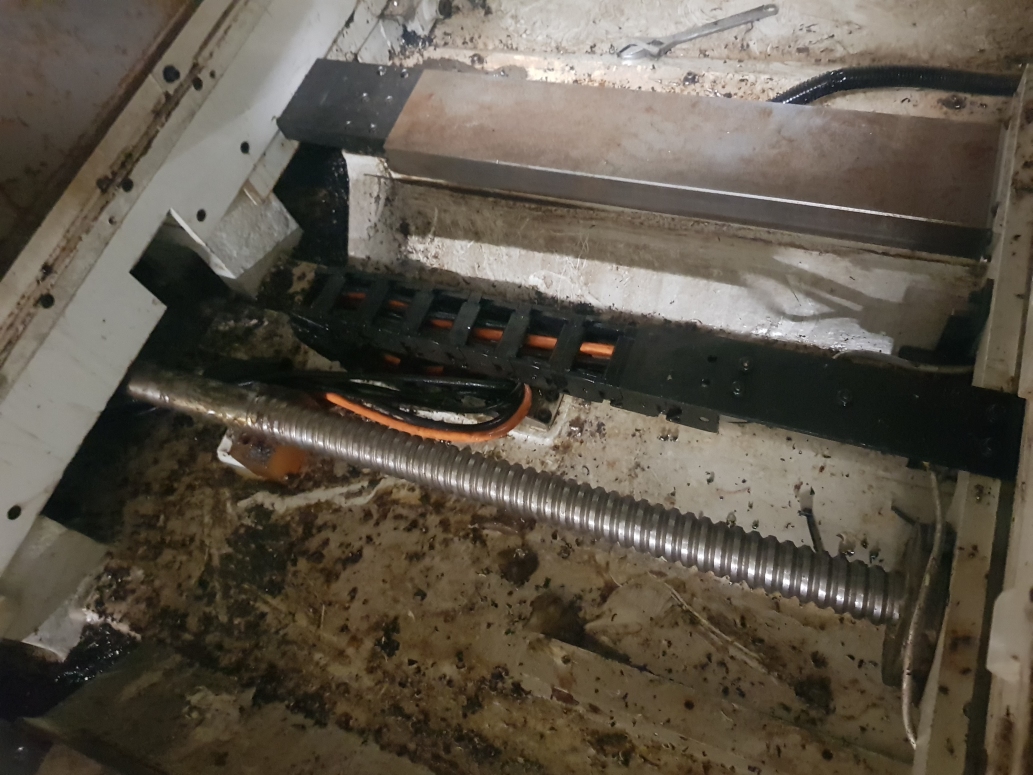

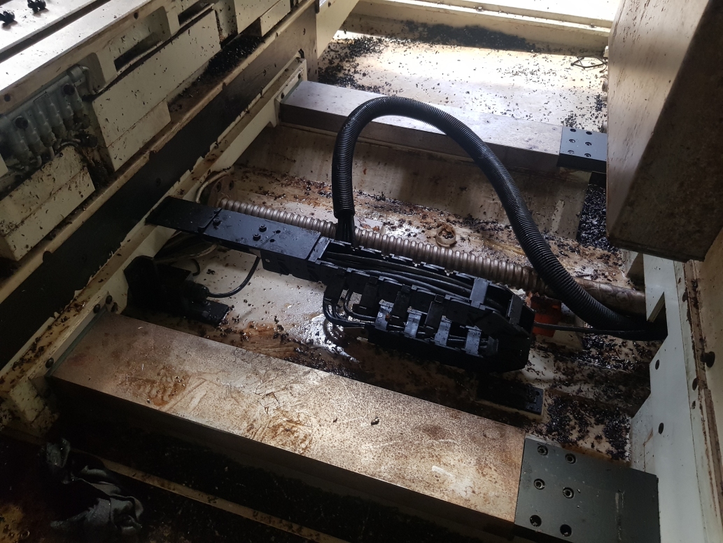

Now tonight I was running the new servo drive cables and getting them through the flex conduit

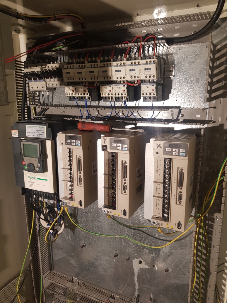

view of back panel showing mounting of drives
a battery impact driver and self drilling and tapping screws make this so much easier than drilling and tapping

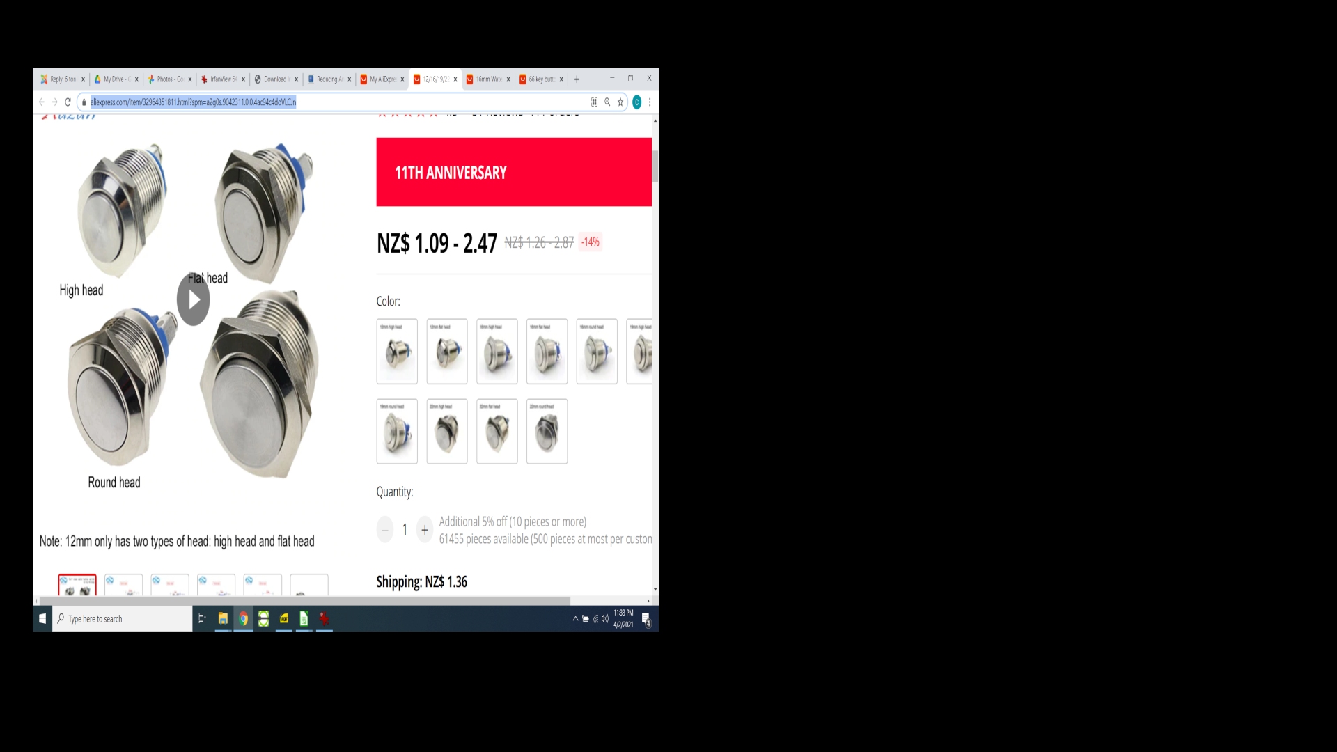

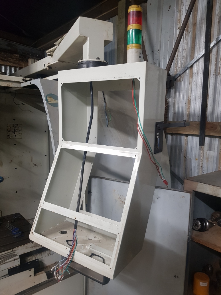

and view of the front control panel before I gut it to mount my new monitor (still need to get one lol)
also have 30 nice stainless steel buttons coming from aliexpress that will hopefully do a good job here
one thing that you can see if how there is only one cable coming over. I still need to bring the vga, the usb cables and the 7i84 ethernet cable. but the mesa hardware is so nice for reducing how many cables are needed. big shout out to PCW I love your stuff
and this is just a view of the cable I have left in here. I think I will just use this cable for the 24v power that the 7i84 needs and also run my E stop loop through this. (E stop won't go through 7i84 card just for safety. I often get inside machine once I push the e stop and I want to be able to trust my life to this and don't trust a computer for that so the E stop has to be hardwired.

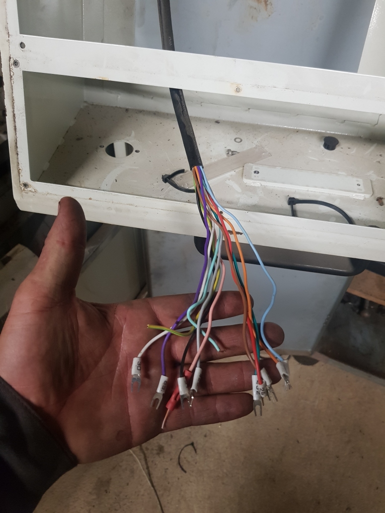

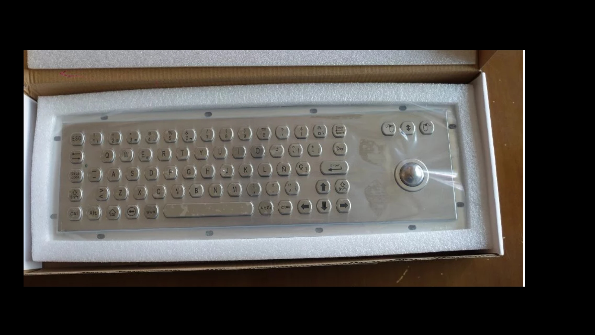

this is the keyboard I want to use I think
they are 90 usd plus shipping but should be quite nice and I am over cheap keyboards that get coolant on them and look so bad
this keyboard link will probably stop working
metal buttons
colored metal buttons
hopefully it turns out ok
metal buttons

I took a break from my machine and fixed a customers one a few weeks ago. machine is making parts now. not toolchanger so pretty easy machine.
as usual using all mesa cards
original machine had a centroid controller and I was able to reuse all the servo drives etc it worked great
hopefully people are following along and this build thread helps someone.
or for the guy looking at this in a few years hopefully it is helpful
anyway on to photos
