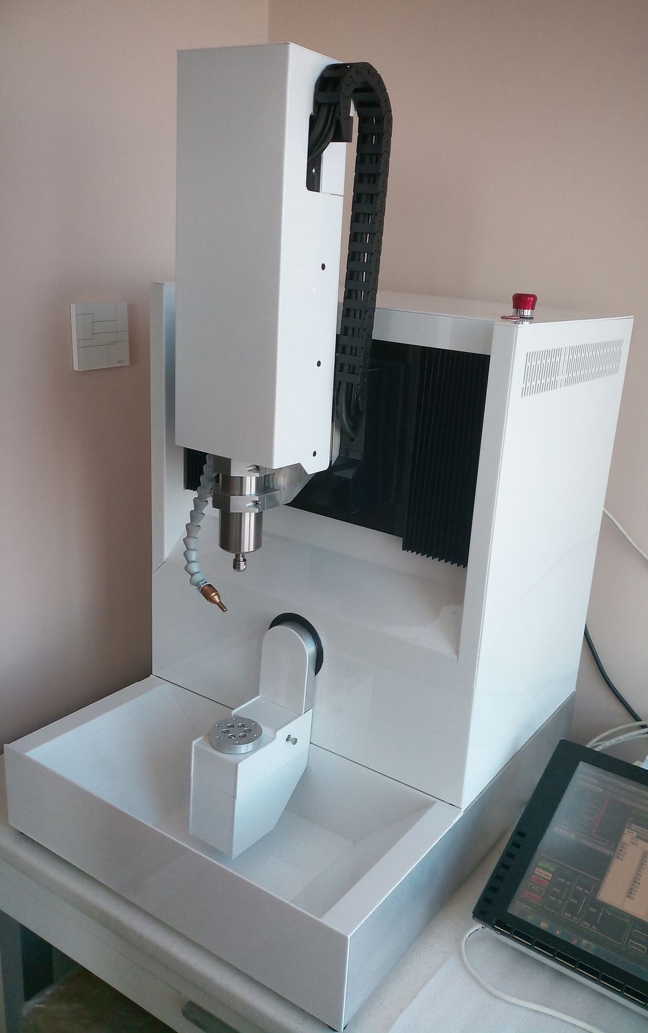

29 Mar 2023 03:14 #267779
by Mr. Mass
Replied by Mr. Mass on topic CNC router from industial scrap

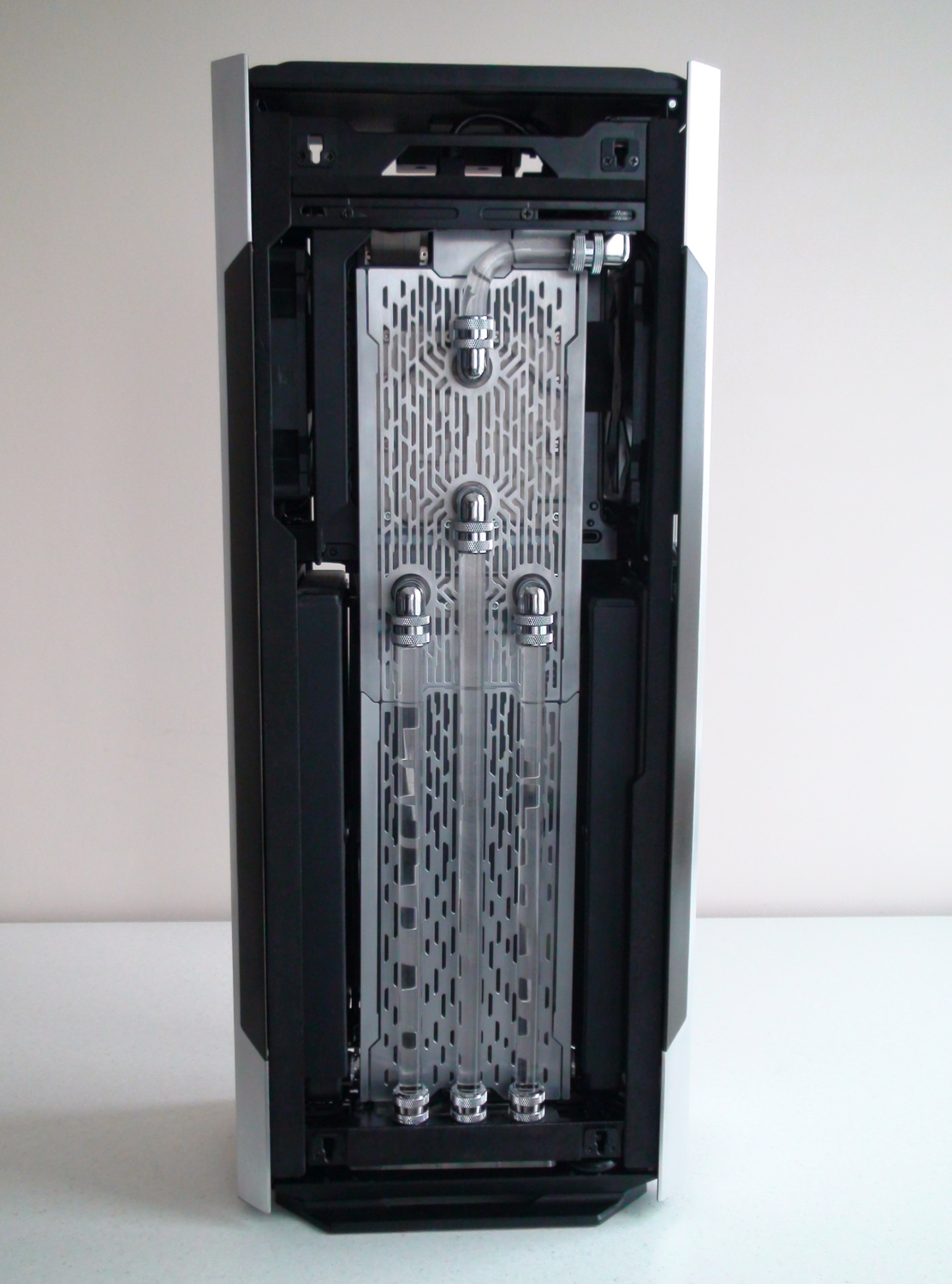

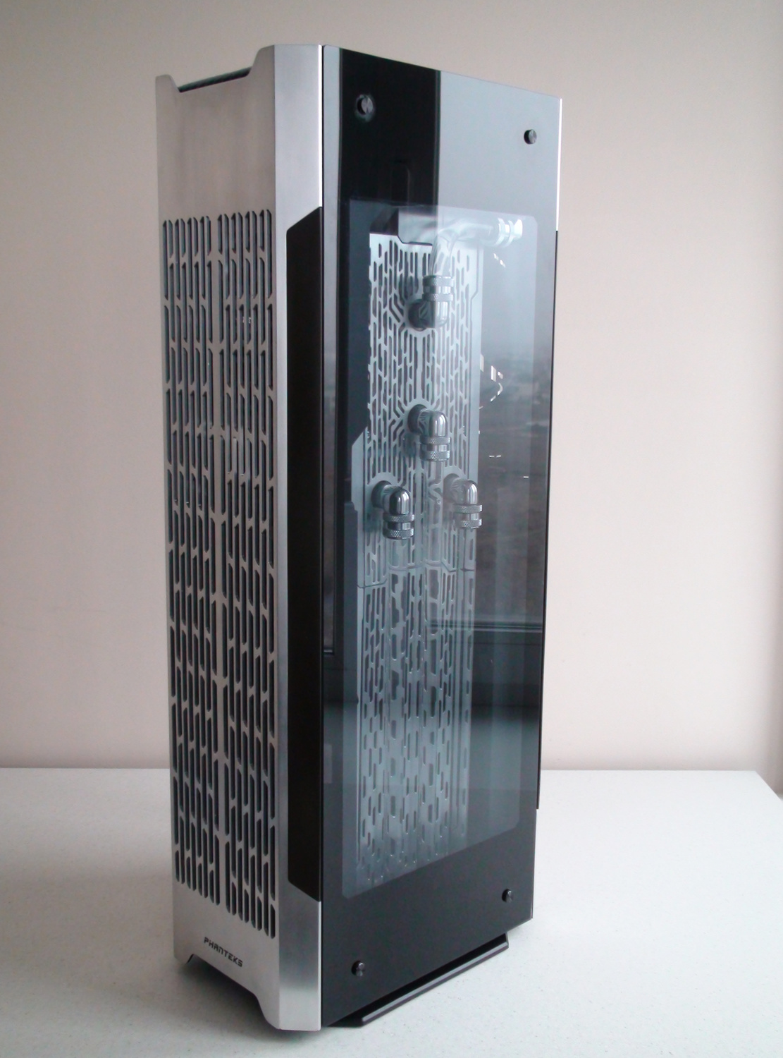

I haven't posted anything for a long time, but I haven't been idle, and I've been able to do some interesting projects over this time.
The first project was a deep modification of a computer case with custom water cooling system. It was a very challenging job for me, many things I did for the first time. Starting with the general idea, the design, the making of all the details and the final assembly I did by myself. I gained a ton of experience from that case and now I'm not afraid to take on complex projects.
More pictures here - ibb.co/album/4snsH2

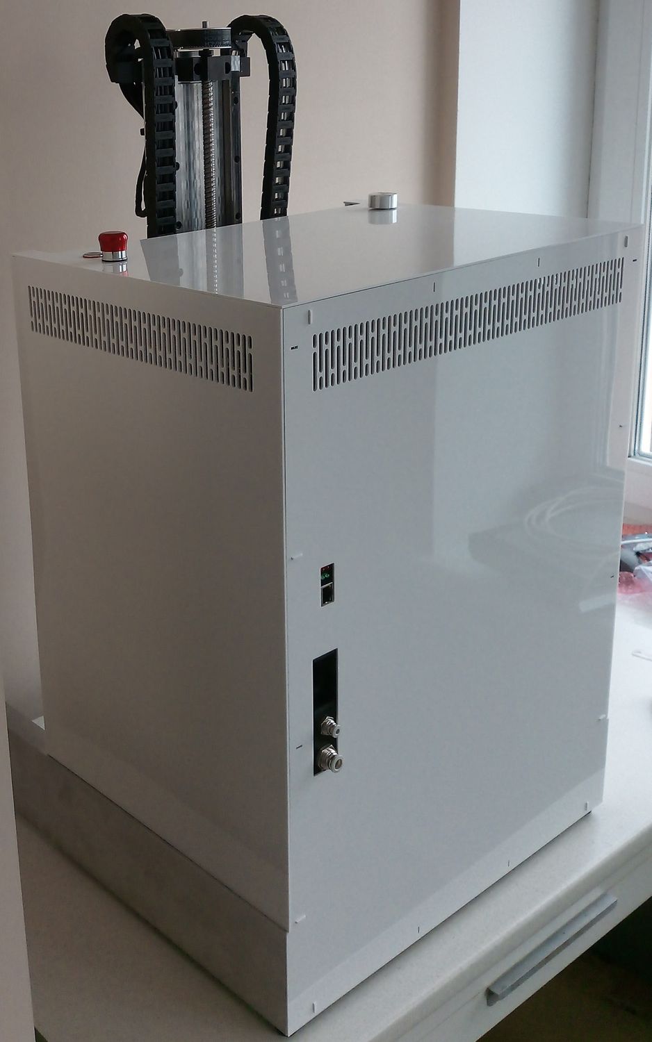

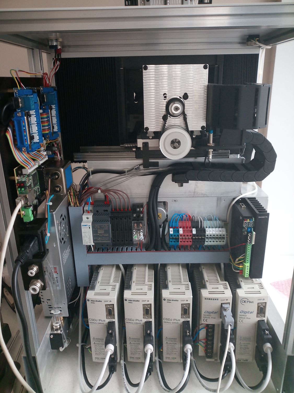

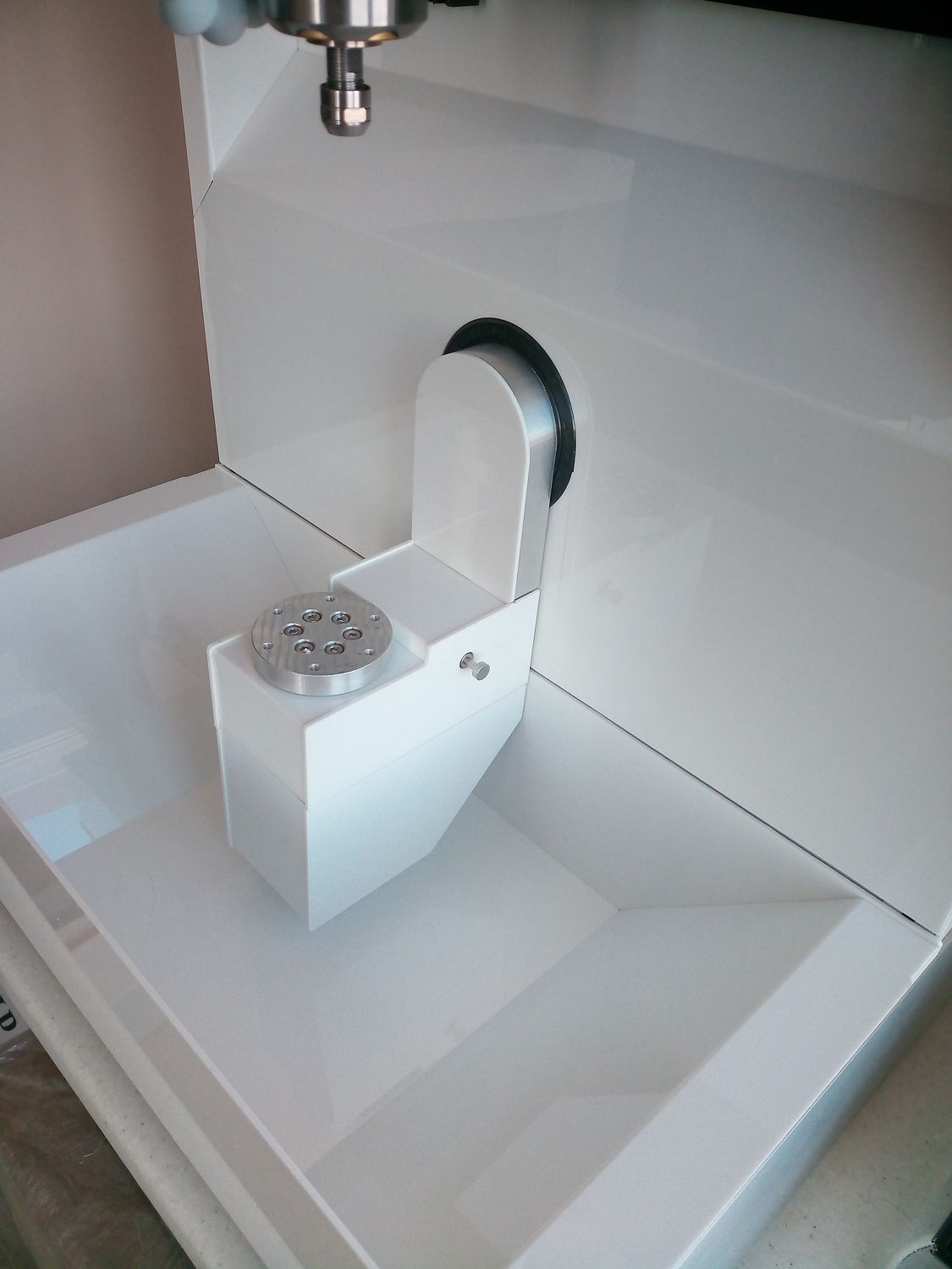

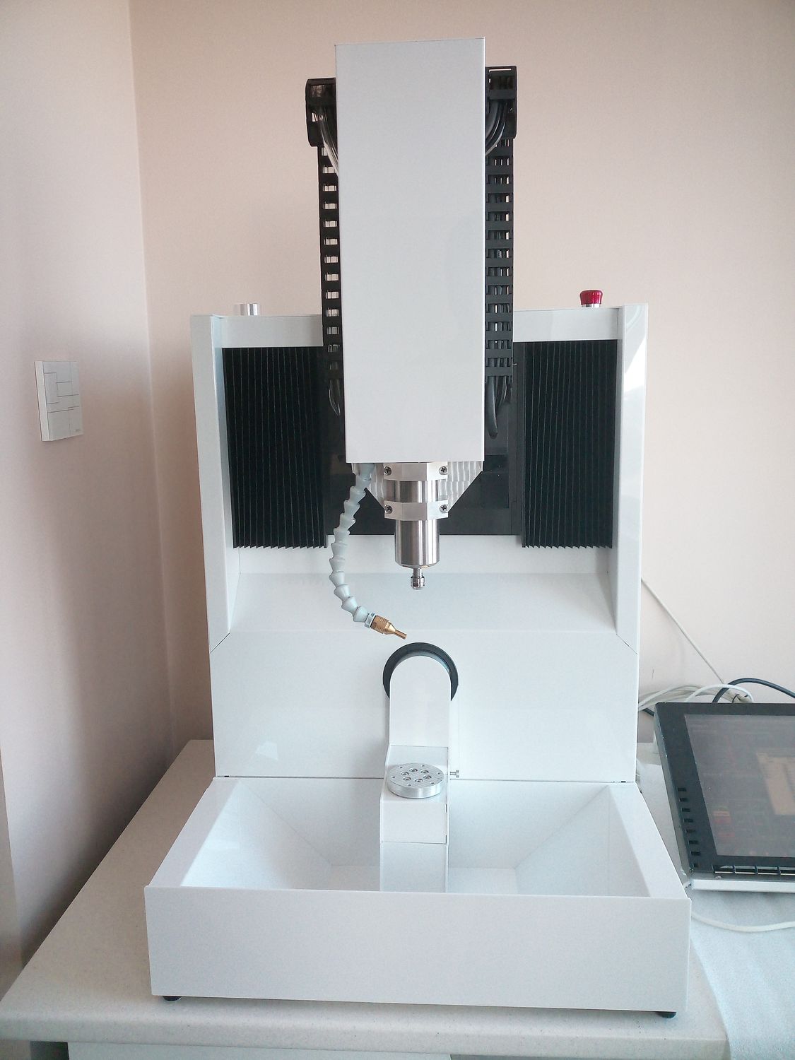

The second project is a 5-axis machine to make wax models for jewelry. Similarly, all design, manufacturing, assembly and adjustment was done completely by myself.
