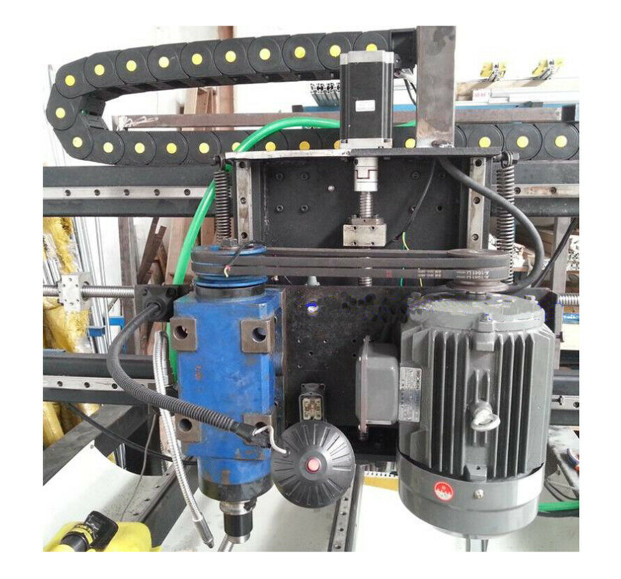

I decided to have bt-30 spindle but not clear on the motor
AC- servo or induction motor. The induction motor seem heavy and I have 16 mm ball screw on the Z-axis
The other thing do I need to sink the frame inside concrete to be able to mill mild steel with 8 mm tool
I will appreciate any critiques
Philip

You can add an air cylinder as a counter balance for the weight of the spindle. If it's sized correctly you can dial it in with air pressure to get it balanced. You can always add a larger stepper / servo or gear reduction if the performance is not good. For possible lack of overall stiffness, mount an indicator and push/pull on the frame to see what flexes the most. Add bracing where need if needed. I would add a thick spoiler plate to your table or some T-slot table if you can find it. At first glance, the table looks a bit thin to me. Also, the round rail will be the limiting factor for overall stiffness. I would measure their deflection first.

Induction motors (especially aluminium-frame ones) are lighter than they look. They have about the same copper weight as a servo, but the rotor is a hollow cage rather than a bunch of magnets.
This one is 2.2kW and 15kg: inverterdrive.com/group/Motors-AC/Universal-UMHA-90L-2-B14/
This servo has approximately the same rated torque, it is about half the mass, but rather expensive: inverterdrive.com/group/Servo-Motors-AC/...otor-SSD-Drives-ASB/
Of course, itf you are not buying new then you can probably get the servo cheaply.
Also factor in the price of the drive.
I don't think that you will be needing low speed torque?

No eBay APP ID and/or Cert ID defined in Kunena configurationHi Andy
Thanks for the usefull post
What do you think about this from ebay
I opened acount with universal motors. I like the 3-phase induction motor in the link. It should work with the Huanyang VFD.
the ac-servo as you mentioned, I still have to buy a driver(Not sure how to spec the driver). And I am woried also about the complexity of the AC servo motor feeding the encoder signal to the driver and making sure the signal volt matches the input-pin of the driver.
15 kg is not bad.

This guie in the attachment is counterweight with springs. Never thought of the counterweight untill you mentioned it. Not sure this spring arrangment will work, because there will be position along the Z where the full weight will still be on the Z-screw balls, and partialy on the motor torque.
