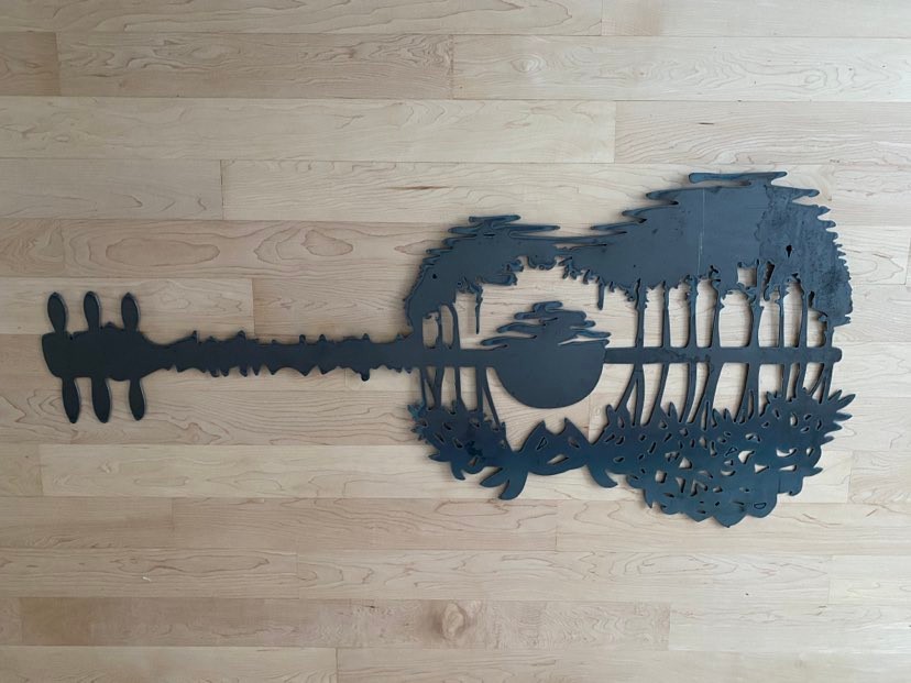

29 Oct 2021 12:17 #224643
by bevins
Some Plasma Art was created by bevins
- snowgoer540
- Posts: 2579
- Thank you received: 905
29 Oct 2021 12:23 #224644
by snowgoer540
Replied by snowgoer540 on topic Some Plasma Art
Looks nice! Lots of pierces and small moves there, always a good test of the works. I bet that outer cut was satisfying to watch. Glad it's working well for you.
- bevins
- Posts: 1947
- Thank you received: 338
29 Oct 2021 13:02 #224647
by bevins
Replied by bevins on topic Some Plasma Art
Yeah thanks. I thought it would have been a good test. Buit, the plasma blew a breaker half way in and QTPlasmac paused. I switched the breaker to a 40amp breaker and turned it back on. When I resumed with QTPlasmac, there was a 5-10 sec delay and I cant figure out where that came from whether it was QTPlasmac or the propcut-55. It has happened twice and I dont know where the delay is. Other than that it is working good. I still need to work on the thc as it is not going good, but as Phil stated I have to fix my speed in ini file. That I have left to do. The customer is really happy though.Looks nice! Lots of pierces and small moves there, always a good test of the works. I bet that outer cut was satisfying to watch. Glad it's working well for you.

QTPlasmac got a valid lost arc from the procut, so it stopped moving. I had to hit pause and resume, after I repowered the procut plasma. Then 5-10 seconds after it started up, so I dont know where the delay is. Not a big deal, just wondering and I was amazed it restarted right where it left off. kinda cool. I have a feeling the delay is in the procut. I can test it and look at when QTPlasmac sends the torch on signal and how many times it does that if I recreate the scenario.

29 Oct 2021 19:45 #224669
Replied by rodw on topic Some Plasma Art
Looks great!
With a lot of pierces, its possible the plasma cutter overheated and dropped the arcOK. I have had that happen once with my Thermal Dynamics 120 amp machine. Its rated 100% @ 120 amps and I was only cutting 2mm@ 40 amps! Like your experience, once it cooled down, resuming cutting was seamless. I think a lot of pierces close together is not factored into their duty cycle specs.
I've also had similar faults on low air pressure when the breaker on the compressor tripped.
Next time it happens, check if there are any warning lights enabled on the plasma cutter. Both times my plasma cutter told me there was an error.

So I got the ini file all fixed up and the thc is working pretty good now. I tried tracking down that delay issue and.....
I am prettty sure it is in the pro-cut as I seen the QTP send torch on three times before the procut started the arc after a delay.
