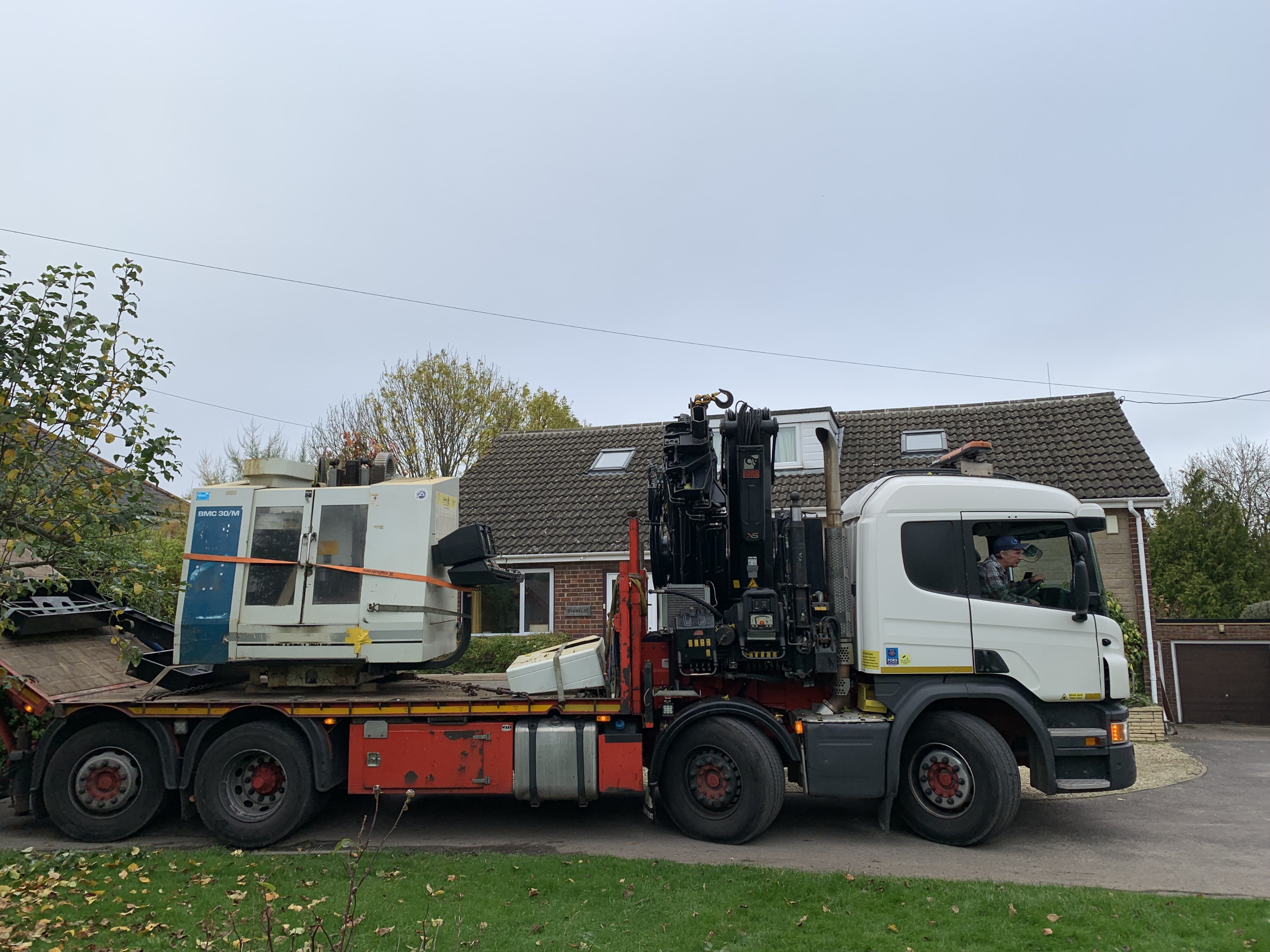

Hi everyone,
I would like to share my CNC build and where I am currently at with my project.
I am working on an old Hurco BMC30/M. Below is a photo of the BMC arriving at my home.
I have now stripped the machine down to just the column and bed, I am waiting for a crane to dismantle it further.

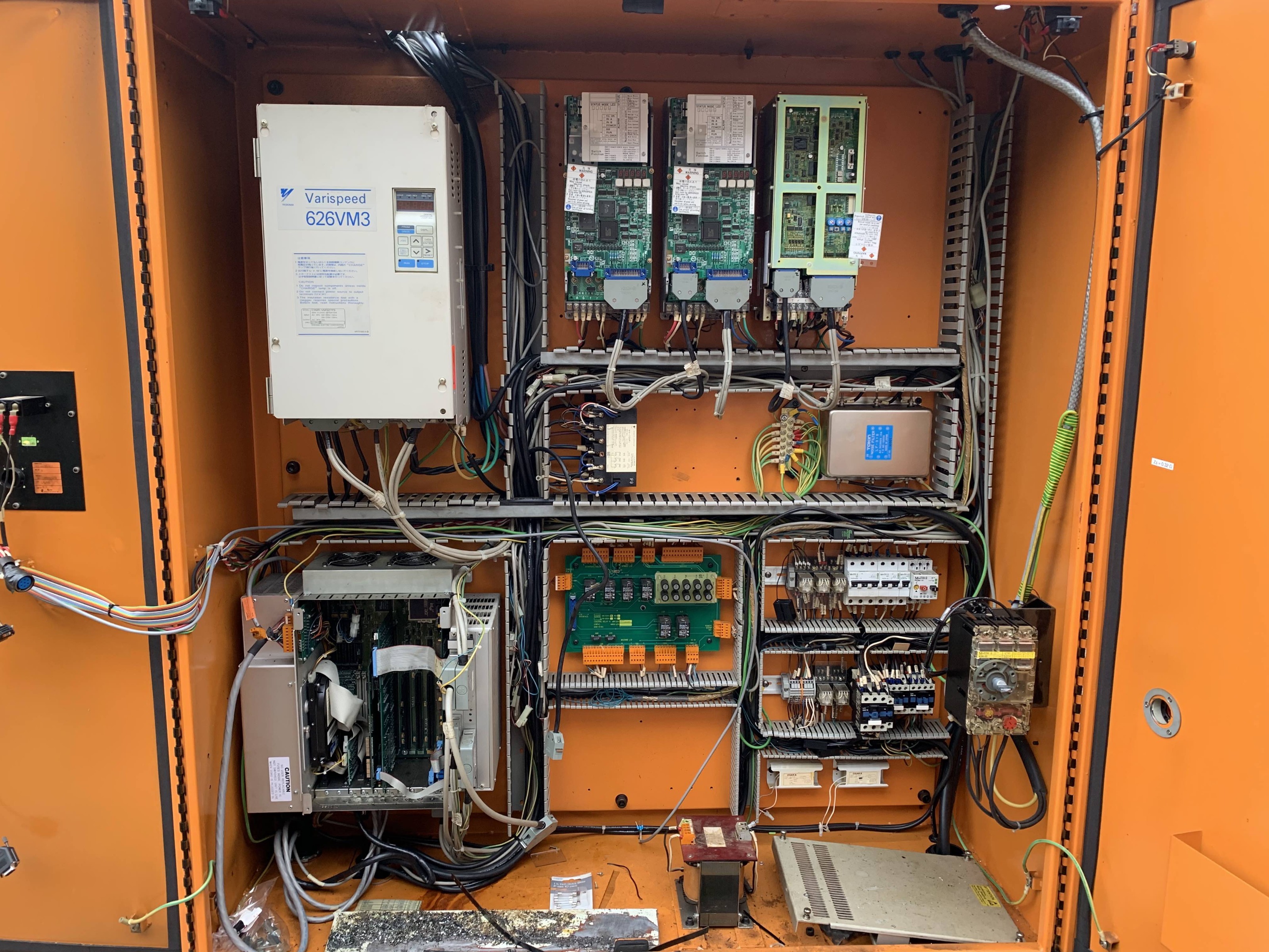

Below is an image of the old electrical cabinet, I am replacing all of the parts and am planning to make the machine a single phase machine.

I would try to use the existing drives, they are very good as long as they work properly, especially i would use the spindle drive, anything close in performance costs in high 4 figures. Also has spindle orient built in.
They are also very easy to tune, like 3 minutes in total.
The only bad thing is they use proprietary encoders so if changing the drives, they must also go, not easy to remove them at all.
Also do not remove the green relay/fuse board, that is the tool changer control with interlocks.

Hi Tommy, Thank you for the advice but I plan on making the machine single phase and selling the components such as servopacks, motors and spindle-drive.
I hope that this plan sounds okay and will provide me with a very rigid and inexpensive machine, even if it does mean losing some of the power that the machine once had.
