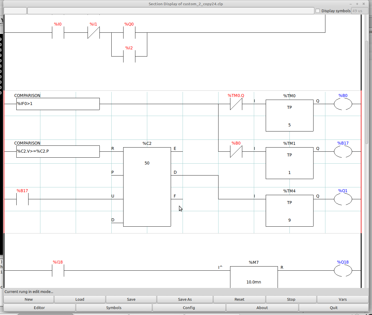

Hey guys
Just thought i would spend the time here and post up this lube pump classic ladder drawing. This is for my own future reference too lol. I keep forgetting the finer details of linuxcnc lol
This is made to go with the standard habor or chinese gear pump lube pumps you can buy that come standard on most machines
they need to be pulsed on for about 10 secs every 10-20 mins of operation
all my cnc mills and cnc lathe uses this type. plus this should work on the cnc router grease type that runs on air like the biesse or scm machines
anyway here we go
I am going to make this as simple as I can for those just learning
At the top left hand corner of the highlighted ladder program is a comparison function. you need to copy the Syntax exactly. Even tiny differences will cause it to fail. you can look up the classicladder docs if you want to see what they all do. But anyway back to the first comparision function.
The comparision function is linked to motion.current;vel pin with a signal(eg custom signal name bla bla bla) The little equation makes the comparison turn on when the machine is moving
The timer starts when that happens and resets itself making a 1 sec pulsing signal for the counter. This means that once the machine stops moving the timer stops counting up but holds the current value. once it moves again, it carries on counting up and then turns on lube pump
You should be able to just copy this exactly. Connect up your physical output pins (eg mesa card or PICO systems card) to classic ladder output number 1. Then you are good to go.
if you need help with classic ladder just let me know. i have both a lathe and mill running the toolchanger on classic ladder and it works great.
this coupled with custom Oword gcode files that you can call is all you need i think to do most things
Edit
the first timer TM0 has a value of 500 milisecs
the rest are just in secs i think so you can see the values on the screen
Regards
Andrew

The following user(s) said Thank You: tommylight, silopolis, spumco

Could you describe IF0 is for?
