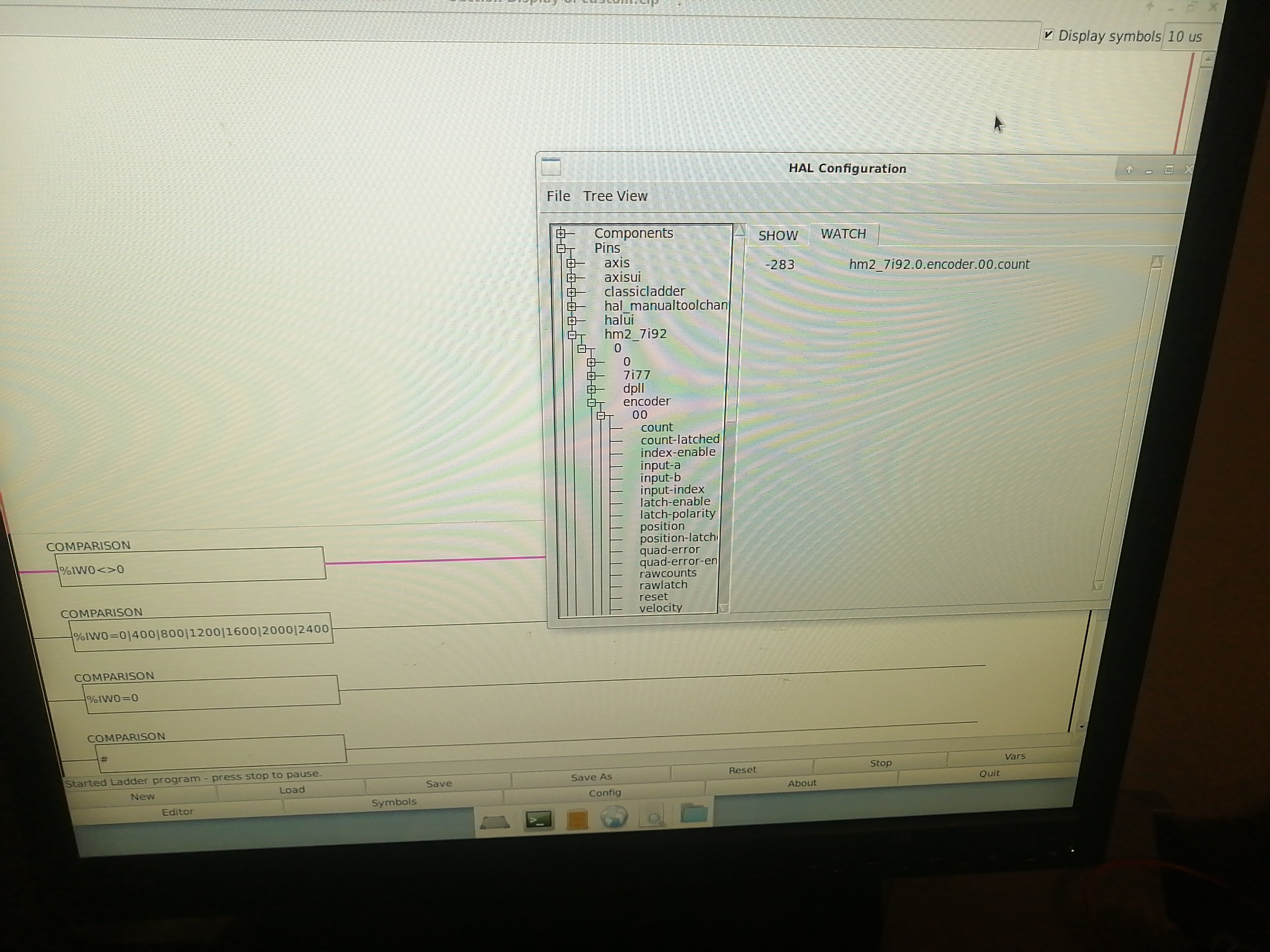

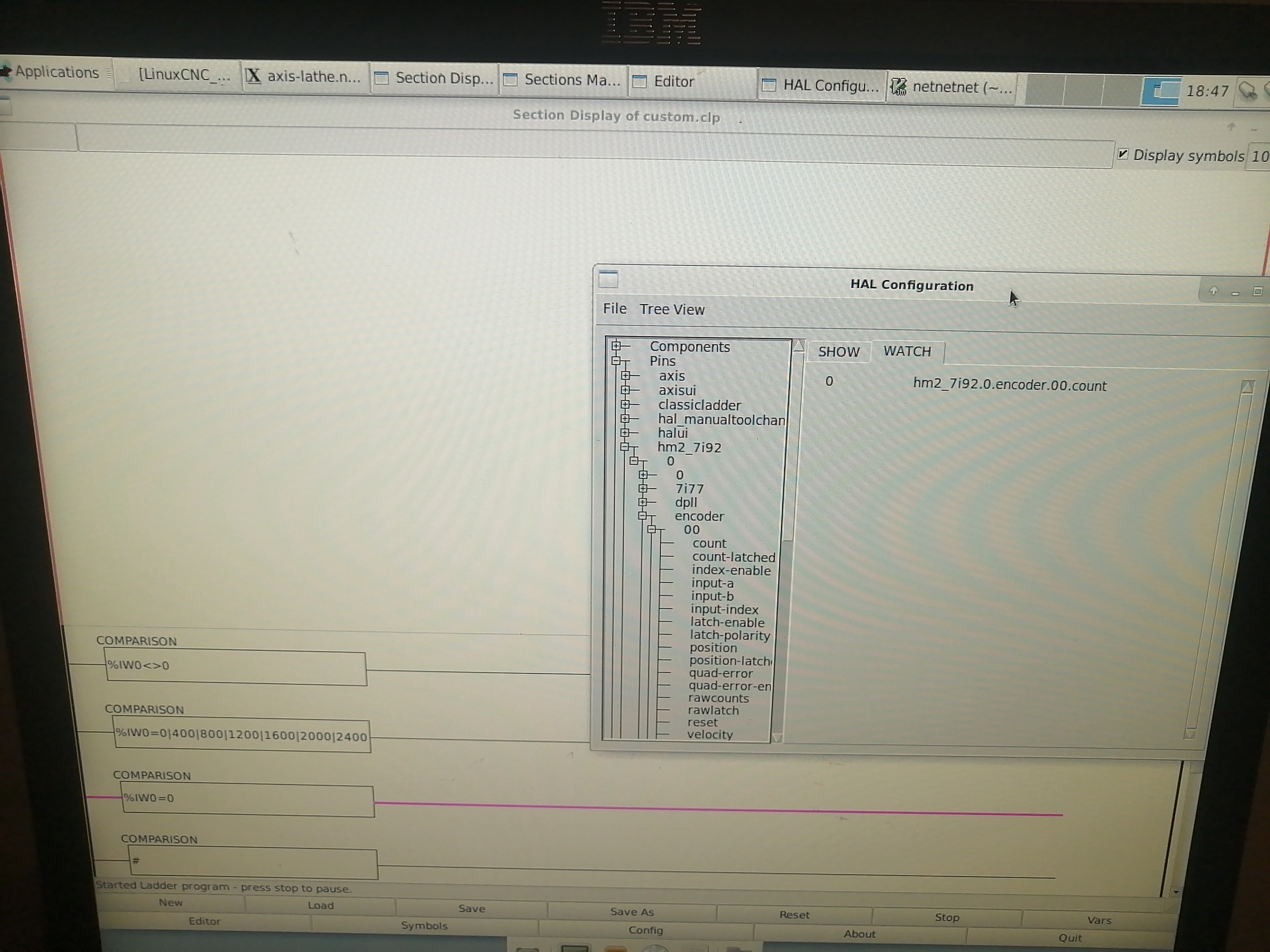

25 Dec 2022 17:56 #260293
by Patrice
Replied by Patrice on topic im stuck with the retrofit ikegai fx20n 6t model A
- Patrice
- Posts: 15
26 Dec 2022 13:12 - 26 Dec 2022 14:25 #260337
by Patrice
i have new issue, i set my encoder to output synthetic pulse in middle stroke( put index reset with index-pulse, for the toolchange in the turret at T6) , if the filter it's set 1 need 15 clock but it's set 0 need 3 clock , i give a try by hand but sometime , the count pass through i think i will go set or not a precise value just a field of 5 or 10 count i have 600ppr(2400 counts) encoder with pulse for the turret , i set the index in tool 6 , to give i time to slow down the turret and clamp on T1 , if you have some advise to make sure my issue didn't come back, i can set over of 2400 cout reset count but i think need greater field on. I should remove filter but not sure that change anything, i will go to modified the field of synthetic pulse. relatif encoder with pulse
set 200 to 600 T1
set 600to 1000 T2
set synthetic pulse 400 for T1
set synthetic pulse 800 for T2
the synthetic pulse it's for hey im in position to clamp (with parity tool on turret and ask command)
if x=y you need clam, pulse signal give a signal for clamping
turret have 2 speed rotation, whan parity the speed go down prep for clamp
set 200 to 600 T1
set 600to 1000 T2

i will try base-thread , i have put abs() to ignore scale -1 if i am not in the good direction, i need to press more save button i need to rework my cl , i make a little progresse , learn a lot, thanks all for the rich documentation, nice support nice people, need save net more frequenly , crash many time in cl and hal, tkx all
