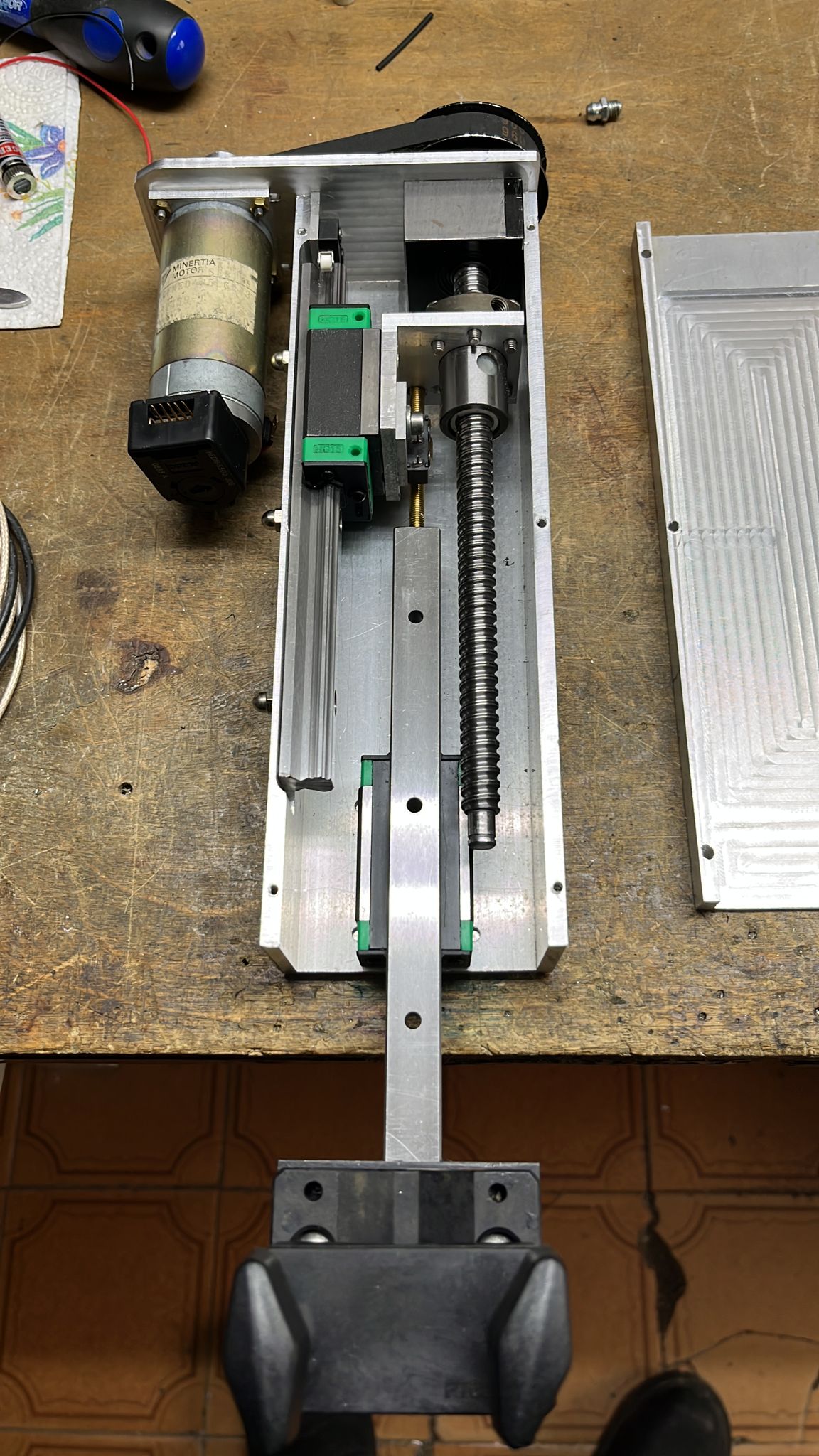

  hi, i made a new floating z axis, it looks very compact i just have to try to cut. if anyone is interested to get an idea.
regards
Mauro

Very nice, thank you.
But, might want to use some shielding for those cables before firing the torch.

surely ! I just adjusted the motor and tried the movements.
