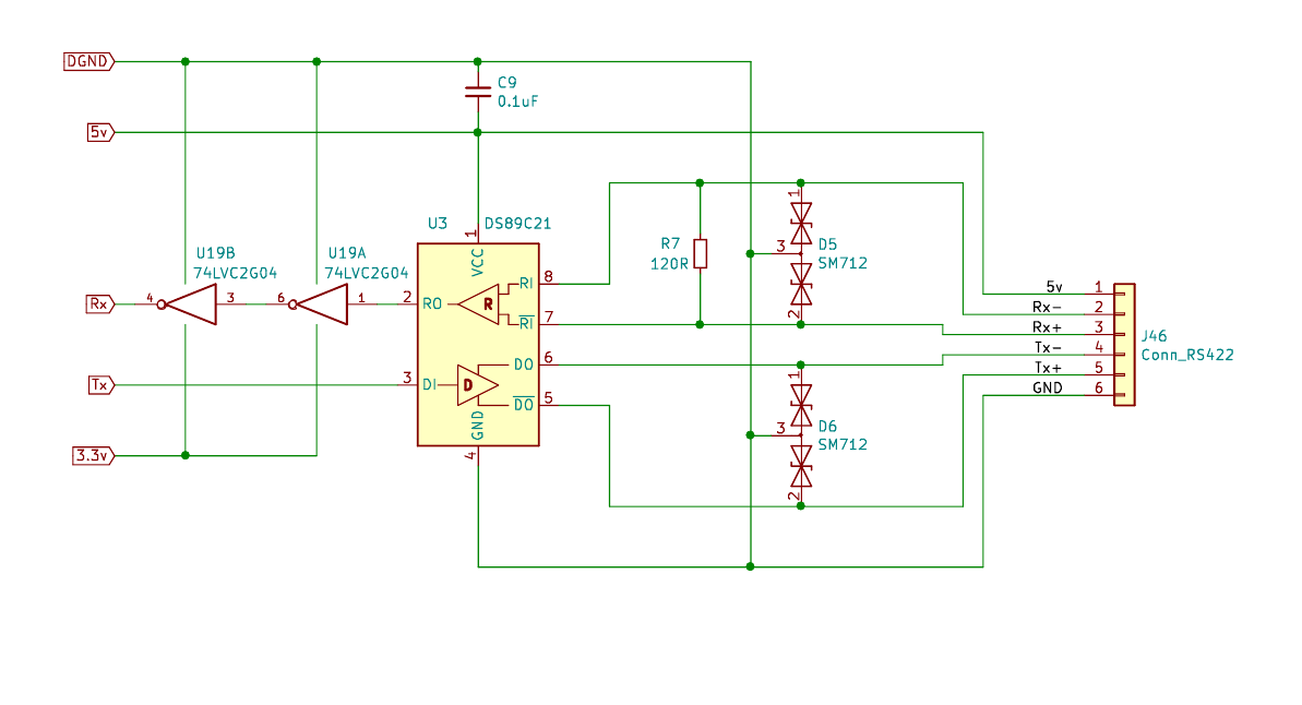

I've got a few Mesa Smart serial cards, not sure I have any time to test though these things have been in drawers for years.
Regarding your ESD protection, I designed a carrier for a DE10 Nano for Machinekit years ago that had smart serial and I used some TVS diodes on the lines. This was like the first PCB I ever designed so take it with a grain of salt but IIRC everything worked pretty well including SS. github.com/ShadeTechnik/socfpga-developement-OSHW
I pretty much dropped that thing when I realized MK was a bust.
You can see there I'm using a tranciever. The dual inverters are used as a level shifter which is a trick I think PCW gave me.
