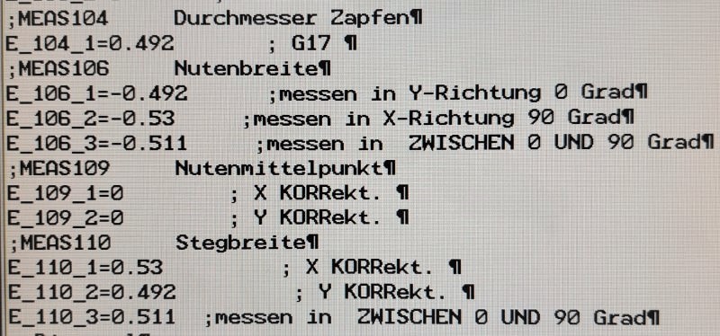

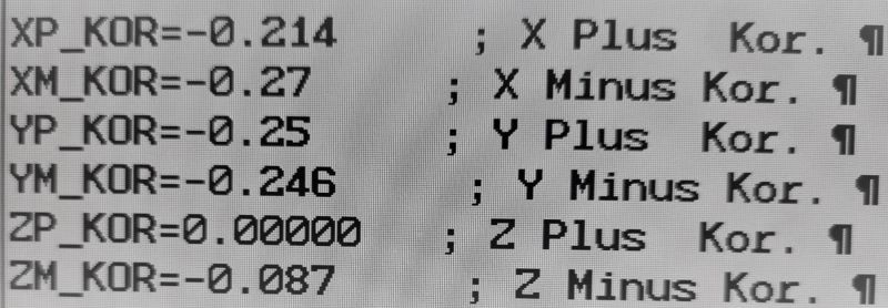

01 Jun 2023 13:38 #272650
by MaHa
Replied by MaHa on topic Touch probe and subroutines for probing
Today i had to recalibrate the 15 years old Renishaw RMP60 probe with 150mm tip. This are the deflection offsets gained for single point touch 4 directions, cylinder diameter, slot inside and web outside. This offsets are used by the specific probing routine.
Just in case there are questions, if probe calibration is useful, and if the orientation affects accuracy.
This calibration results are repeatable, finally our probing is within 0.01-0.02mm , what meets the requirement.
