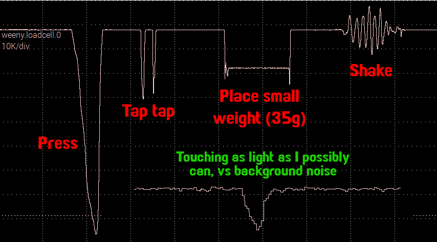

1 year 11 months ago #314119
by iforce2d
Replied by iforce2d on topic Weeny solder bot
This might be better as a new thread, but this one was already made so I'll just tack it onto here...
Over the last year I've occasionally been adding new functionality to this 'weenyPRU'. The PC that was running my large router died so now I'm running it with a Pi4 and one of these units. Looking good so far.
The new features are:
- UART control of TMC2209 stepper drivers (set microsteps and phase current via HAL pins, can adjust at runtime)
- XGZP I2C pressure sensor (150Hz), will be used to sense vacuum pressure in my SMT pick-and-place
- DS3502 I2C digital potentiometer, currently using this to control the VFD of my router
- HX711 load cell amplifier (80Hz), will allow my pick-and-place to probe heights
The poor little F103C8 is now looking very busy, not sure if it can be pushed to do much more than this. Here's a scope of some load cell testing:
