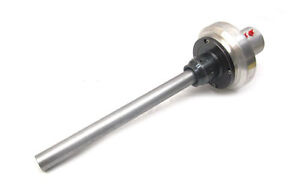

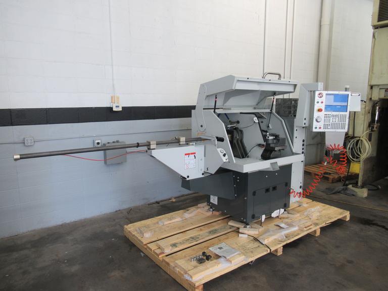

13 Dec 2023 01:32 #287994
by spumco
Replied by spumco on topic KERT mill and Hardinge lathe retrofitted with LinuxCNC
I was mostly kidding.
He's got that oddball Hardinge pneumatic/hydraulic system that uses a rotary union to pressurise a follower plug inside the drawtube. It works, but it's a silly mess and limits you to bars shorter than the spindle. And also makes it a pain to reload.
He doesn't appear to have room for a 3m/12-foot feeder, although there are a number of them close to me dirt cheap.
What he needs is a short-length magazine feeder. Failing that, a pneumatic 36" muzzle-loader like on the Haas CL-1 would be better than nothing. That'd be pretty easy to DIY.
I've got a Hardinge Vari-grip collet closer laying around I could let go cheap, but he'd still need to fabricate the tube, mount, and so forth himself, including an oil trap at the outboard end of the spindle.
