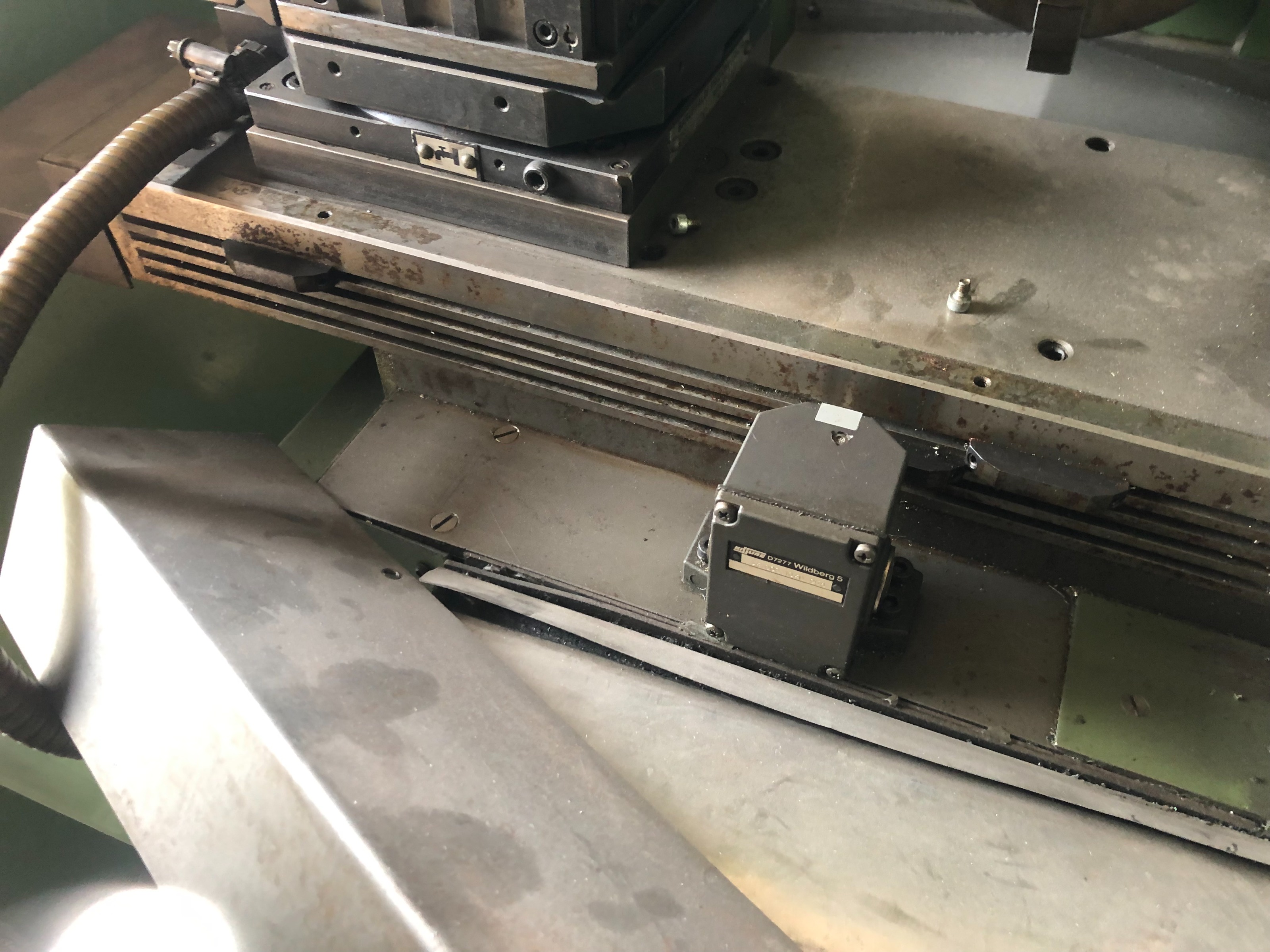

02 Aug 2024 10:08 #306713
by RotarySMP
Replied by RotarySMP on topic Weiler 160 CNC Retrofit
That is nice that they used switches. Schaublin embeded Hall sensors into the bed of the 125-CNC. I hope they dont fail.

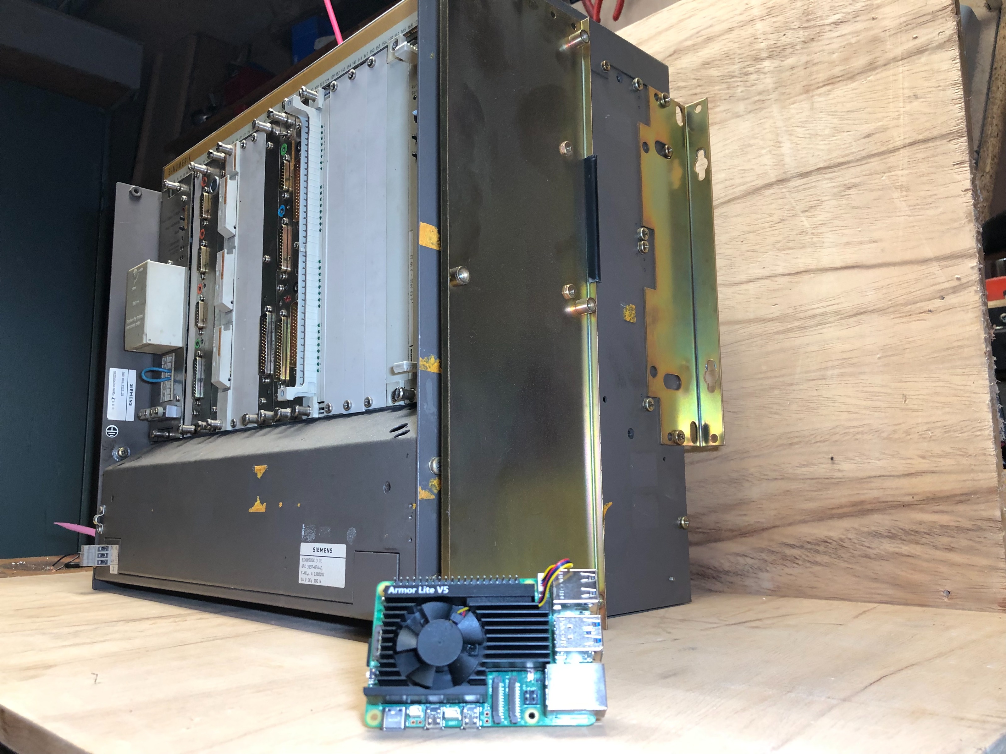

I finally managed to get all the parts & wiring done. Settled with a 7I97T and a 7I84 controlled by a Raspberry Pi.
Crazy to think that the little Pi is probably 10x more powerful than the huge Siemens controller.
I implemented the tool changer via classicladder and it really works like a charm, pretty happy with it.
Now I just have to tune the PIDs for the servos and I can run some test parts. The Fusion360 CAM section for turning looks way simpler than for milling, pretty much just 4 operations, so I think I'll pick this up quickly.

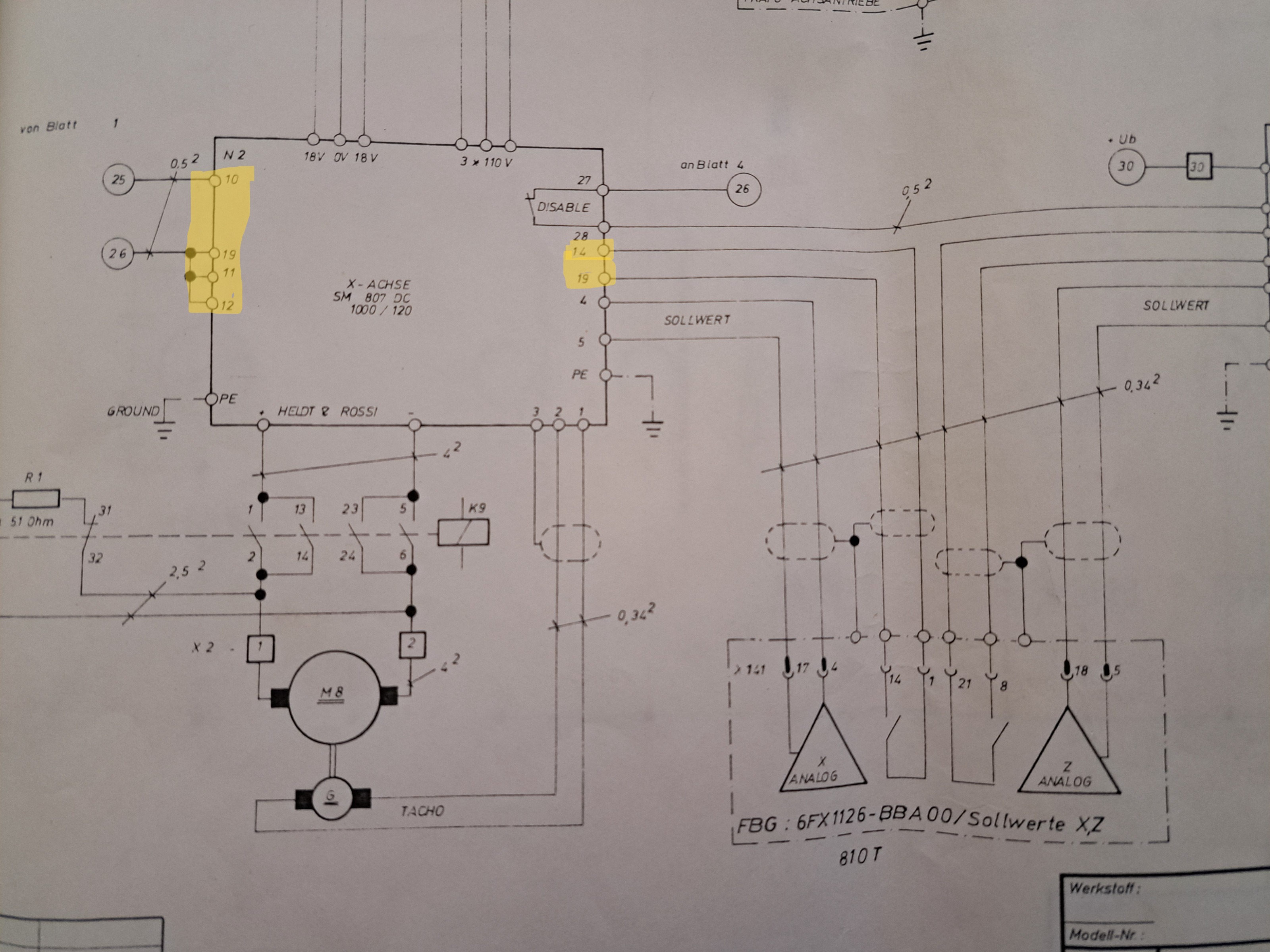

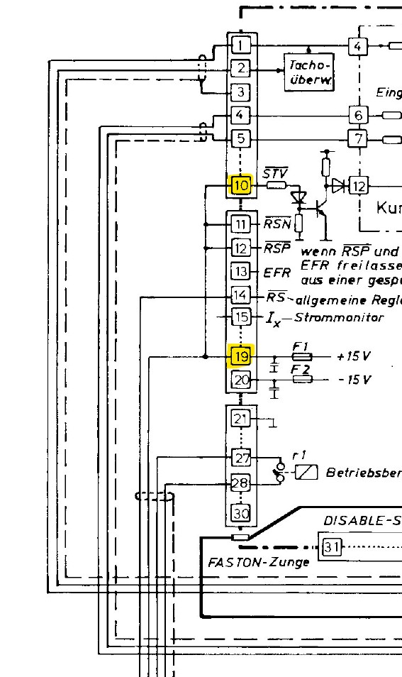

I hope it's ok if i use this Thread for my questions. I've the same machine with same hardware (Turret, Encoder, Heldt&Rossi, Baumüller, Sinumerik etc.) and doing actually the retrofit with 7i97t and 7i84u.
My first question is... I need a enable signal for X and Z on the Heldt&Rossi amplifiers. (see picture)
I would connect PIN 19 to ENA0+ and PIN 10 to ENA0- on the 7i97t. Am I right that this would work?
Marc
Marc
- Thank you received: 4654
07 Apr 2025 16:11 #325872
Replied by andypugh on topic Weiler 160 CNC Retrofit
Is there any indication what /STV stands for? Do you have something that makes you think that's the enable? If it is, then it is shown permananently wired, which seems a little unexpected.
I think you have the polarity right.
I am not clear if that (19) 15V is an output or not, but a multimeter would answer that question.

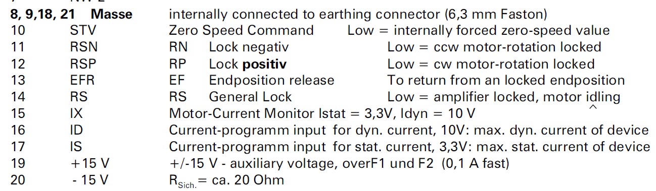

- Marc_P
- Posts: 9
07 Apr 2025 16:55 - 07 Apr 2025 16:58 #325876
by Marc_P
Replied by Marc_P on topic Weiler 160 CNC Retrofit
STV is Zero Speed Command and RS is General Lock. Both signals are necessary for the servos.
But I also just see, my question was false. I want to switch signal 19 over the Mesa and ENA. With the old Sinumerik signal 10 (on both amplifiers) is switched with a safety relay and signal 19 (as far as I can see) is switched separately. The 15V is auxiliary voltage from the amplifier. I've already measured this. Therefore I think I can connect 19 to ENAx+ and 14 to ENAx-.
Marc
Marc
Last edit: 07 Apr 2025 16:58 by Marc_P.
09 Apr 2025 13:40 #325987
Yes, from the diagram, that sounds right.
