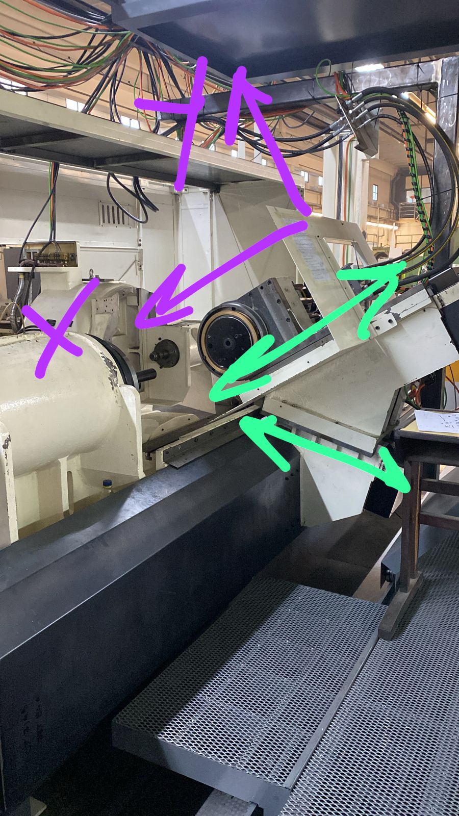

Basically is a custom lathe i built that is has X, X', Z axis with motorized tool where X and X' works together to form a Y axis, this would be kinematics 0.

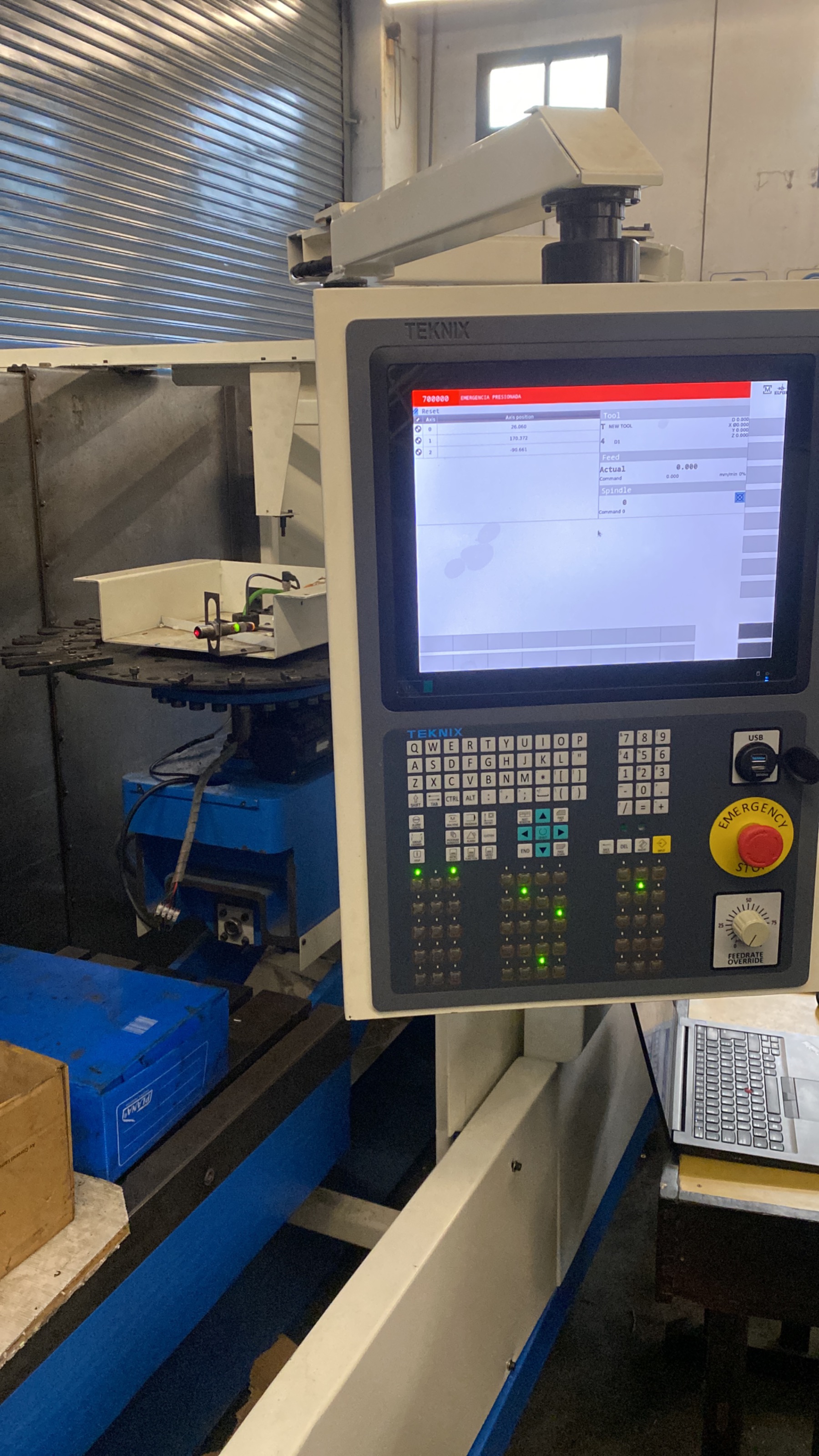

PD: attached a picture of the new panel working (still missing the label strips)

I took a picture of the first kinematics on the file, Y axis is interpolation of X an X’
When second kind is active (Y axis is mapped to C and physical Y is not moved)

A "virtual Y" like most Y-axis lathes I've seen - cool. Thanks for the explanation on the kinematics.
Your panel is spectacular, as is the GUI/HMI.
