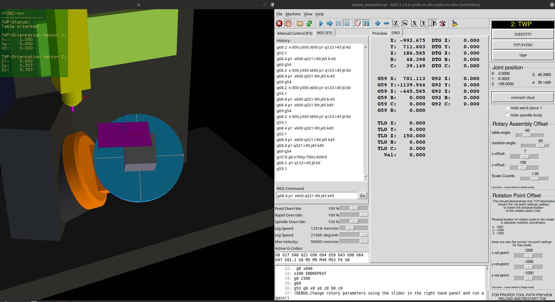

This is from some recent work on table rotation kinematics
Includes:
- Adjustable nutation angle
- Adjustable table offsets x and y
- Adjustable orientation of primary axis (from XYZBC to XYZAC)
- TCP kinematics
- python remap implementing TWP (Tilted work plane) ie G53.n , G68.n , G69 codes
Sim config including the required xyzbc_tnr_kins.comp (use halcompile --install ... ) and full documentation can be found at:
github.com/Sigma1912/LinuxCNC_Demo_Confi...able-nutating-rotary
Includes:
- TCP kinematics

do you have a machine that uses this?
- Posts: 4819
- Thank you received: 2176
17 Feb 2025 19:21 #321858
Replied by Aciera on topic Kinematics for nutating table rotary
I have a small AC rotary but it does not have a nutating joint just a plain old 90° setup.
