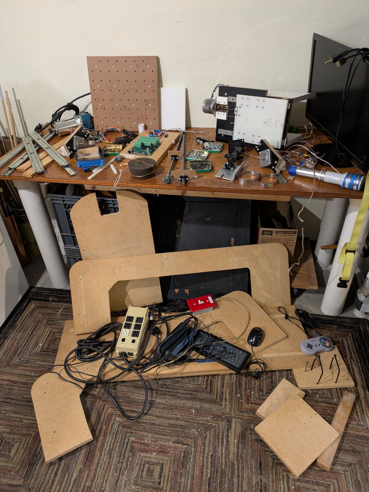

But I had to make space. This only took an hour or so, and it was actually very cathartic.

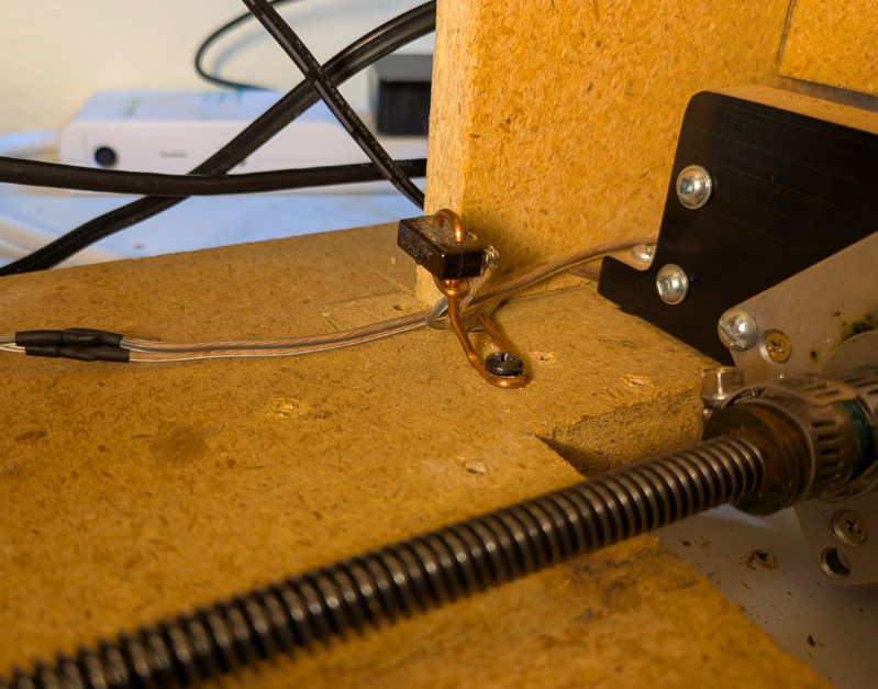

Anyway, I think one of the things I'll miss most about that mill is the limit switches. You've gotta admit, this is cute, right?

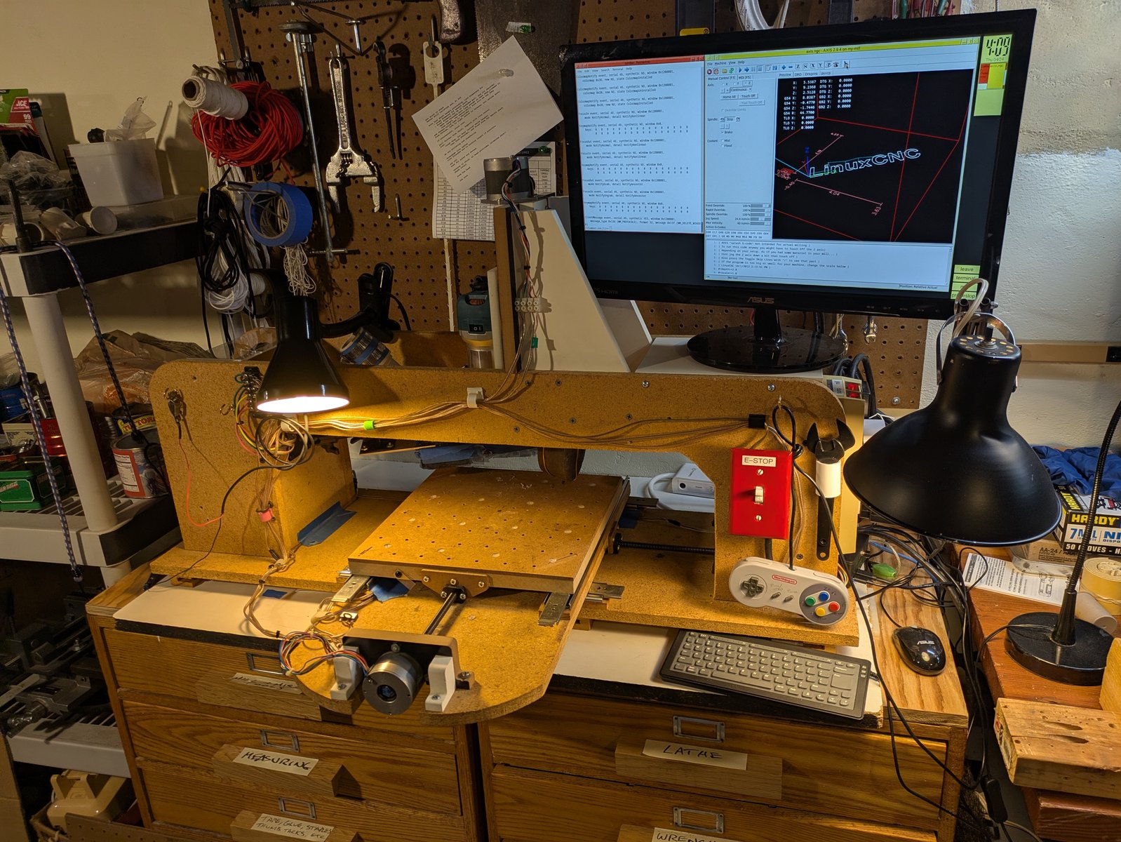

The E-Stop was cool!

I was hoping to use the "emergency off" switch plate from our old oil burner, but I guess I tossed it at some point. So I "had" to paint another one red.
It's a double pole switch. One half turns off the spindle's outlet, the other half triggers an e-stop input on the Mesa.
